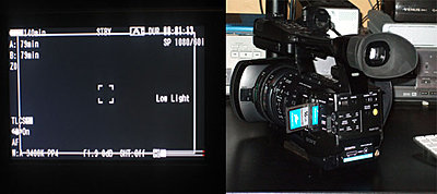

I also wanted to confirm that with the 1.11 firmware upgrade the Lexar 16Gb SSD Express Card works just fine. Again however, it only works well in the 25mb SP mode. I also confirmed through testing with my camera that it will produce a card error after about 5 minutes in any of the HQ modes. The reason that felt compelled to post on this matter is because of the huge $$$ savings. I just picked up two 16GB Lexar cards for $169.00.
I was within one day of purchasing the 32GB Sony SxS card for $1499.00. That is a total savings of more than $1300.00. For anyone who does not need to shoot in the HQ 35mb
setting, I highly encourage you to spend the $100.00 on the upgrade, and save big on the Lexar SSD media. By the way, another nice benefit of the SP mode is that you get a total of 79 minutes of footage on one 16GB card. Nice!

Be careful AL these cards are not Certified ..I would not trust a paying job on them. Also the write speed is slower on the 16gb cards. I am only using them for backup only.

It's interesting you can even record video on these cards in the first place.
Did you read users' feedback on Amazon and Newegg about these Lexar 16Gb cards? Consensus seems to be that they are very slow even for the normal file transfer operations.

Hi Al, as long as Lexar 16gig works ALL the time when record on SP mode i would live with that. How many times did you record using Lexar 16gig and fill up the card ?
If it works ALL the time using SP mode that would be great but if it works 95% of the time that would be unacceptable.

Hi Brian, I've got to say that it was you who got me on this Lexar kick to begin with. So thanks for that. Your lead has saved me a great deal of money this week. I know they are not certified, but they work. So far, I have only shot 60 minutes on one card. I do have several paying events next weekend, and I do intend to use these cards the entire time, or
until I get a error message at which point I will switch back to my 8GB Sony cards. I was just saying that so far these cards are working well for me and at 169.00 for 32GBs of Express card storage, I'm willing to take the chance. Yes, I second camera will always be running, but as soon as I fill up 79 minutes with no problems, I will be ordering two more of these cards.
I'll be certain to keep you all up to date on the outcome either way. Thanks.
