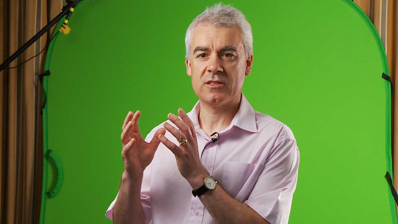

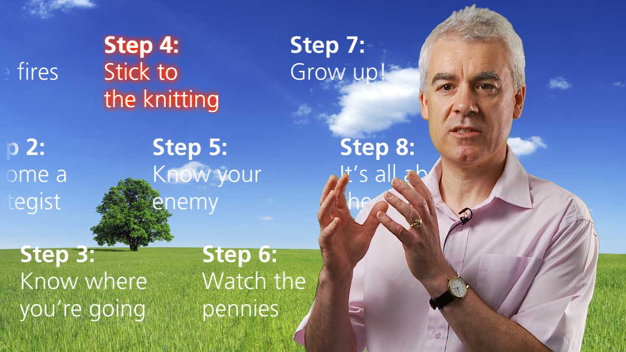

Originally Posted by Oyvind Stokkan View Post
I'm wondering if any of you have tried keying the EX1 footage?
First off, check out the new DVmatte Pro 2.0 from Pixel Corps/DVgarage. It's GPU accellerated, and much improved from 1.0. It blows the doors off Zmatte and the rest.
Originally Posted by Noah Kadner View Post
Sure it's solid- as with any camera good lighting is critical.
Ahem, well, DVmatte Pro is kind because I'm not the best DoP in the world, and have got away with a single Tota with brolly for bgd (blush, long story) in a recent shoot: before and after below. Note the pretty alarming fall off in illumination in background! The key took a minute or two to set up, then copy/pasted to all clips. Bit of cleaning here and there, bit of garbage matte editing, but not exactly roto. Final will be 640x360, so Sin City it AIN'T.
PS: tip for future: if presenter is wearing watch, at least pull the winder knob out so the dial doesn't jump around when you're editing.
