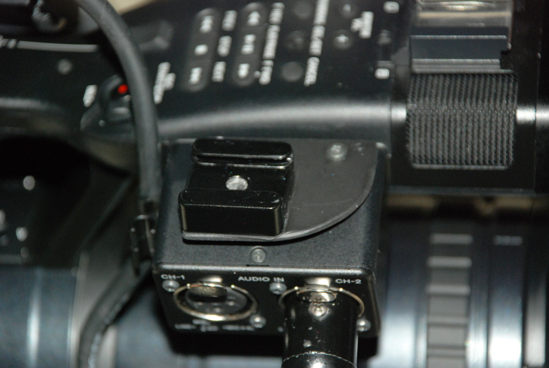

Jeff,
Nice job - but you're exactly one week too late for me and my EX3! I would definitely have purchased yours. I had aluminum in stock, spent $15 for the shoe and shipping, and two hours cutting, grinding, and drilling!
One question - are there registry holes in the base for the nipples from the audio pod? I drilled additional holes for these as I did not want to damage the camera by cutting/breaking them off.

1) Sorry, no mechanical stop, but I can consider adding it to this design if there's demand for it. That question really hasn't come up with my previous products.
2) yes.
Originally Posted by Ted OMalley View Post
Jeff,
Thanks, and sorry about that. I had the parts ready before, but no way to get photos sooner.
There will be, not on the first batch except maybe I would customize one by special request for someone that needs it ASAP. Bob pointed out the nubs to me last week when he had access to an EX3. That's why I said it wasn't EX3 compatible yet. I plan to make EX3 compatible mounts, it may be a few weeks.

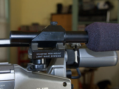

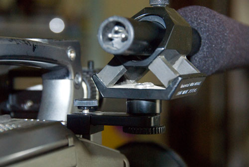

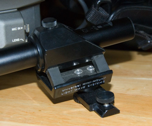

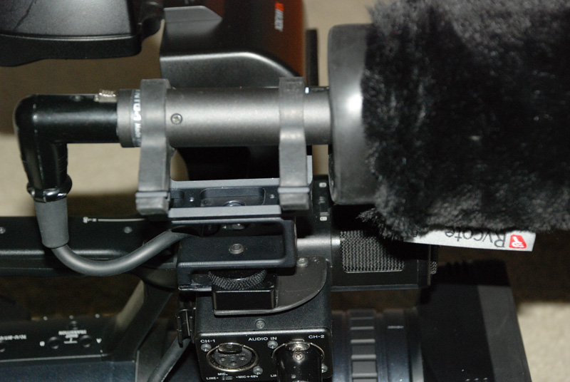

I just found this discussion and thought I would chime in. I made a mic mount for my DV-500 back in 2001 (I think, maybe it's been longer). I purchased a Light Wave Systems MiniMount Universal and made a detachable arm that fit the holes for their mic mount. The bracket is small, simple (although it did require a bit of work) and lightweight. I made and sold more then a few of these. At the time I had access to a machine shop so it was easy. I just got an EX1 so I will modify this mount to work on the Sony. The best thing is that it detaches with 1-2 turns of the screw, you don't have to tighten beyond finger tight, to put the camera in the case. I do like the simplicity of Bob Grant's bracket! I may fashion one like that for future cameras (EX1/3).
Cheers
Robert C. Fisher
Mic Suspension Mount - What Are You Using?-side.jpg   Mic Suspension Mount - What Are You Using?-back.jpg

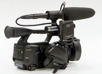

I use the J-RODE
SEE ATTACHMENT
http://www.thej-rod.com/

Old September 8th, 2008, 12:32 AM   #67
Join Date: Jul 2008
Posts: 55
Brian the problem with any mount that uses the origional mic holder is that it has the same issues. The Sony mic mount is really flimsy. I used my EX1 for a few days before I sent it in for a backfocus issue and firmware update and this has to be the worst mic mount I have seen on a camera of this caliber. This is the reason most people replace it, as well as using a mount with more phsical isolation to reduce the handling noise.
Cheers
Robert C. Fisher

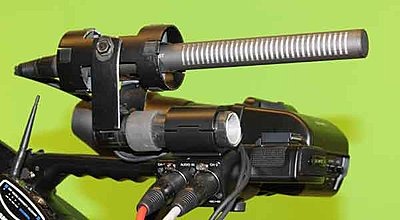

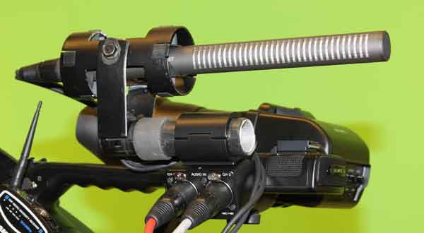

My mic rig
Comming from magnesium case camera like the Sony DXC-series, the EX3 made a lot of noise from handling the plastic case. Tried several solutions, but at the end made my own. A thin alu-tube with rubber bands from a bicycle tire(working best). Rubber bands to mont the mic, rubber in every joint, rubber covering the tube thar fits into EX3. Even works with a microphones like Audio Tech 835 st.
Arild Pedersen is offline   Reply With Quote

Hmmm...
I have a feeling that this will still suffer from the same strength issues due to the use of the supplied Sony mount. Let us know how you get on with it.
Jus.

Old October 5th, 2008, 01:16 PM   #75
Location: Elverum Norway
Posts: 62
My rig
No problems, so far. When using mics like the Sony ECM 678, which is quite heavy, a move the rig a bit backwards to balance it.
And, I always remove the rig in the bag.
