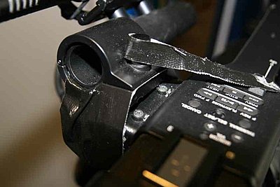

Yep,
Started weakening the plastic after several weeks then broke it just getting it out of the the bag.
Got a very good and cheap mic holder now.
BLACK GAFFER TAPE, luxury model, with the 2nd piece of tape across to the strap anchor, gives it a very good support!
Bob, if you have a spare clip you want to sell me, please let me know.
Cheers Vaughan
