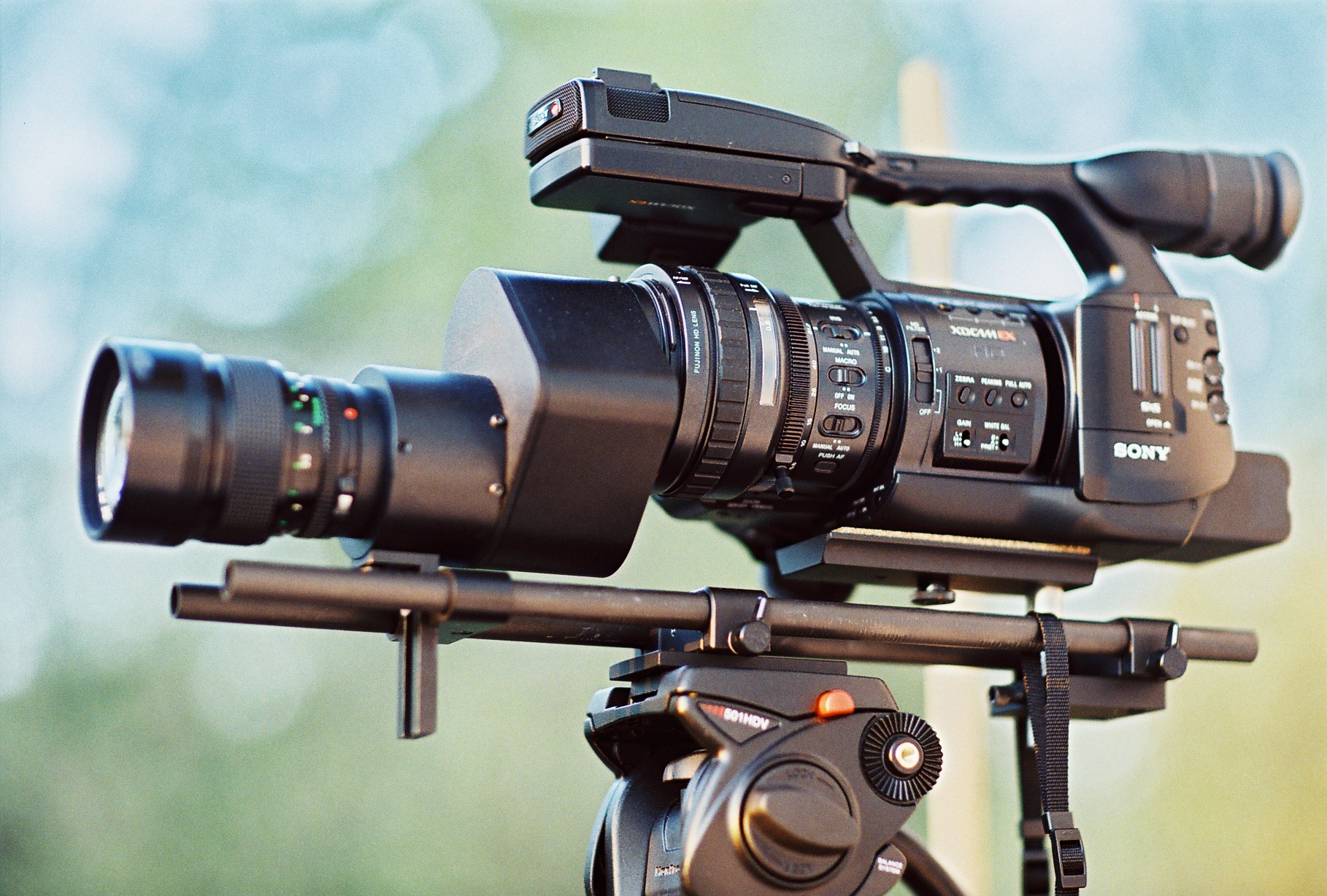

Posts: 317
Heres some EX1 film look :) Shot with Canon F-1, 85mm f1.2 L lens on Fuji 400 asa film
