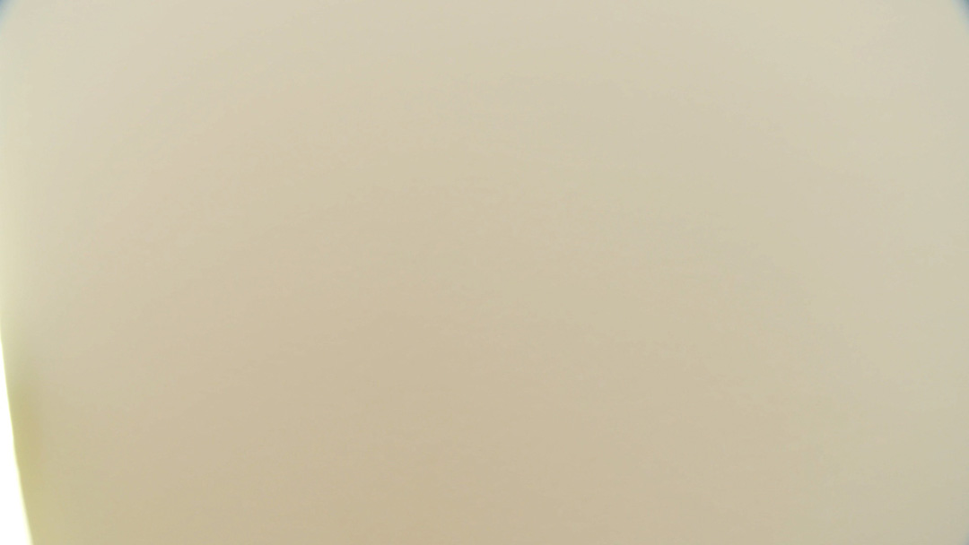

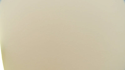

Tom,
Thanks for clearing that up. Looking at my other cameras you are correct about the absence of a macro mode. So this just leaves the issue of vignetting.
Doug Park is offline   Reply With Quote
Old May 1st, 2008, 10:01 AM   #47
Join Date: Mar 2003
Posts: 4,711
And that's quite an issue. You've not got any filters between the CO and your Fuji, have you? No step-up rings involved here? Vignettes with Steadyshot on or off?
Old May 1st, 2008, 10:27 AM   #48
Join Date: Jul 2005
Posts: 23
Tom,
I have no other filters attached to the camera and no step-up rings. And the vignetting occurs regardless of the Steadyshot bring turned on or off.

Originally Posted by Doug Park View Post
Tom,
Doug,
Please post images of your vignette or email them to me. We have shipped hundreds of .6x attachments with no complaints including use on major feature films. If you wish, we can look at your lens for you but images would be faster to assess the problem to begin.
Ryan Avery
Schnieder Optics
Ryan Avery is offline   Reply With Quote

Originally Posted by Ryan Avery View Post
Doug,
Ryan Avery
Schnieder Optics
Ryan,
Here is a still from the camera with the .6x lens attached. The camera is at full wide (5.6mm). Thanks.
Ryan,
Sometimes we experience vignetting in underscan but doesn't show in the final output to tape or webcast. Your issue seems a whole lot like CCD placement issues that we often expereince only from Sony (no knock on Sony intended, just facts).
Please bear with us as we formulate a solution to the unique challenges presented by this particular camera. We have never seen this much inconsistency from one model to the next in CCD placement. We will verify these issues and have an official solution in the coming weeks.
Ryan Avery
Schneider Optics
