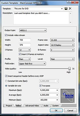

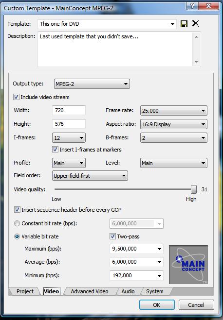

Old March 8th, 2008, 09:01 AM   #45
Join Date: Nov 2007
Location: Bristol UK
Posts: 1,273
Craig,i've panned left to right,up and down,slow and fast,past walls,windows and trailers with mesh sides,i ain't getting any twitter or lines or anything,just smoothflowing footage. I've purposely tried to find twitter etc but can only find it if i render wrong. I render main concept mpeg-2 for dvd-a,upper field first,the same is for 720/50p and 1080/50i.
Paul.
