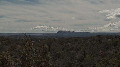

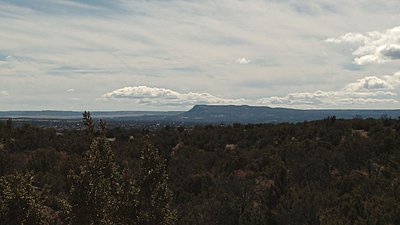

Here's some shots with a matrix setting I'm experimenting with. It uses CINEMA instead of HISAT. I really wish I could find a camera setting that required NO grading. Even small CCing takes a lot longer to render out ;o(

Randy...
Seems like you know better than you think you know ;o)
Quote: Originally Posted by Michael H. Stevens
"I agree with Randy that maybe the CINEs could be pushed more"
Which brings me to the point I was making earlier, altho' I guess I said it rather poorly because everyone misunderstood me...
Using the CINEGAMMA setings, if I open the iris more, to balance the histogram more to the right, I end up overexposing the whole scene, washing it out and blowing the hi-lites very easily. The cinegamma settings really balance the whole image luma range to the left and it takes a LOT of "S" curve to bring it out. So much that the entire image suffers from banding and more noise.

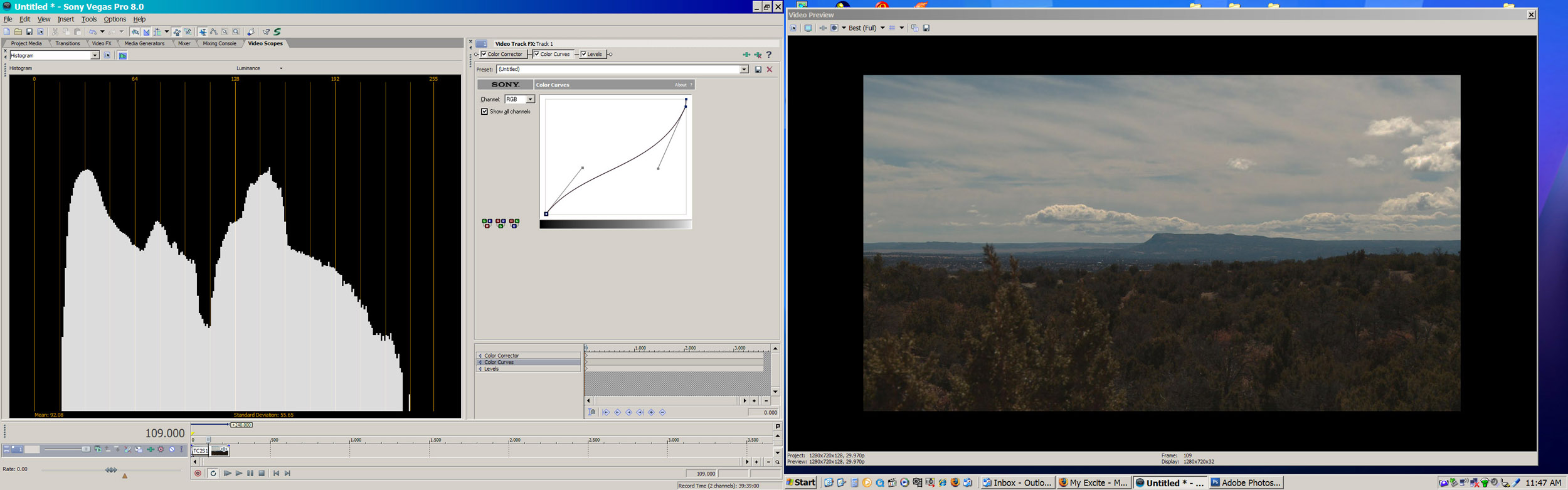

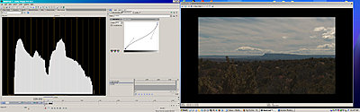

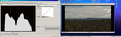

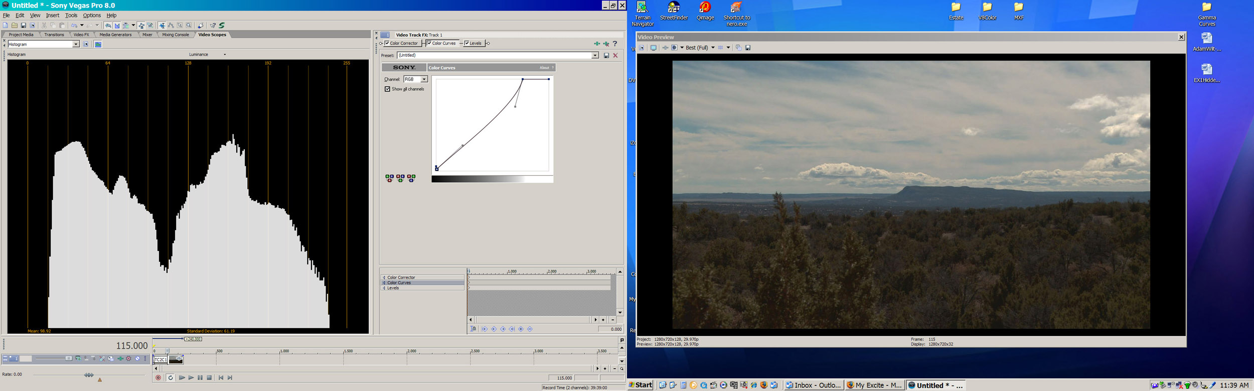

Here's what Michael asked for.
Post-processed images for TC2S1 and TC2C1. Not as dramatic as I wished but, nevertheless..
Note that :
1-TC2C1 needed more highlite correction, histogram is slightly more combed. More sky, less foreground detail
2-TC2S1 needs less endpoint correction, esp. on the hilights but an inverted "s" gamma correction to get it looking good to my eye. More foreground detail, less sky.
