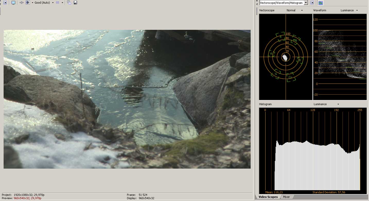

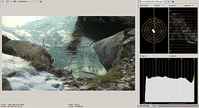

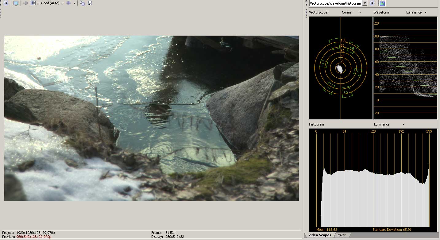

This is a very interesting topic here and something Ive been wondering how this stuff works. I dont understand much of it but I will show some examples here and ask questions if someone cares to elaborate.
So when I put mfx files to an 8bit timeline they look fine to me and as I expect them to be. When I change the project to 32bit whites get clipped and blacks get crushed. Totally opposite of what Randy sees.
When I apply studio to computer rgb to 8 bit whites get clipped and blacks get crushed as well.
So in 32 bit mode I have to do a computer to studio rgb conversion and the image looks right again.
So is this how you should do it? If you want to work in 32bit you have to apply the computer to studio rgb?
When the images look right you can see in the waveform monitor that
8bit goes up to 100% and 32 bit (with comp to studio rgb applied) goes to about 110%. What does this mean as the image looks the same in both modes?
Sami
