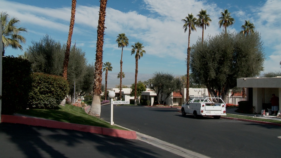

I'm finding this issue a little difficult to describe so let me first give the facts of the shoot. It was a very bright high contrast scene. Bright white clouds, white cars, black tarmac, shadows in door way and close-up bushes in full shadow. I exposed about half a stop below clipping so have full detail in the clouds. I get same result as described here for all CINE gammas in default settings and in all sorts of scenes.
As shot the darkest part, the bushes show minimal detail as you would expect and I'm trying to bring out a little of this detail with the Color Curves but here is the problem. The strong blacks cut-off sharply just like they clipped. IE the left side of the histogram has a very high value at 0 (zero luminance) and the drops to nothing. The Waveform monitor has a thick line running all along the 0 bar. Trying to drop the end by the lowest blacks even with very fine adjustment seems to drop all the blacks, not just the very bottom, and produces a lot of noise.
What is happening here and why is the EX1 histogram in bright contrasty scene not like a bell curve that tapers at both ends but like a rectangle where blacks (and to some extent white) drop off like the side of a cliff? With HDV I never saw anything like this as I always had gradual drop-off at each end of the luminance scale. I'm really confused as to just what the camera is recording and to how Vegas seems it.
COULD this be due to under-exposing. The picture quality unprocessed is superb, I just want to soften contrast to be more film like.

There are a lot of pixels in the black region of the image and that is what the histogram shows; namely how many pixels are at each brightness. The camera histogram puts black a bit to the right of the apparent zero and in an underexposed image you get that cliff at the black end because that's where all the pixels are. If you over expose it becomes a gradual decline because there aren't many pixels that are dark.
In Photoshop your posted image gives the usual histogram I'd expect (there are a lot of blacks present and no cut-off -- apart from a number down at 0) and the amount of detail in the dark hedge is quite surprising (considering the brightness range in the subject). You can bring it up with levels, but that doesn't help the rest of the image. I would use masking to bring up only the hedge using levels, but noise will be a problem with such an underexposed area.
Looks pretty good, to me.

What did the left side of the EX1 histogram look like when shooting? Was it registering any "0" pixels. How were you guaging white clipping? If zebras, at what setting?
This grab looks very saturated for stock settings. Was that something you did in post? If so, could you post an unaltered out of camera shot?

NO POST - .mxf straight from camera. Frame grab from Vegas 8 32-bit time-line.
Matrix was set to HiSAT. Otherwise straight CINE4 with black master -3 and black gamma -2. 1080x 24p
The EX1 histogram was NOT vertical immediate cut-off like I saw in Vegas.
Zebra set at 95 with zebras just gone. That's why I say it is a little underexposed.
Michael H. Stevens is offline   Reply With Quote

Yes, the under exposure is clear in the Photoshop histogram. Working to the 109% limit offers better dynamic range. Or, if you like, less noise in darks. Apply "levels" in post.
