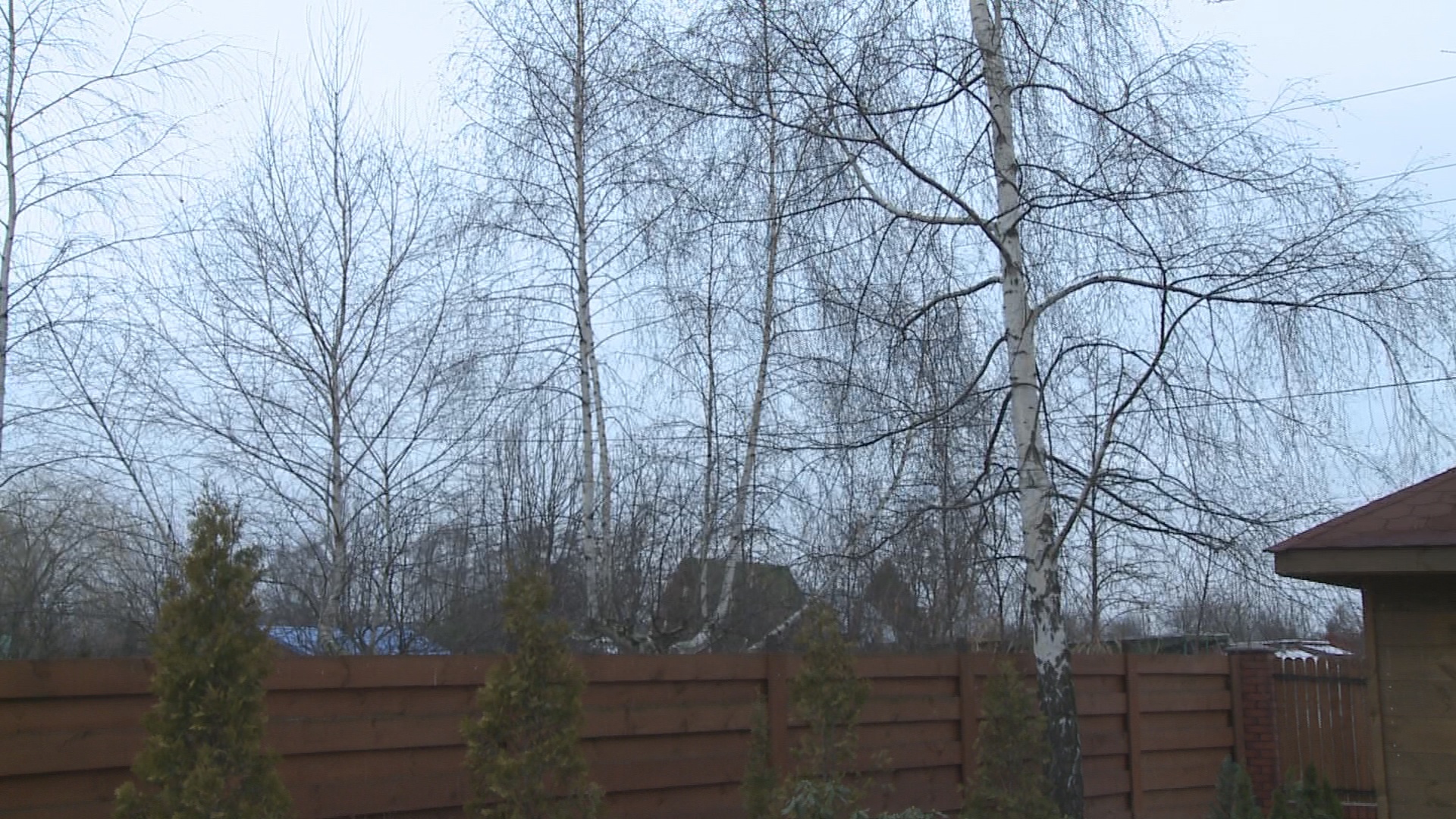

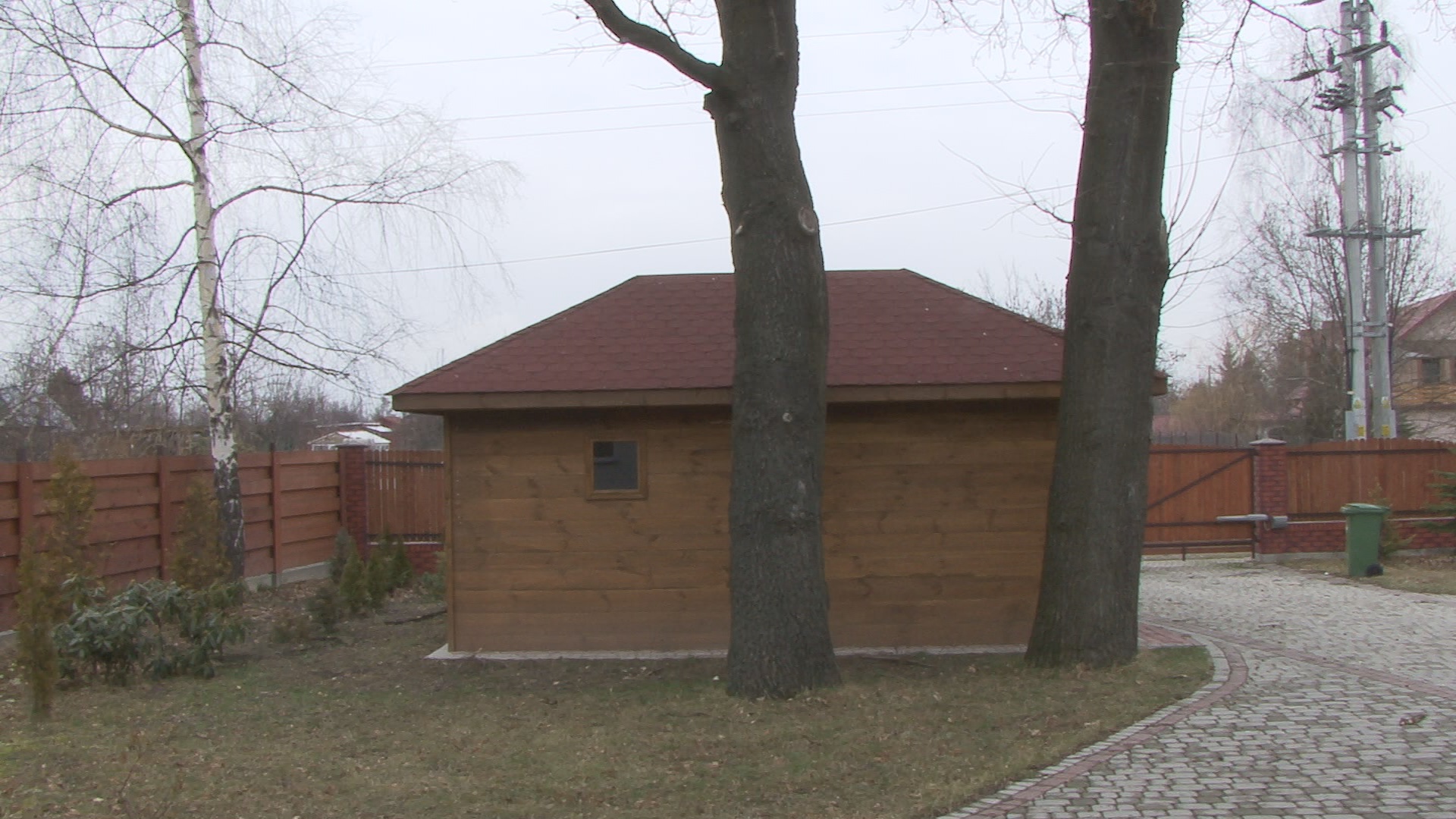

Anyway, here is the link to the short clip from which my last two grabs were taken (no PP, STD3 gamma, out-of-the-box settings); it shows how the artefact changes with iris opening/closing (original m2t, even with my Polsih comments in it; the format is SP 1080/50i as I was testing my DR60 drive - BTW, works fine with the EX1's i.LINK):
http://rapidshare.com/files/89637385...SP_108050i.m2t
As most of you don't understand my Polish commentary: at the clip end the iris is at F8, and only then the effect vanishes (but the rest of image is severely underexposed). Also, I deliberately put the trees slightly off focus, as it seems to magnify the artefacting.
Again, please somebody confirm it's not just my unit! TIA.

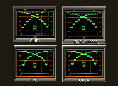

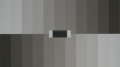

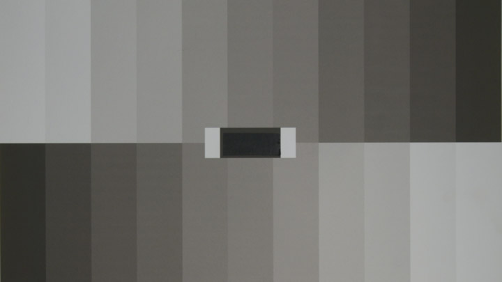

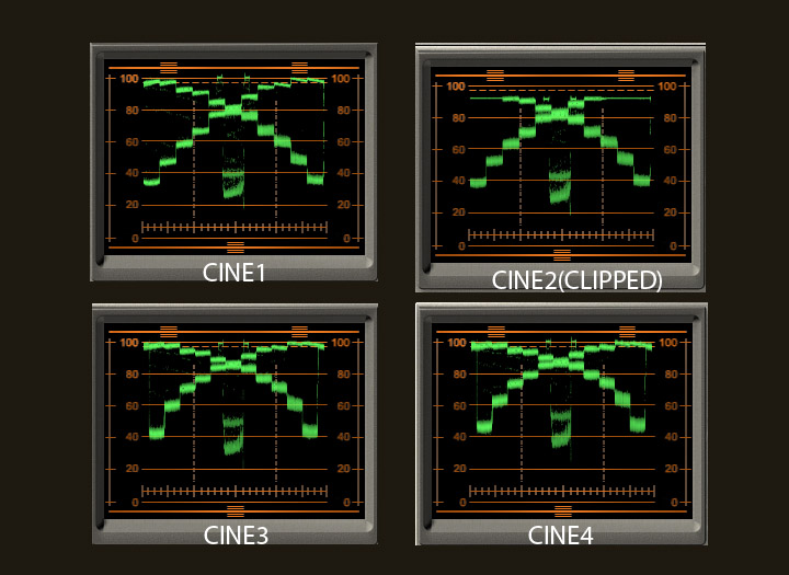

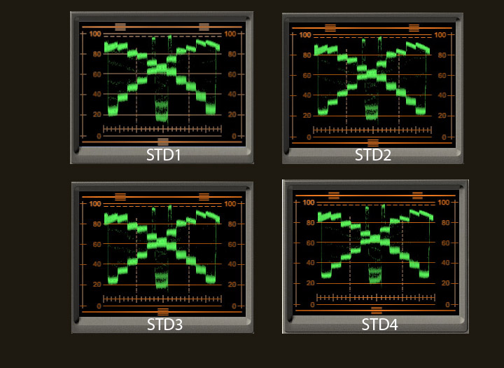

WFM Readouts for Gamma Presets-Sony EX1
Here's some links to the results of the 8 EX1 gamma preset readings I observed on an HDRack Waveform Monitor. In all cases, I used the factory presets with only the GAMMA preset changed. Everything else was at the factory setting.
Here are the caveats...PLEASE be sure you understand them before you make judgements about the results!!
1-Factory settings except for Gamma preset selection. Auto knee ON in STD mode, disabled in Cine mode.
2-Homemade 11-step gray chart--NO guarantees that the super black and super white are at 0 and 100 IRE
3-Scene illuminated by single 600w halogen lamp, minor skews in WFM due to uneven illumination.
4-White balance set to 2700K
5-Exposure normalized for each plot such that the white point always falls on 100 IRE (except for CINE2, see note 6)
6-CINE2 plot intentionally (over-exposed) clipped. Cine2 gamma clips, by Sony design, at 92IRE. This also accounts for the similarities in the middle gray point amongst the STD gammas.
7-I include a jpeg of the step chart for reference. Don't EVEN begin to think you can make some reasonable judgements from this jpeg. There are so many errors due to color profiles, that you'll send yourself down the proverbial garden path. Suffice it to say that the steps are evenly divided and symmetrical.
I see absolutely no evidence of premature clipping, weird effects, with the exception of Cine2, which is specialized, by design. I am putting some faith in whatever algorithm Sony uses to control the auto knee in the std modes. It's conceivable that this circuit can be fooled under some lighting conditions.
Non-normalized Cine Curves http://www.dvinfo.net/gallery/showimage.php?i=851&c=2
Non-normalized STD Curves http://www.dvinfo.net/gallery/showimage.php?i=853&c=2
abrupt highlights clipping-stepchart.jpg   abrupt highlights clipping-stdcurves.jpg

Bill,
I'm confused about by your results because the cross over point is so high. Maybe its the "homemade grey chart"
Just looking at how your chart reproduces on my monitor it looks like there is nothing like a 90% white like you would see on a piece of white paper.
Is that true. Without it its a little hard for em to evaluate because I'm used to looking at a standard chart.
I've added 2 - 90% chips on the old standard chart I own anyway. It really helps understand where the crossover (gamma point) is and what your knees are doing relative to the rest of the scale.
Maybe its just the way I'm seeing your chart on my monitor though, or maybe you intentionally overexposed all the charts to show the knee and clipping?

I certainly hope so; nevertheless would appreciate somebody confirming it is not JUST my unit...
We cannot answer that until you post an example that is correctly exposed. How do we know by what amount your exposure is out to be able to exactly duplicate? YOU MUST DO THIS TEST AGAIN USING THE CAMERA PROPERLY AND THEN POST THE PICTURES IMO.
C'mon Michael - what do you mean "properly"? I've posted here the grabs of my camera malfunctioning, even though handled as usual (the WB and focus not being perfect didn't influence the issue I'm trying to show, the various exposure leveles HAVE been shown).

Gotta agree with Piotr there was nothing wrong with his exposures. Yes the sky was overexposed but it often is on a daylight shot depending on your main subject matter.
If the sky was under 100% we wouldn't be having this conversation.

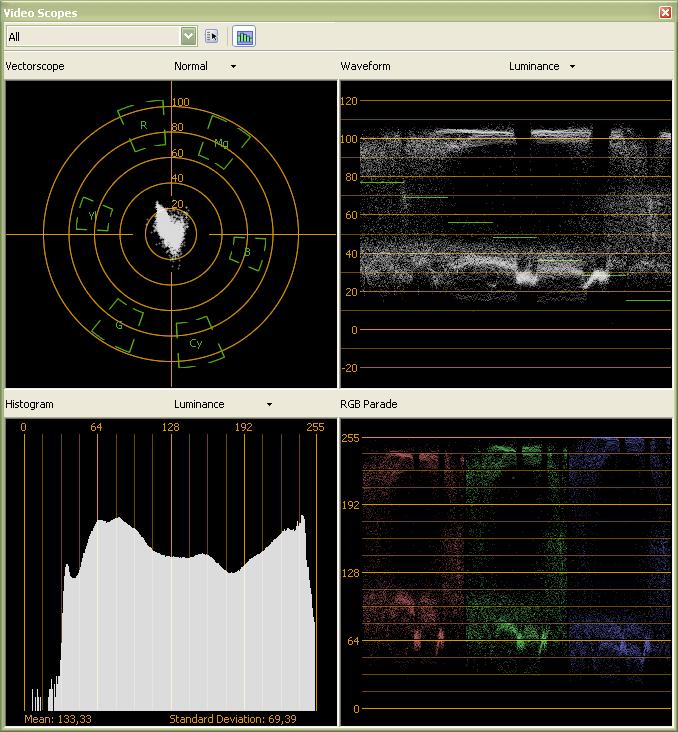

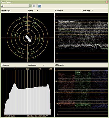

Piotr:

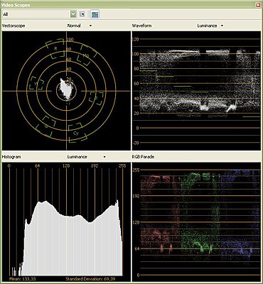

Maybe we could see just how you exposed if you posted a frame grab of the vector-scope in your NLE. Then we can see what's illegal and what clipped. Please do this as this thread is getting you nowhere. Many experienced camera men here have contrary opinions mainly due to the lack of information you are giving us. We need more real information from you - we need see your scopes. IMO.
Michael H. Stevens is offline   Reply With Quote
Old February 6th, 2008, 06:47 PM   #90
Location: Poland
Posts: 4,086
Originally Posted by Michael H. Stevens View Post
Piotr:
Here you go Michael; the upper two is an EX1 grab along with its scopes; the bottom - similar scene with the V1E (standard gamma curve, as well). None of the images are perfect (fa from it), but the point is the "shadow" behind the trees only visible with the EX1 and not with the V1E.
abrupt highlights clipping-vegas-scopes.jpg   abrupt highlights clipping-image51.jpg
abrupt highlights clipping-v1e-scopes.jpg   abrupt highlights clipping-image52.jpg
