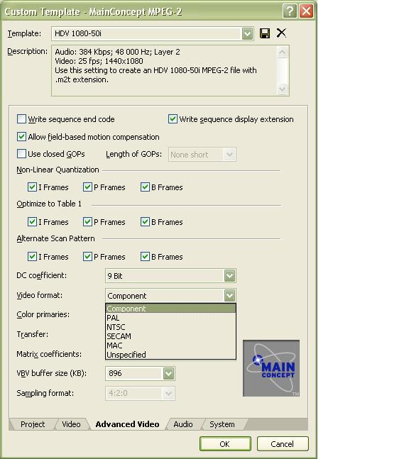

what's important is my final render. But in the "Advanced video" tab of any "Render as..." template, one can choose the "Video format" to be either NTSC (the Vegas default), PAL, or Component. Now, this can dramatically change the look of my final renders!
I'm not seeing that on my end.
What are the steps you are taking?
What codec?
What program are you using to view those files?

Here is the grab with the setting I mean; if I choose anything other than PAL or Component, the colours of my HDV final renders are less saturated, and the dynamic range narrower, than with the source HDV clips as played in any MPEG-2 software palyer - including WMP or Nero Showtime.
Also, I had to create my own Blu-Ray templates, as those supplied with Vegas all had NTSC as the video format (even the 1440x1080/50i or 1920x1080/50i ones).
This is one of the things that show Vegas has been developed with mainly the NTSC users in mind.

I'm not seeing that on my system- renders between NTSC and component look the same.
My 50i templates show component or unspecified.
Glenn Chan is offline   Reply With Quote

Am I hallucinating? Bob, your're PAL - could you please render a few secs of an mxf into 1920x1080/25p in two versions: PAL and NTSC as video format (as per my post above), and compare the resulting colours with those of the input clip? TIA!
