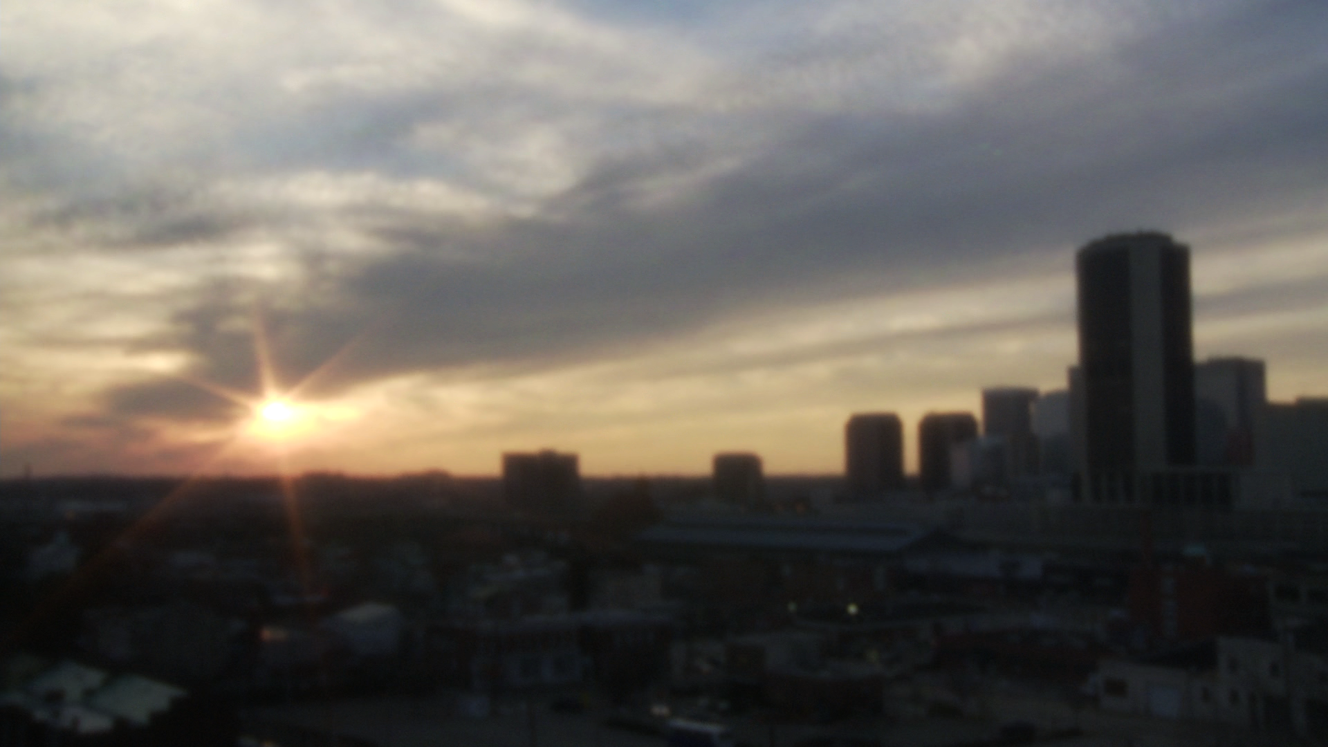

Here's a test I shot tonight--my first timelapse with the EX1.
I started with the sun up, and my plan was to ride the iris. I didn't want to use the ND, and so when first recording put the iris between 16 and closed--the result, frame attached, was badly blurred. I assume this is the result of having the iris too close to closed? Focus was full MF at infinity.
Once opened up to a proper 16, all came in focus. I regret trying to ride the iris--you'll notice jumps in exposure on the first clip. Maybe with a remote lens controller this could work?
Both clips recorded at 1080/30, interval 1 fps, but I sped up the first by 900% in post, otherwise untouched. The first clip was SLS at 8, the second EX slow shutter at 16. This shows that to get the streaking of headlights 16 is preferred. No PP was used and gain was -3.

Also, the softness looks like it's out of focus. It doesn't have the quality of diffraction softening to my eye.
Is there anything that could have gone wrong with the focus?

Not that I can think of--you're speaking of the frame grab I assume, not the clip. Focus was locked on infinity. I don't know what diffraction softening is.
Do you know what I'm talking about, stopping down between 16 and closed? My guess is the aperture was too small, not letting enough light in to focus...of course that's the opposite of how it's supposed to work with aperture and focus.
I could very well be wrong, but the focus ring itself didn't move. Here's the whole clip. Again, I only touched iris ring--and accidentally zoomed out a tad once.
