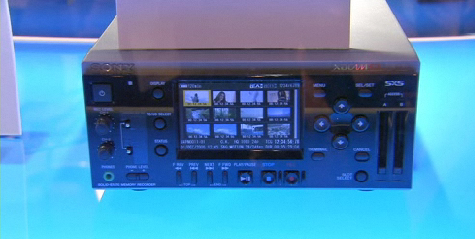

Location: London & Los Angeles
Posts: 11
EX Deck?
In the thread about the Sony wide angle adaptor, Paul Joy posted a link to a Sky news video about the recent Broadcast show in London (you can see Philip Bloom in the background demo-ing the EX1) -http://www.schneideroptics.com/century/dv/ex/ex.htm
If you stop the clip at the 01:12 mark, you see a picture of what looks like a new EX deck of some sort. I post the screen grab here. Anyone have any news about this device? Is it simply a playback machine? There is clearly a record button - could it be an archive machine with a built in hard drive - not unlike the P2 store that Panny make? What do you think....?
Forgive me if someone has already posted about this and I missed it.
Edit: My bad - someone has already discussed this a while back. Apologies.http://www.dvinfo.net/conf/showthread.php?t=106583
