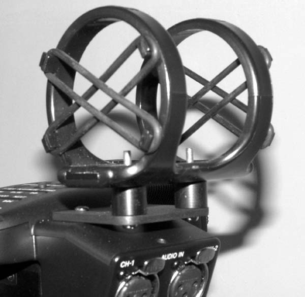

I've started making my own piece of metalwork to hold the Rode shockmount directly, I'll post a picture or two when I'm done. When I took the original Sony mic holder off the EX1 to measure the hole spacing I noticed this unit is only just held onto the camera by very thin plastic sections where the screws go though it into the audio pod. This is likely a deliberate and sensible piece of design on Sony's part. If the mic does get a hard knock the holder breaks away from the camera rather than cause more expensive to repair damage to the rest of the camera.
On the other hand mounting the full Rode shockmount into the existing mic holder plus a heavy, long shotgun and dead cat could be placing too much load on the mount and cause it to break away when it needn't.
Regardless of which view you take of the design I'd suggest anyone planning on mounting anything more than one of the Sony plastic shotguns to have a good look at just how strong the mounting clamp is, especially how it attaches to the camera.

My EX1 Mic Mount
I fashioned the mount to attach a Rode shock mount directly to the EX1 audio pod from a length of 40mm x 3mm Aluminium bar. 2mm material would be equally suitable. The two spacers are from the original Rode mount.

mine snapped off about three weeks ago and am awaiting a replacement. you are right. it is very flimsy for a reason, doesn't stop it from being very annoying as it is easy to break.
Hello, you are crazy, but this is a good idea for use high end microphones without a "Ton Meister".
I hope, in future you don't have problems with waranty etc.

Hi Bob,
Nice solution !
I wish I would have seen your thread and posted earlier--check out The J-Rod also which will allow a shock mount and a radio receiver to both be mounted on the EX !
I don't think you would have any issues with covered repairs with your mount on. May be just as easy to switch it back though prior to bringing it to Sony if necessary.

Originally Posted by Jeff Rhode View Post
Hi Bob,
Nice solution !
Regards.
I'll bet good money the J-Rod will break the EX1's mic holder, the mic holder can barely hold the weight of a Rode shotgun without breaking. We've had two mic holders on Z1s break and the Z1 has a more robust holder than the EX1. Don't get me wrong, I'm not having a go at the J-Rod. It's not the designers fault that the mic holder is so flimsy.
For wireless receivers we'll be hanging them off the back of Zacuto rigs or else off the existing cold shoe.
Anyway thanks for reminding me about my mic holder, I've got a few more EX1s that need me to make my custom job for them, just not enough hours in the day.
