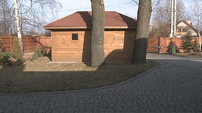

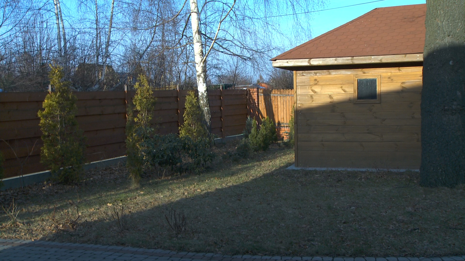

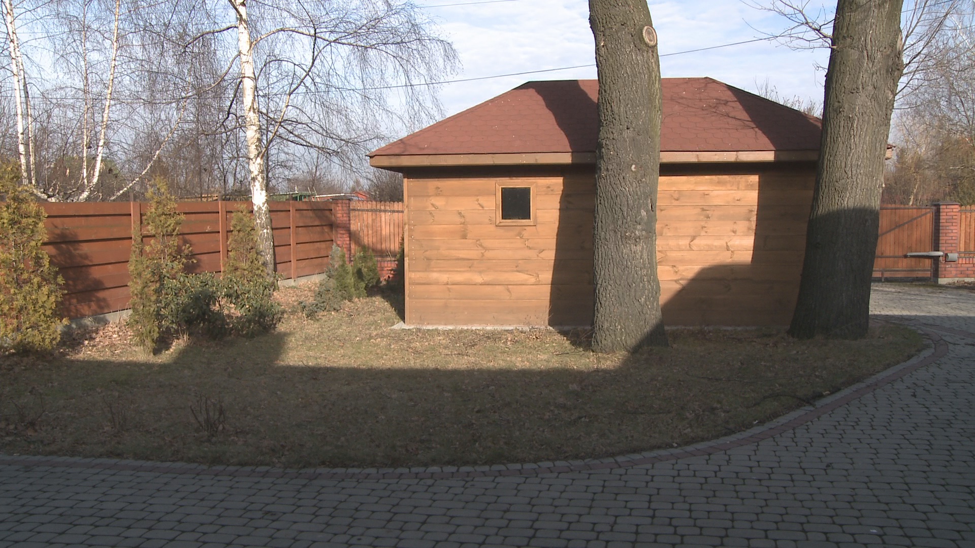

As a memento for those disappointed with the EX1 out-of-the-box look, I am posting two grabs of the scenery that those of you who followed my last year's V1E measurebating may remember:
- the left one is completely unoptimized, PP off, bad WB (ATW on), no ND requiring the auto iris to go up to 16, thus inducing bad diffraction softening
- the right one is using Bill's PP2, with ND on and manual iris at 5.6 or so
Good job, Bill!
PS: I thought I own this update to you guys; even without a PP, engaging ND filter to allow the iris go down to 5.6 made my first setup look a little better, thanks to getting rid of diffraction softening (you need to see it in full res to appreciate it). Also, the picture with Bill's PP2 looks even more vivid, thanks to some change in lighting (later into the day, the sun lower). Comments welcome!

What I dont get is why Sony would set the cameras colour balance wrong? Unless there is a reason?

Mark, I guess it's not "wrong" - it's just that ATW is slow, so unless you have plenty of time for it do adopt (or set the WB manually using the white/gray cards), you'll be much better off by using the right presets...
PS: by "the right presets" I don't mean just the on of the PP currently in use, but also those assigned to the "Memory A / Memory B" of your WB hardware switch.
