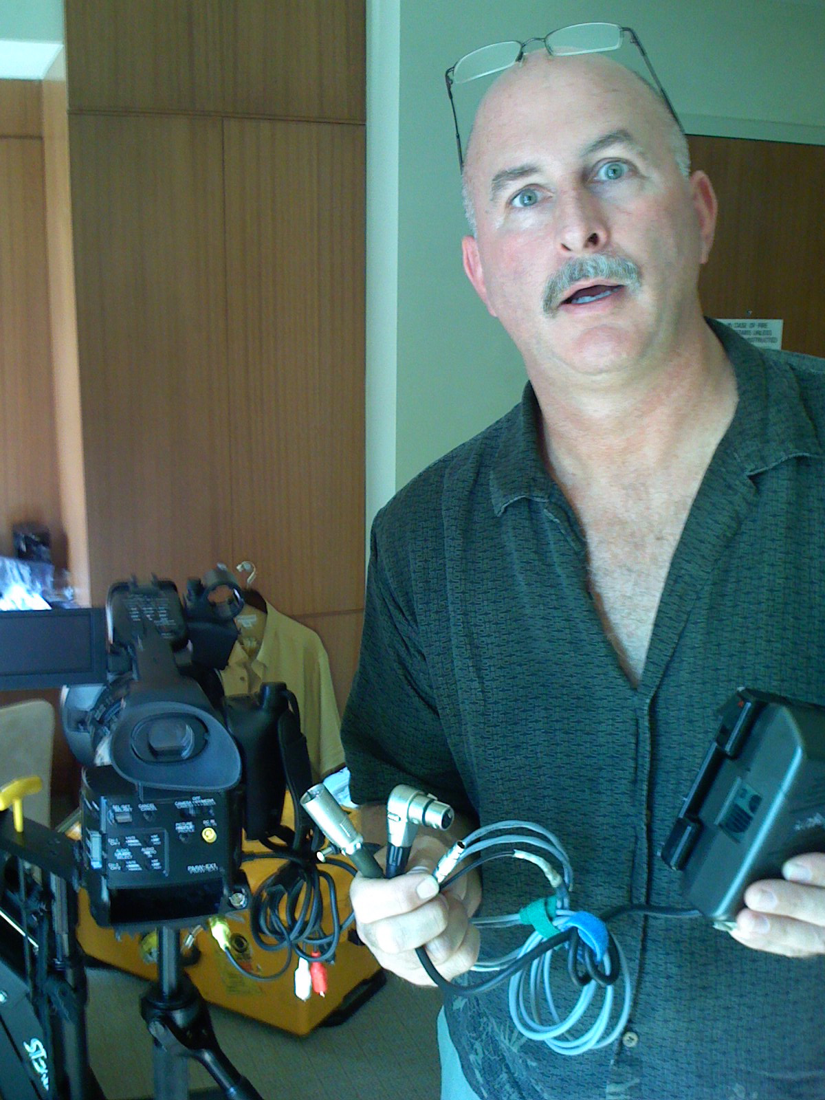

Unauthorized Test
As a beta tester for the EX and other XD cameras, I'll pass on a story with caution. When I received the prototype in September, the battery that came with it would not take a charge. I had to shoot that day and there after. There was no extra batteries around. Only 4 Prototypes out. No extra batteries. I asked Sony NJ if I could adapt the AC power cable to an ANton B Plate using Dionics. They were not sure @ that point if the DC connector would fail using the above. We were in a pinch. They indicated I could go forward with the adapter, but NOT Support it. Their camera to loose.
I mounted the camera on a Steadicam flyer with the AB supply and all went well. Boarded the NYC subway and shot for three hours non stop popping up on various iconic locations in NY. The footage is great. An EX on a flyer is a blast. But still no word on external adapters approved by Sony. Stand by.
Spec notes
EX
Battery 10.5-17v
DC 12v note no range
