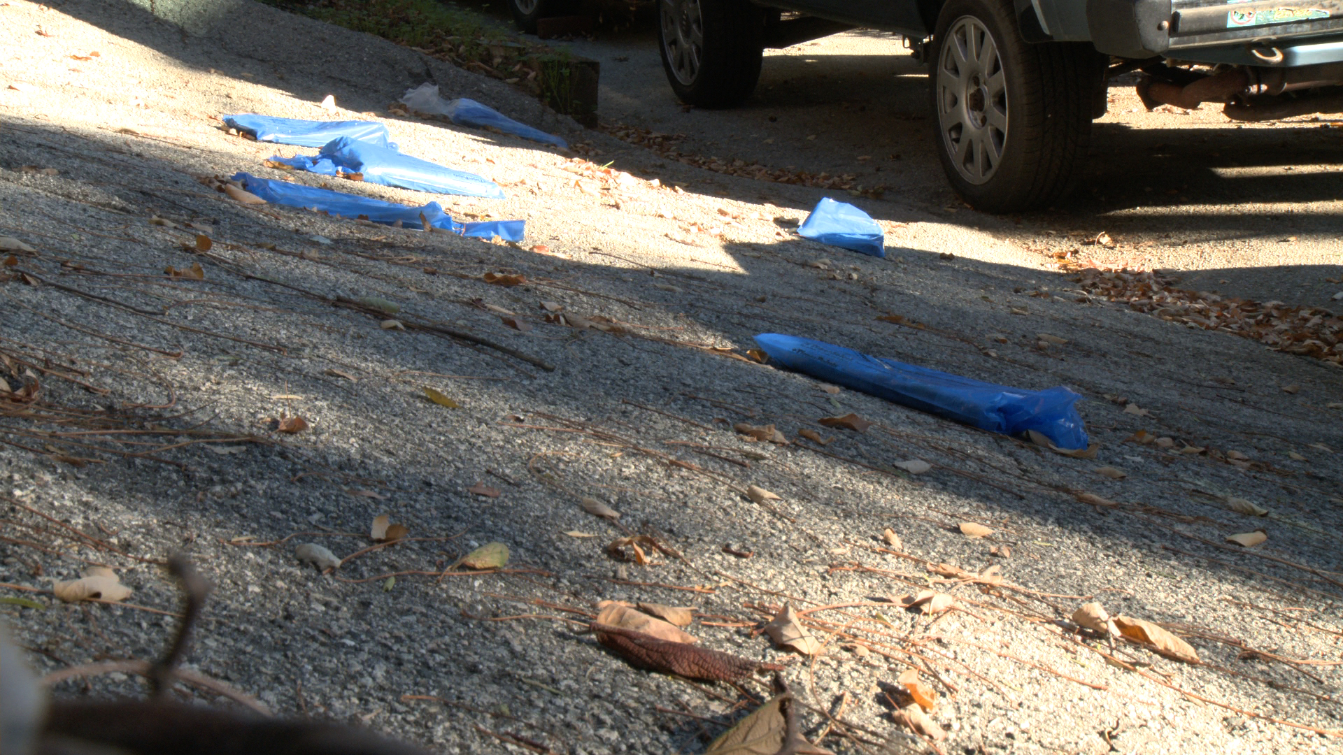

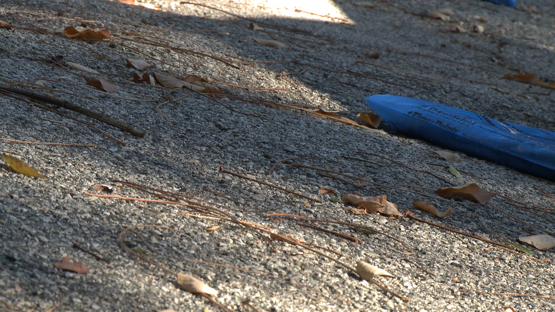

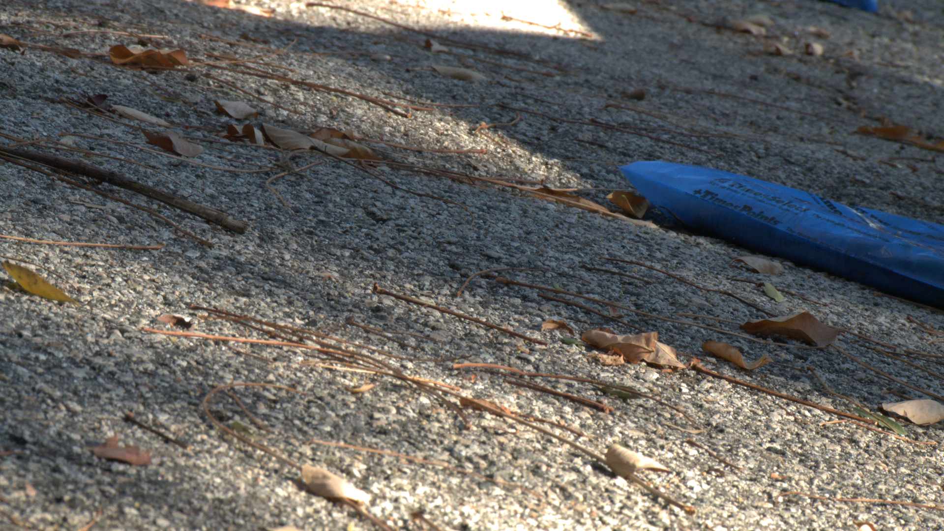

More Grabs - Detail On vs. Detail Off
These are A/B comparisons of detail on vs. detail off (in that order).
Standard gamma 4. 1080p. Detail, when on, at its default settings.
I am happy with the results without detail and probably leave it turned off in most circumstances.

Is the "detail" function just an additional sharpness "boost" in conjunction with the sharpening settings of the camera? The stills on and off look impressive, but I'd have to say that I actually prefer the "on" setting. IMO, it looks sharp without any strong edging that says "video".

that detail setting is really aggressive -- what was the setting (you say default but where does that lay in the possible values)?
load them both up in photoshop, add some levels, and look at areas such as the shadows under the truck - it's sharpening those up too! Plus the big one is the edge around the blue bag nearest the wheel, the difference is night and day. (dare i say filmic vs video?!)
i've noticed this with most of the examples i've seen, from the very first comparison one with all the four cameras.
I don't think much of the detail algorithm they're using, it would be better to sharpen in post if the image needed it, a few seconds in after effects produces a much more pleasing image. (Also if you take just the brightest part of the image (the actual clipped areas) blur a little and screen back onto the source you can soften the those clipped areas, i find it helps a lot especially with little sources)
i think detail off turns this into a much better, natural looking camera. Now, where are all the shipments of it?!
thanks eric, this has been so helpful

The detail off shots look like a DSLR if one shot stills at 1920x1080 pixels. I still prefer the detail off because that is the most natural raw tap from the chips. Some people will of course prefer the detail on because they will view quality as crisp and sharp. Me I see quality as clean smooth gradations that are natural. I am just so amazed at how detailed the EX1 is with the detail off. Like I said in the other thread this is about as much natural detail as you can get without shooting 4k.
This is the first handheld HD camera I have ever seen where you could get a DSLR quality print from the video footage.

After checking the tighter image I thought detail on for sure.. but when checking the other image and seeing the edges of shadows and that chromatic abbrevation looking thingy over the smaller blue thing contrasted to unnatural line, I have to say detail off off off definately
