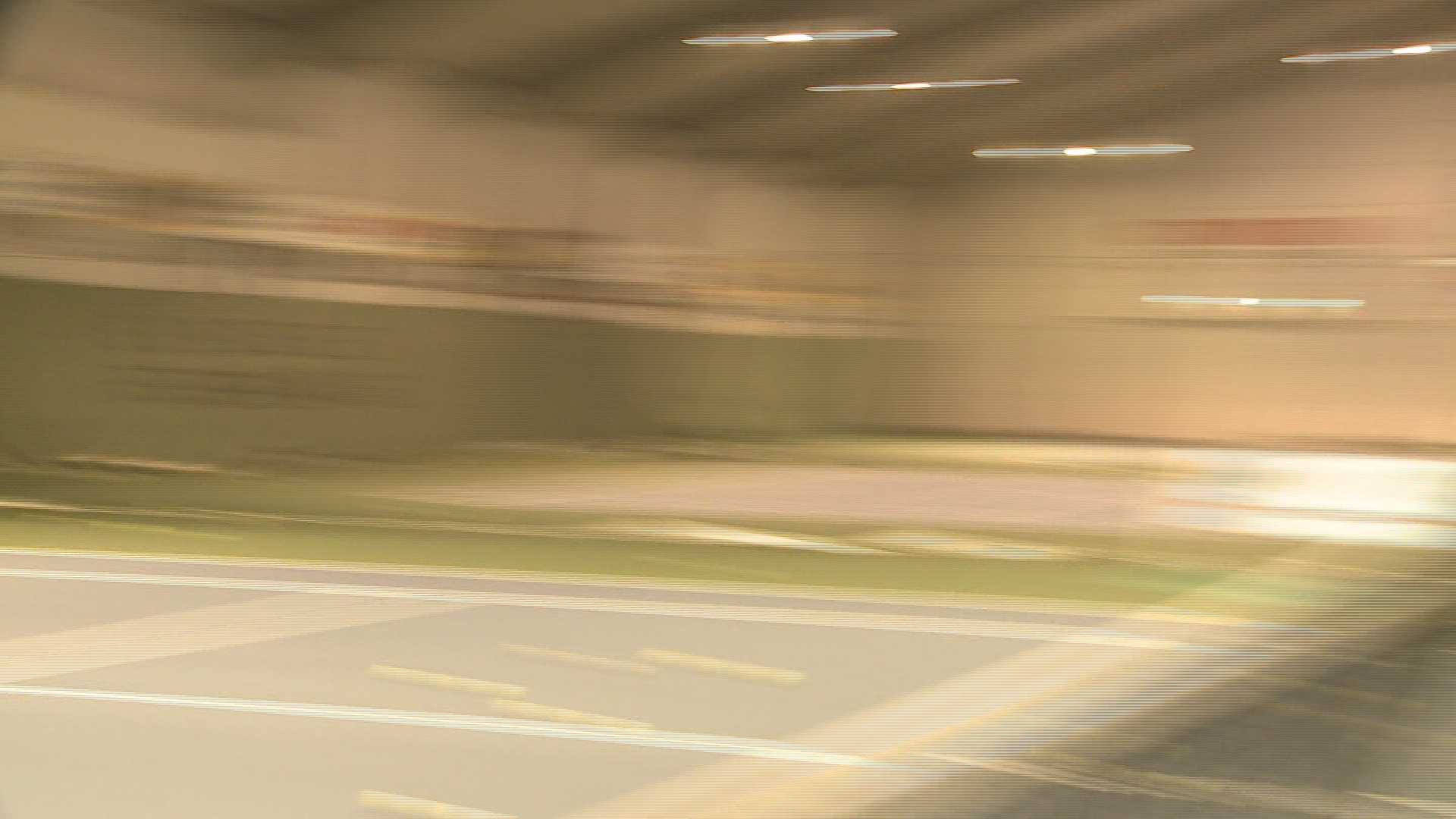

Does anyone else see a very brief vignette in one of the original tennis clips?
In the first second or so (00:01:05) of Clip "X02_0036_01.MP4" as the camera zooms back out and whip-pans across the net, there is briefly a shadow/vignette popping up in the top-left (I think), although not nearly as severe as Paul's example!
It seems to be triggered by the fast camera movement causing the OIS to steer left momentarily - perhaps this is indeed where Paul's unit is faulty (OIS stuck in a far-left position?).
It would make sense that a 'bug' like this could very well be the reason for the slow release of shipments (QC filtering out the duds). It is also something I think everyone receiving the early shipments would be wise to test for straight out of the box - long before taking the camera out on any critical jobs.

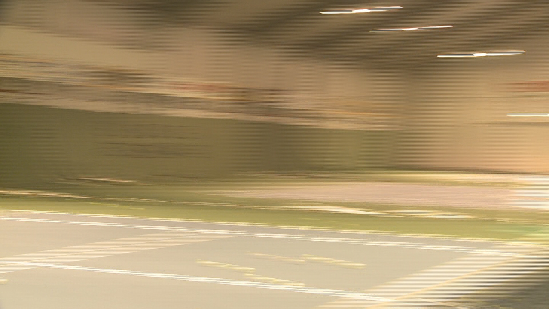

You mean this?
Difficult to say whether it's the "vignetting" artifact, or just one of those ribs under the hall roof... Judging from their spacing, though, it shouldn't be there! On the other hand, considering fast pan - due to the rolling shutter everything is possible. Paul's were static examples.
Edit I posted two grabs on purpose; even if it may look like a part of the roof structure in the left (earlier) one, it shouldn't be there in the right (later) one! Seems like it's moving to the right with camera.

That's exactly it Piotr, thanks for posting the grabs (I'm stuck on a work machine that can't frame-by-frame easily).
I don't believe it to be part of the background structure (see earlier frames), this example is only a slight intrusion compared to the problem Paul has experienced. Just seems to indicate an OIS issue is to blame as has previously been suggested.

On the first image I would have said it's just the building, but in the second there is a dark area where the same area was not dark in the first image.
[Edit] you know, the more i look at this the more it looks very similar![/ edit]
Only the camera owner could answer for sure though.

IMO, that does not look like vignetting. With all the quick pan motion blur, this is probably part of the background.
Also, I asked the camera owner to do a test a day ago. He said he would.
He has not mentioned any vignetting issues.
Paul.
Exactly Paul; this is why I posted both grabs!
Well, this would support my little theory earlier in this thread... Some design feature might cause all the cameras to be on the verge of vignetting (or whatever you call this artifact); most do not so the QC never noticed. But some do, and now Sony is inspecting and returning those faulty ones - hence the delay and shortages...

It possible, but at least looking at these two images which of course are not one for one. One is wider and at a slightly different angle. IMO, you can not tell anything from these images based on the FOV is different.

I see what you're saying Steven, the second shot is wider and that could cause the roofline object to be staying in view. If you look at the two light objects leaving a trail each side of the net line at the back of the room though, the second image is definitely panned further to the right than the first one. I don't have the source file, does it show the shadow moving with the camera?
