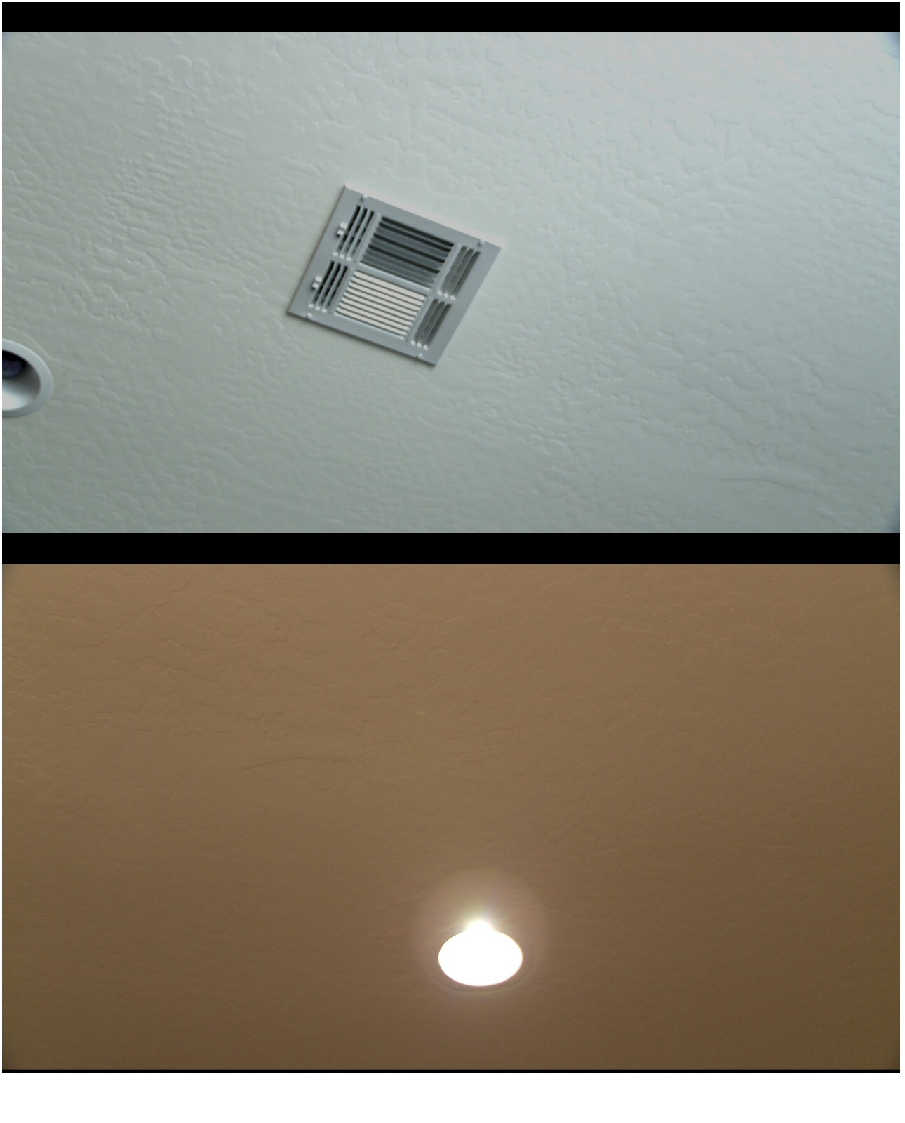

Old January 4th, 2008, 08:31 PM   #426
Location: Gilbert, AZ
Posts: 1,896
Well,
It's definately better, but it's still there. The top image was before, the bottom is after adjustment upgrade. I just received my camera back from CA yesterday.
Granted these images are extremely different exposures. I believe the lower the exposure the more obvious the vignette. So, it's possible that it might not be as obvious if exposed the same way as in the before repair image.
I've seen and and heard from others who have said they now do not have the vignetting issue after the adjustment.
What do you think?
Old January 4th, 2008, 08:59 PM   #427
Location: Norfolk, UK
Posts: 627
Sorry to hear that Steven. I would be inclined to ask for a replacement too, especially after sending it off to be fixed once.
I don't know if mine was fixed after production or not, I suspect it was fixed as the box had been opened and the camera showed 40 minutes of usage.
regards
paul.
Blog: www.pauljoy.com

Old January 5th, 2008, 07:00 AM   #430
Join Date: Mar 2003
Posts: 4,711
What do I think Steven? I think that you have cause for concern on a couple of fronts. The first being that quite possibly your camera has now been tampered with on some workshop bench, and as much as we all imagine the camera has been serviced by a young (good eyesight, steady hands), well experienced technician who has done many hundreds of these repairs, in all probability the bench is cluttered, the light and pay could be better and 'It's Christmas, so what am I doing here?'.
The second cause for concern is that once opened on a workshop bench in rather heavily polluted downtown Whereversville, the camera will more likely develop other faults further down the line, rather earlier than a factory produced and factory sealed product.
But are you (we) are all putting so much emphasis into this very minor technical failing? When will you ever film an evenly lit surface such as this, hold it for 10 seconds for the viewers to contemplate exposure variations and display it on a totally non-overscanned display?
My wideangle converter just vignettes the very corners ( maybe 4 pixels) of my Z1's frame, but so what? When I use that 17 mm equiv beast, I assure you the viewer will not be perusing the frame for vignetting.
It's long been said that you shouldn't buy a new car in the first 6 months of its production run, that is not unless you want to finish off the prototype testing for the company. Same with the EX1, good people. Take heed from the length of this thread.
tom.
Old January 5th, 2008, 09:15 AM   #431
Posts: 1,896
Thanks Tom.
Some of my work will involve needing the entire image. It's not all broadcast. Also, I have seen the vignette in plenty of footage I shot. All it takes is for the corner to have a flat color surface.

More on my issue
I'm starting to think it's worse than it was before sending it in.
Here's a frame grab of my boring living room..LOL
1080 24P HQ
1/48th shutter.
Approx. 12mm focal length
fstop: 1.9 (open)
http://members.cox.net/proaudio4/EX1...f19_24P_48.tif
I can see the issue in many of my shots.
Again, it's there between 8-25mm focal length and does not disappear until you close down
the aperture to at least f4.
Old January 5th, 2008, 03:52 PM   #435
Location: Sydney Australia
Posts: 1,570
Just a random thought on this issue which also affects my camera.
The EX1 has a Safe Area overlay. Well that seems pretty irrelevant to me as almost all HD displays display all of the 1920x1080 frame. The one exception might be the HD CRT monitors. It's quite possible that the techs doing the work and checking the cameras aren't seeing the problem depending on the monitors they're using.
As to suggestions it doesn't matter I'm not so certain. Something in the corner of the frame that comes and goes across cuts or wobbles around thanks to the OIS might be very distracting. While we don't consciously see things in our peripheral vision we do react to them. If it was a static vignette that was always there it would perhaps be less of a problem.
