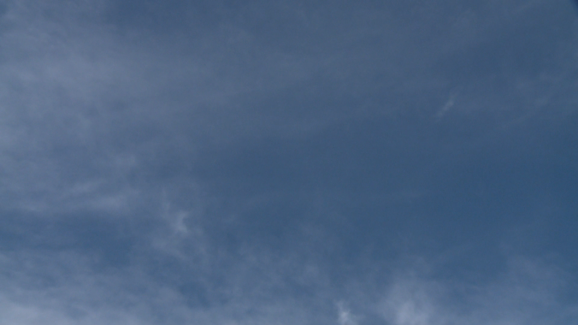

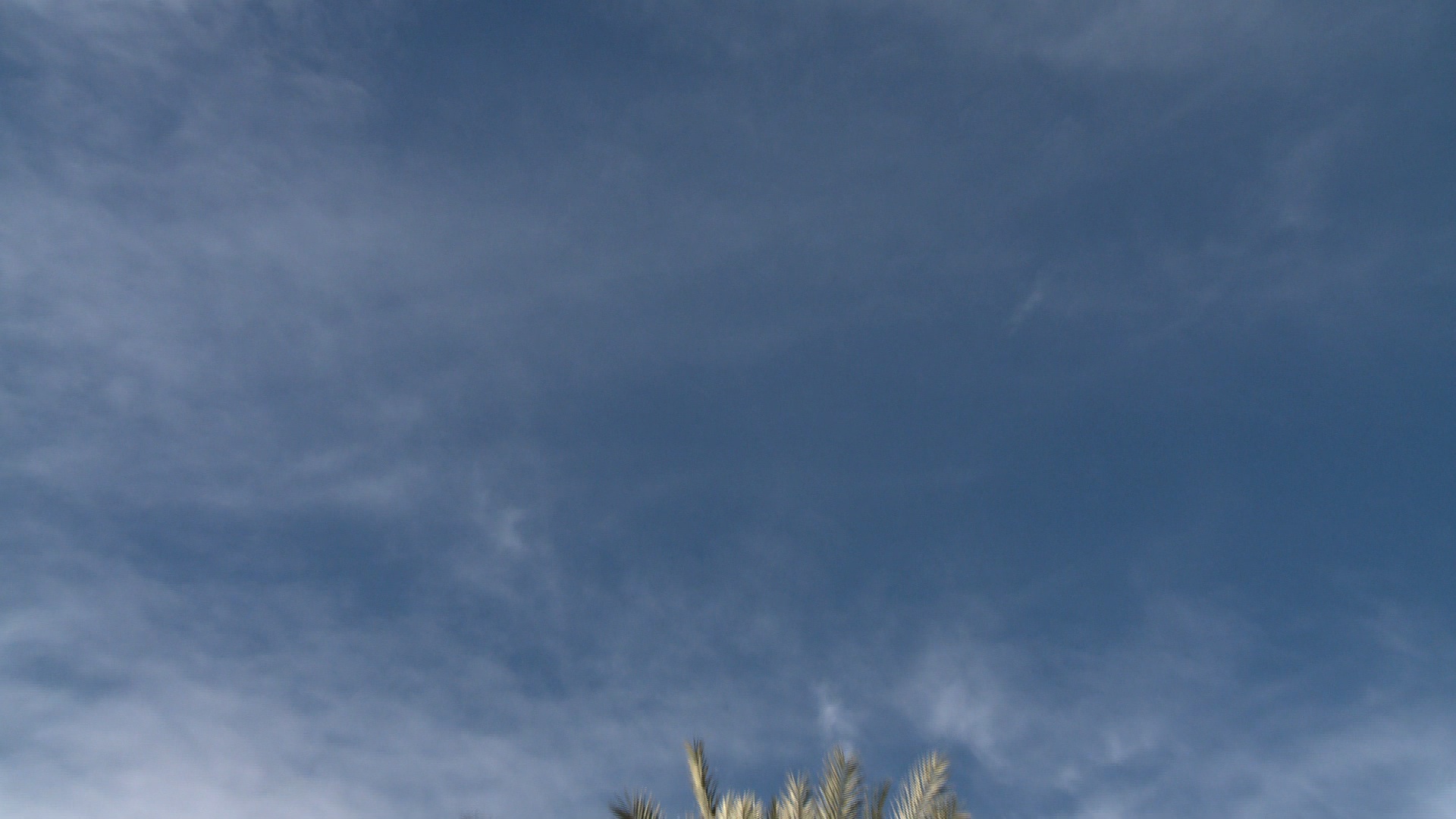

Could someone who can view Mac created mov files please check this out and see how bad the vignetting shows itsef. Carol said you really have to look to see it. Unfortunately, I have a PC. MAybe perform a screen capture during its worse section.
Here's two screen caps, Steven. One where the vignetting in the upper right is worst and one just before the vignetting shows up.
It is _very_ subtle.
Carroll Lam

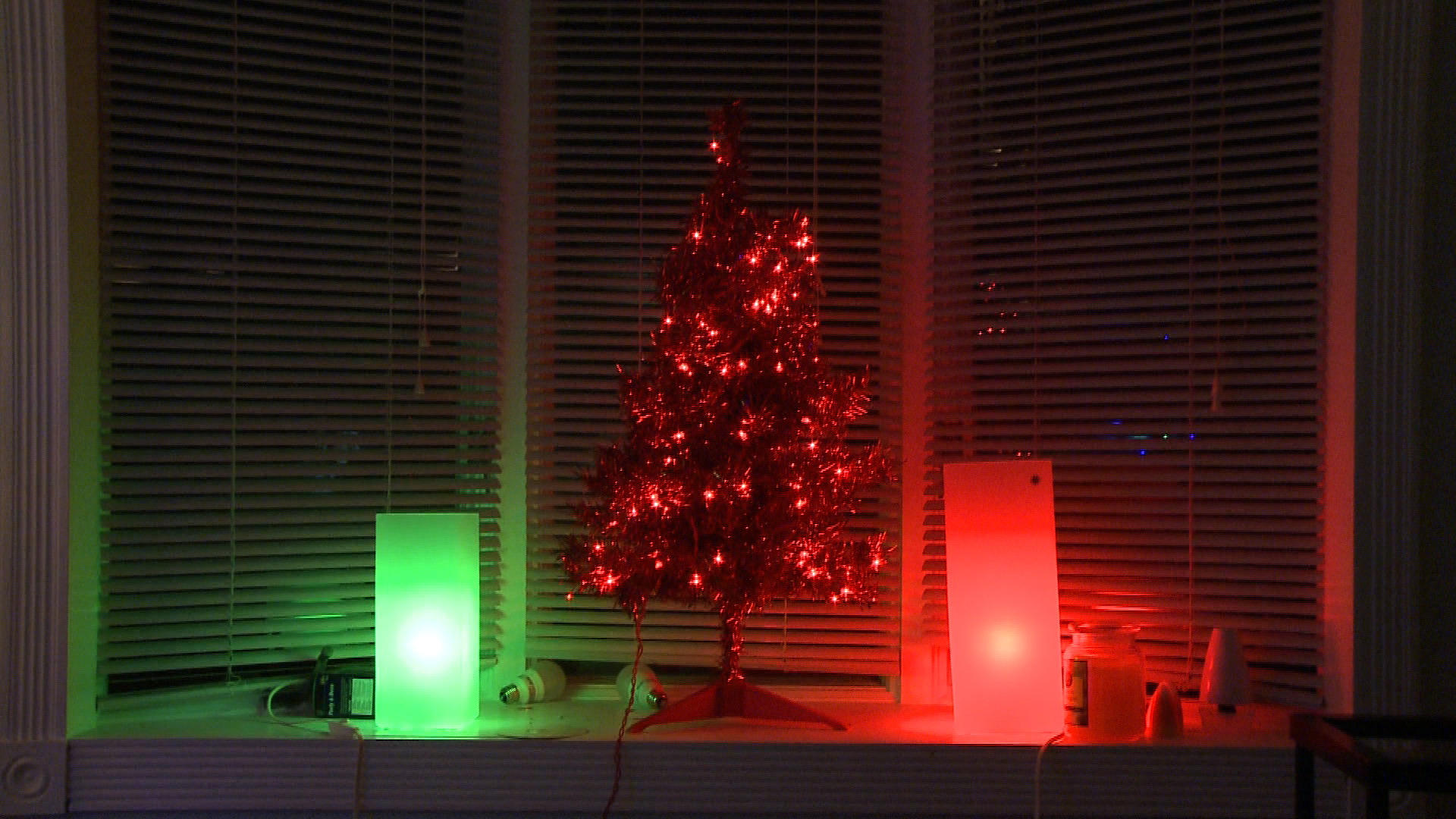

Steve
I'll give it a try. I did notice something different while playing back some stuff I shot in my living room under low lighting. Vertical objects had the appearance of not being straight. I was not panning the cam..
