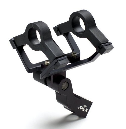

How are you all mounting them
Is anyone putting these mics into the on-camera mic mount? I saw one picture of someone who removed the camera mount and bolted on their own shock mount. Are you mounting them on the top? I guess some fit the camera mount and some don't. Any comments?

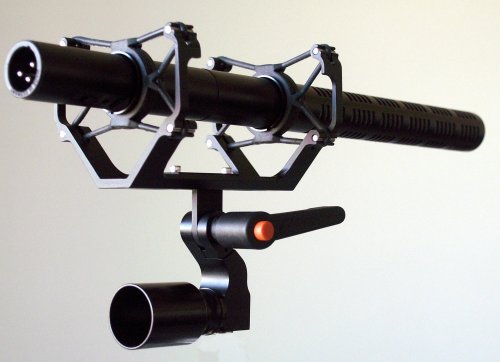

I'm using this on my EX.
The picture entitled "ksm3.jpg" is the model I actually have. The picture "kbwc8.jpg" shows the screw on adapter that mounts in the stock camera mic holder, which I'm also using.
http://www.mklemme.com/
- Don
The standard mic mount breaks way too easy.
I've made my own:
http://www.dvinfo.net/conf/showpost....80&postcount=6
When I get some time I'm making a number of the brackets and I'll get them black anodised.
