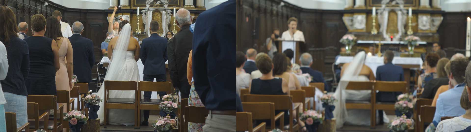

I just tested twice and it stays in focus now, will do some more testing this week. I have absolutely no idea what was going on but I"m 100% sure I set the camera on manual and when I checked back it was still on manual but completely out of focus. 2 weeks ago I used the camera in the same way during a ceremony with no issue. Below a frame grab when I started to record and then 10 minutes later, there is nothing that could have trown it out of focus because when I switched to autofocus it immediately snapped in to focus again.

The bottom right is nearly in focus i would say maybe you had it in auto focus and it was focusing on something else, are you sure it was in manual, as i have thought this in the past Noa and i was mistaken. Steve

Yes, absolutely sure I was in manual focus, checked 3 times while it was recording in church and it went out of focus 3 times. It was also preset to focus in the center of the frame so anything from the sides should not have affected it.

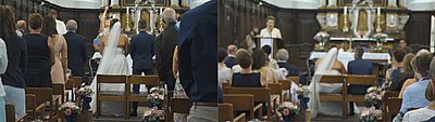

The way it went out of focus is not normal, it gradually shifted focus over a period of 10 minutes, I tried a few new tests today and all seems fine again, I guess it's one of those Sony mysteries.
Below is one of those 10 minutes in a few seconds, I blocked the top part of the image with faces because I don't have approval to show this online, one thing I noticed is if you look at the right side at the end you see the camera is focusing to a very nearby distance.
