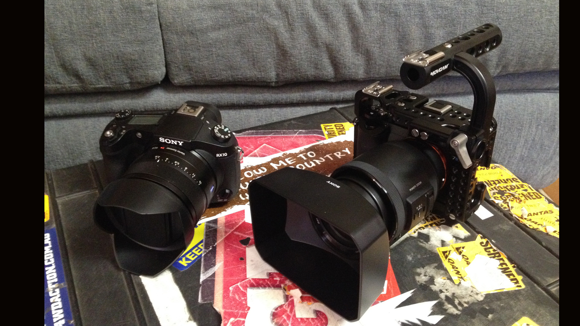

It's a great camera. I have been using the RX10 for a while now and really fits in with my current gear and workflow.
Video is great and the stills are great also. Image on the video side gets a bit noisy at ISO 3500 and over but hey… at that price it will do.
In fact my new go to kit is a Sony RX10 and Sony A7s. These fit into a backpack and I'm good to go.
