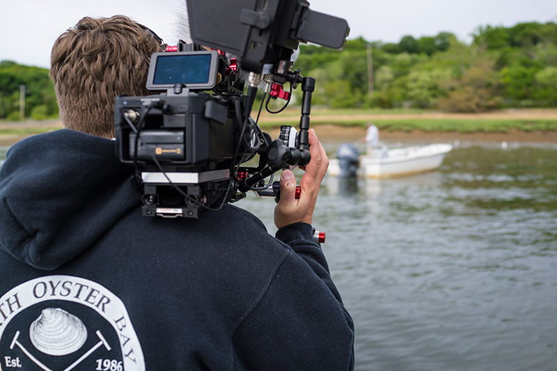

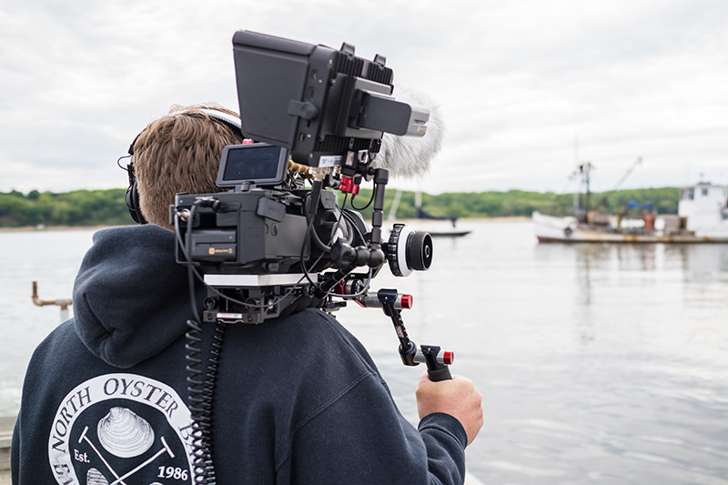

Yes I know the FS7 is the new camera on the block but I don't care. As of last week I love my old camera like it's new again. Why? Because finally my journey toward using the FS700 as a proper ENG camera has ended, with great success. I have shot with this camera for three years now, and never has my footage looked this good. The camera feels nice and heavy, it's balanced, my shots are focused where I want, they're exposed how I want, I'm shooting beautifully gradable 4K footage through my Odyssey7Q, both units record from the same button, I can see it all perfectly though a properly adjustable diopter in a great new EVF, and it's all happening right up there on my shoulder.
I had to jump through a few hoops to get all this working together. Zacuto's new sliding shoulder camera mount helps not only in getting the FS700 on your shoulder, but also balancing it - which is a key difference to the rigs I have used in the past. But you can't just bolt it onto the FS700, even though I was told you could. The lens mount on the FS700 is very close to the bottom of the camera. This creates problems when you slide the FS as far back as you need to in order to balance it. I had to fabricate a 1/2" riser plate which I mounted to the camera's base, then I mounted Zacuto's sliding shoulder mount to that. This allows you to mount lenses and adjust the height of the rails properly. The Gratical HD is pretty new, I experienced a few issues with a unit or two but kudos to Zacuto, they are extremely prompt, generous, and supportive in resolving issues. I just used the new EVF successfully for two weeks out on the water, shooting from the deck of 21' clam boats. Remarkably steady shots all from my shoulder, sometimes in decent winds, often times while motoring at 5 to 15 knots. I never could do this with any configuration I ran the FS700 before. This water project is a year in the making now, four trips total, always shooting from boats. I went through most of my footage last night and there is a great difference in focus, exposure, and stability in this most recent shoot compared to any and all shoots previous to this setup.
It was expensive, adding the EVF, the shoulder mount, and a few other necessary bits to my old kit but I honestly feel like I have a new camera now. More than that actually, I feel like I have a new style of shooting. I used to shoot with a proper ENG style camera years ago but then I switched to Sony's EX3s, which eventually led me to the FS700. Ever since then, and especially with the FS700, it's been so much harder to be mobile. I never recognized it as such in the past, but looking back since just a few weeks now I feel like someone just untied my legs and hands. I'm free again. I'm quick. And I'm more accurate than I've ever been. That's a remarkable pairing for me.
I am not the gear reviewing type but I will say this - the Gratical HD really does create differences for me. My focus is more accurate, and it's so much quicker. I expose more accurately than when I used my Odyssey7Q to expose. And finally I can move with a camera on my shoulder again. That is everything to me.

Sorry for the slow reply Sami, I'm just back from a long weekend being really fast.
I just looked and unfortunately the only shots taken of the rig were from the rear, when it was on my shoulder. I'll build it tonight and take some more revealing shots. One thing you can tell from these is the follow focus is mounted to the right side of the camera. Weird I know, but without purposefully adding weight to the back of the camera you really have to slide the FS700 rearward to balance it on your shoulder. This can put the lens pretty close to your chin so I turned my follow focus around and went from the right side instead. It is doable, shooting this way, but mounting the Odyssey on one side of the camera put more weight on the grip of my right hand, so reaching up to focus took extra effort with my left grip first. Not really ideal. I should put the Odyssey in the back instead. Only reason I had it on one side is so I could glance up to my right and confirm it was recording/had space on the cards/had battery life left.

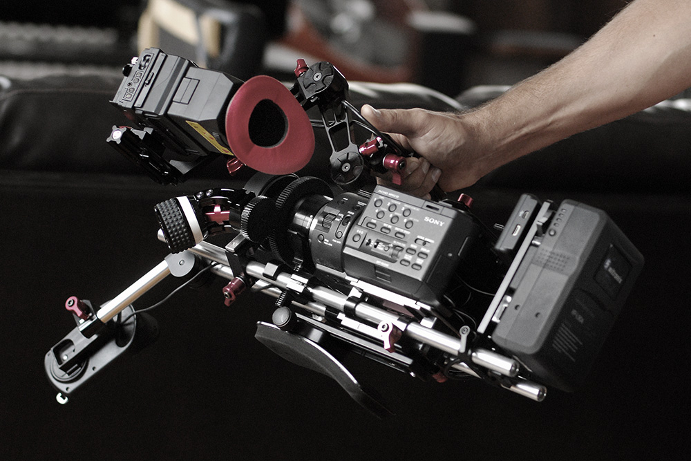

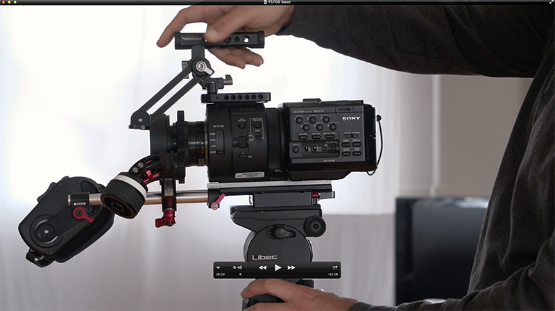

The Zacuto Gratical is a fortune, but I would much rather clearly see what I am doing with a modest camera than squint through the best one ever made. Cant bring myself to order one without looking through it first, but I am going to NY next month so I will stop by B&H for a peak.
FYI, the Zacuto Z Drive is amazing, it moves the control forward and down and has the option of the extended handle but one thing they don't mention much is that it has fluid drag so pulling focus on modern AF lenses that have zero throw is much much easier

I really like the Z Drive, having the fluid dampening, has made my Nikon AFS lenses that I could not use because the slightest twitch of the focus ring was several feet easy to use now. I shoot from tripods pretty often so flipping it around to point back has also been a nice bonus for my wrist
The grip re locator works and is solid but $150 bucks is pretty steep, I was buying the follow focus and some other bits I actually needed and just went for it. probably could just stick a cheap small LANC start/stop switch on the handles you have
The only recorders I used are the Atmos Ninja because someone wanted ProRes same day (I just wedged it between the cheese and the camera) and the CD Odyssey 7 (mounted it to a tripod with a big magic arm)

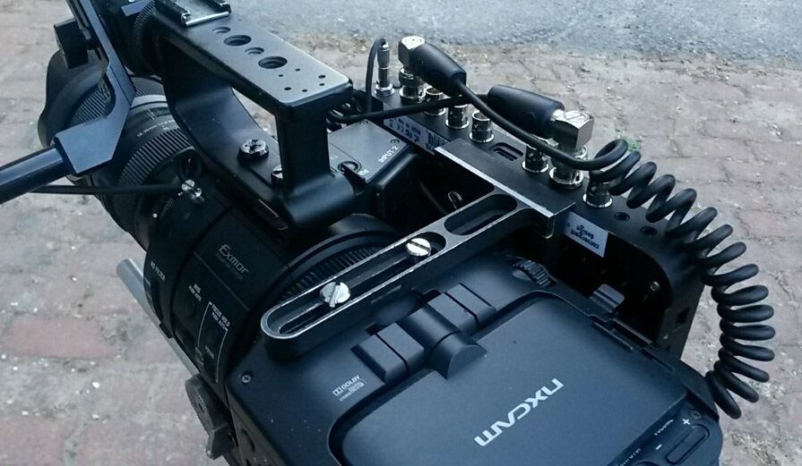

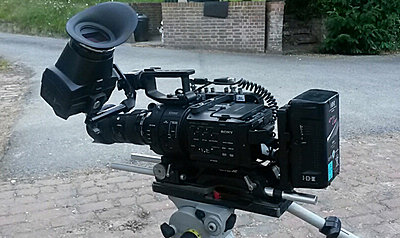

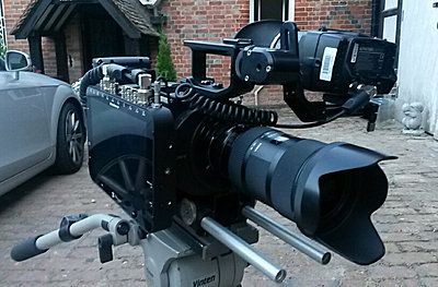

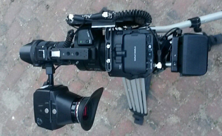

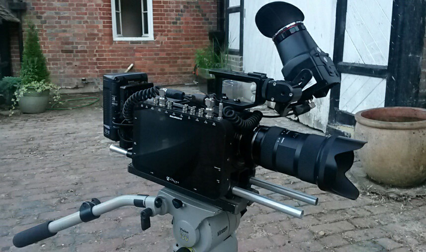

Hi Eric
I totally agree with your sentiments. When the FS700 is properly setup it can be a very good ENG style system and produce amazing images with great flexibility in fps and formats on the 7q. With that in mind I set up this rig about 10 months ago and have been using it ever since.
I shoot documentary for broadcasters in the UK. I shoot sync and wildlife from macro and studio setups to field natural history on long lenses.
I wanted the body to feel like 'one camera' not a camera body with a recorder separate. As I mostly use an EVF the monitor becomes great for a director to keep an eye when he/she wants to. It also makes it very balanced. Balancing out the evf on the other side. Finally it's all powered from a single power source and the vlock balances it back to front.
I have had reliability issue with the 7q however I hope this can be resolved. Once it has this rig in my mind is as good as an F55, maybe better in some ways!
