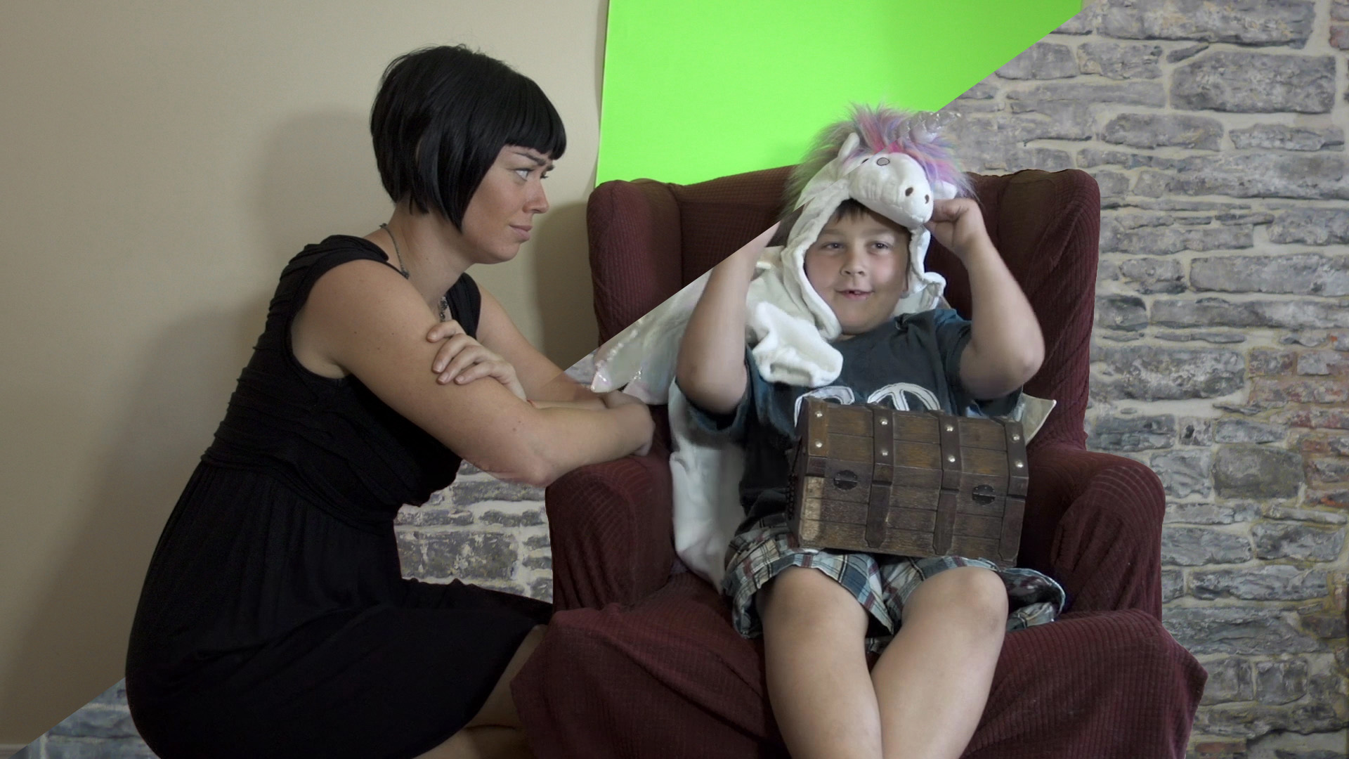

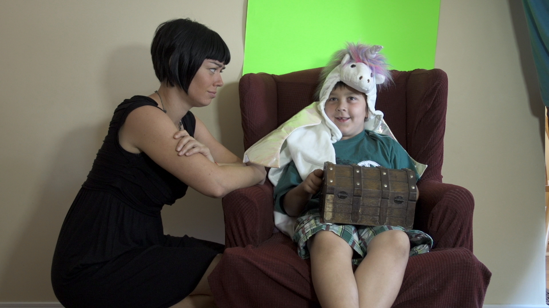

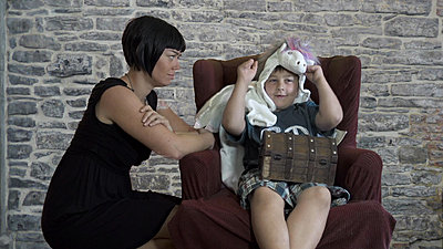

I found green screen keying on this a breeze (rotoscoped the rest with edge define) all done in after effects CC
