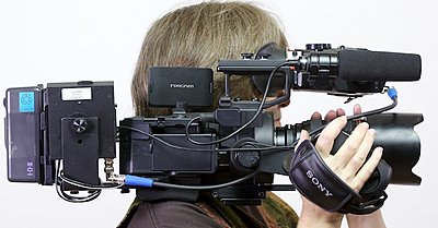

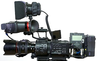

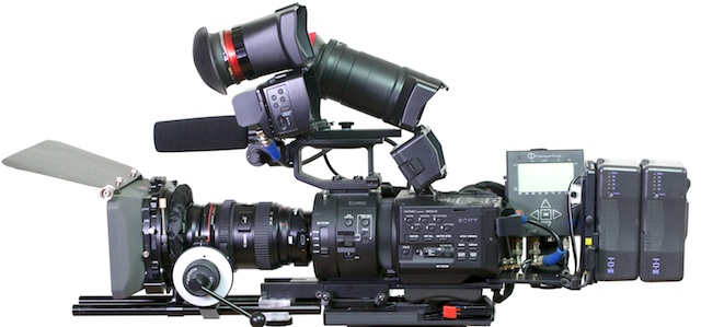

Here is a photo of my 700 rig. The IDX battery suppies the power for the Camera NanoFlash and light, it can also power the EVF , this is very convenient.
With my handle relocator it makes a great shoulder rig. Rails can be added as well.
External recorder for the fs700-fs700nf-001.jpg   External recorder for the fs700-fs700nf2-002.jpg
