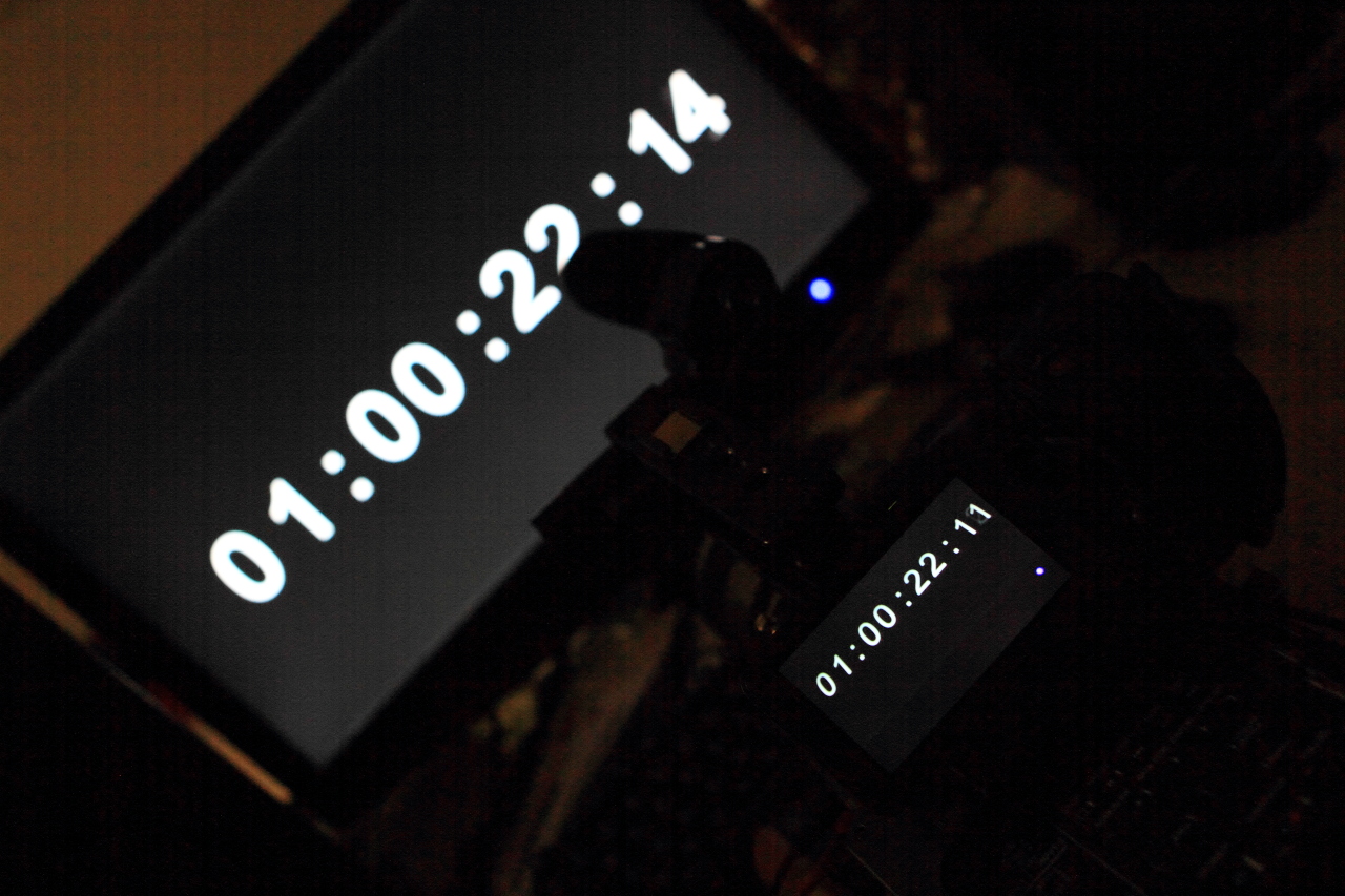

Here is a photo that will show the approximate frame delay between the incoming image and the monitor on the FS700.
Looks like its about 3 frames.
Hey Chris,
Good visual demonstration of the issue. What settings did you use for frame rate? If you had an external monitor hooked up it would be interesting to see if the delay on the output is the same for the internal and external monitors. Either way I bet it is built in to the architecture and hard to eliminate.

That was 23.97fps 180deg shutter.
