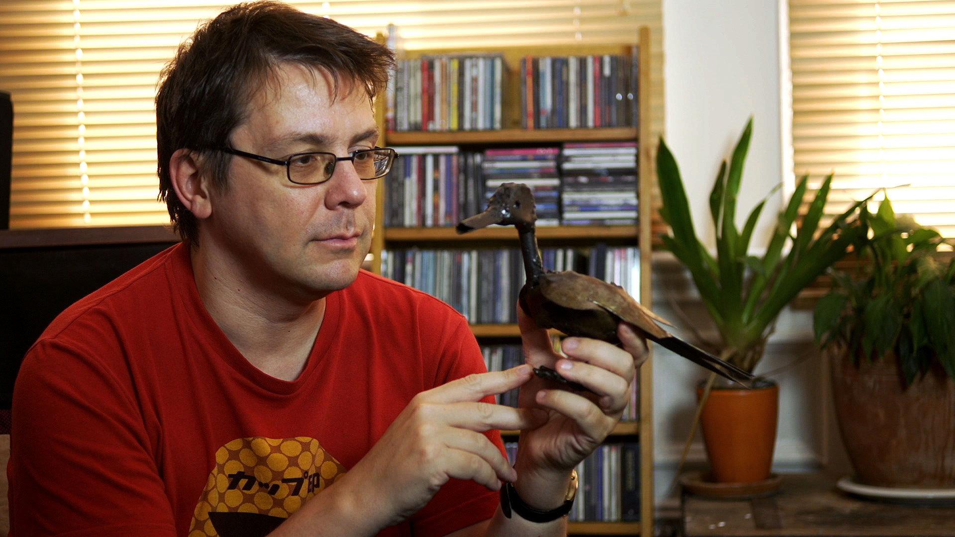

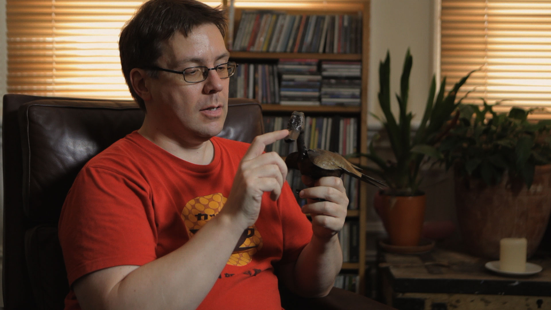

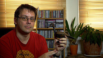

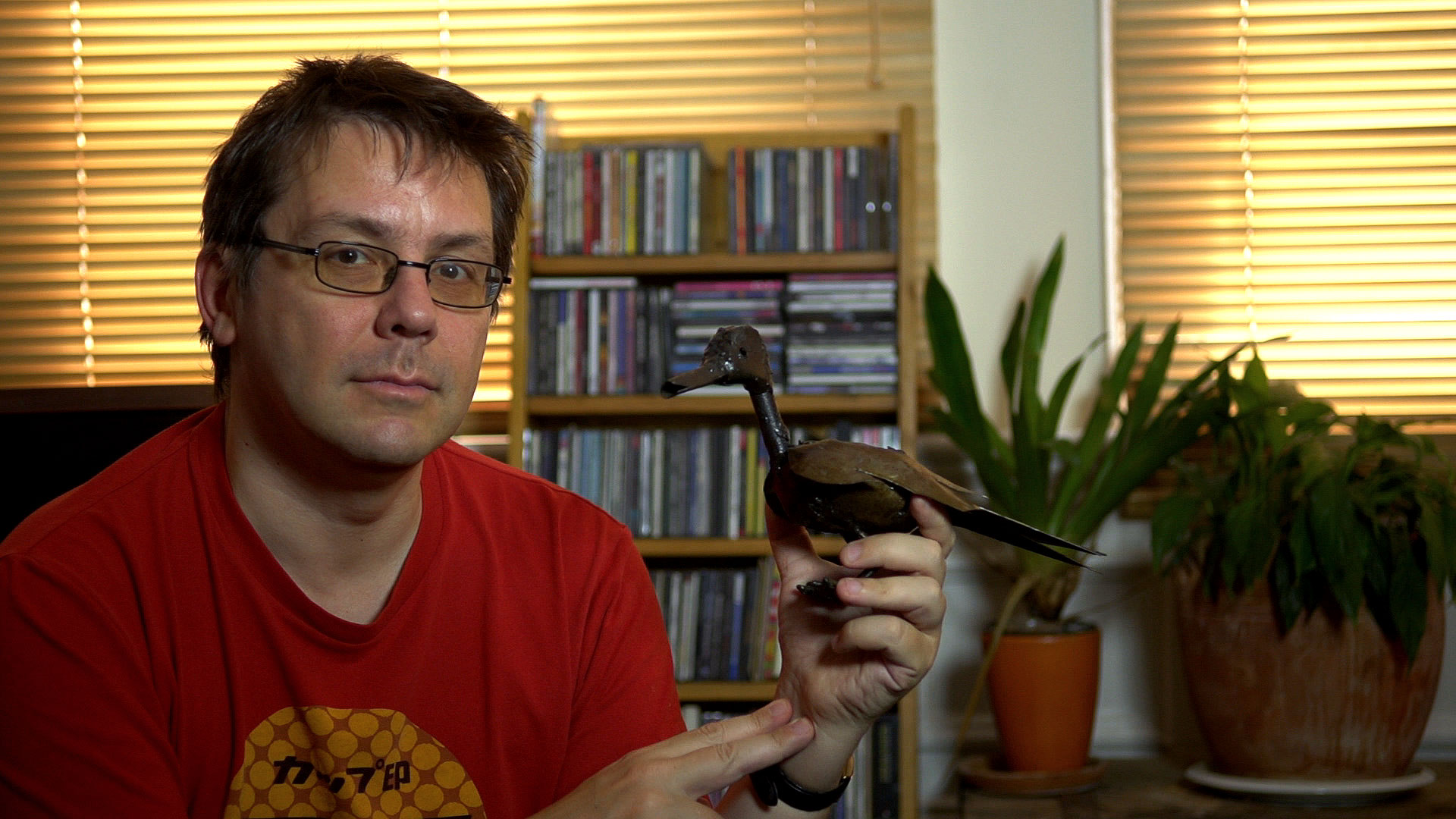

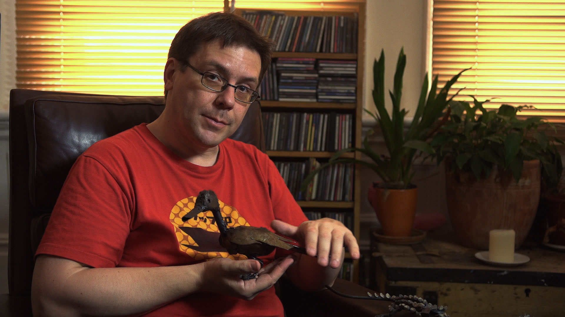

Yesterday, I managed to (albeit hastily and not quite exactly) recreate a scene I shot last year on my FS100 with v1 with exactly the same light at the same time of day with the same camera, lens and PP but now running v2 software.
Just to be clear, we're looking at the wooden blinds behind Alex. The v1 software's CineTone has issues with the red channel clipping too early, causing horrid posterisation. In the second image, the posterisation is far less problematic, and rolling through the exposures, I couldn't get the effect I had on the v1 shoot.
For good measure, I've included a still from the 5dMk2 which shows - like the EX1R - what the blinds SHOULD look like, and now a FS700 shot with half baked CineGamma 3 profile.
Somehow, I think shooting charts wouldn't have helped, and doesn't seem to expose (if you pardon the pun) the problems one can run into.
Here's the stills direct from the timeline... (though it looks like there's a gamma shift as these are from FCP7)
Image after upgrade-fs100-v1-software-ct1.jpg   Image after upgrade-fs100-v2-software-ct2.jpg
