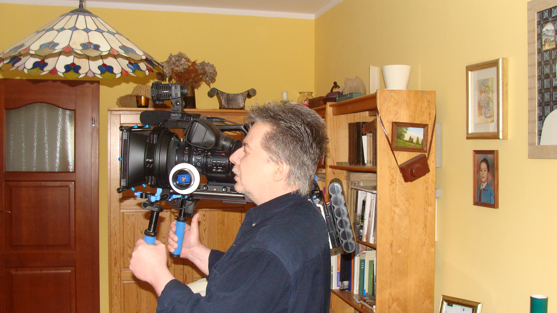

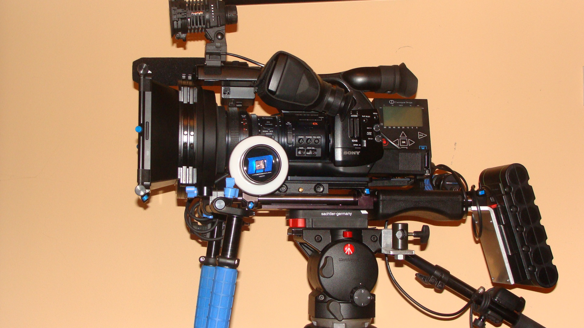

Matt,
Since you own both the EX1 and FS100, I'll appreciate your advise. Looking at the pics of my current shoulder-support rig, do you think it would work with the FS100 replacing the EX1, without any major modifications (apart from probably making it shorter, depending on the lens used)? Of course, I realize I'll have to put my Marshall monitor on the left handle -before I'm able to fork $1,000 for the Zacuto EVF ...
Is the FS100 an upgrade from the EX1?-modified.jpg   Is the FS100 an upgrade from the EX1?-dsc07383.jpg
Old June 30th, 2011, 10:57 AM   #15
Location: Berkshire, UK
Posts: 1,562
Re: Is the FS100 an upgrade from the EX1?
I'd imagine one could make up an adaptor to take power from the rear battery to an 'empty' NP-F battery, so you can enjoy the counterbalance effect as well as probably near infinite run times with a V-Lok!
There's the temptation to push the camera body further towards your shoulder as the unit will become nose heavy with photo glass in addition to your matte box, and faster lenses tend to be longer. That's where the EVF would be handy, especially on a Noga Arm.
I have a Striker (well, the version before it was called a striker but I digress), and the benefit came from placing the supporting right hand UNDER the camera rather than having a grip either side. Your left hand is so busy with buttons and lens twiddles, let alone needing to find a spare digit to actually press one of the start buttons (I like the one under the side grip near the FMU). I'll cajole my wife into taking a snap of me with it, but suffice to say I think it would favour the south-pawed amongst us.
Can you skooch the right hand grip closer to the CoG so you're supporting most of the weight there? Even under the lens? Also, somebody (Olof?) needs to make a nice looking yet cost effective upper handle, as the mic mount is handy and well balanced but feels like picking a puppy up by the scruff of its neck. Fine if you're a puppy, but not an overweight but lovable labrador. As these rigs invariably become.
