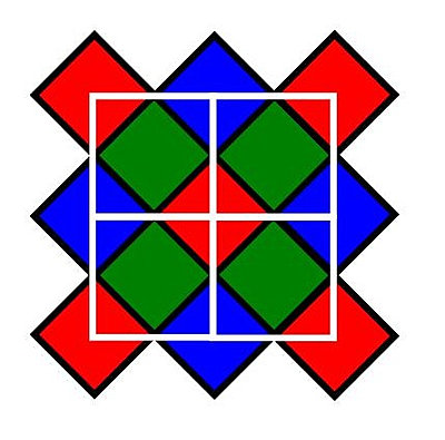

And yes, the secret may not be -- as I have been assuming -- the photosite count of the F3 sensor, but the arrangement of the photosites on the silicon die.
1) Some think the chip could be a Super 35 version of the ClearVid design we both know.
2) Some think the chip could be a Super 35 version of the Q67 design. Here is an edited comment on it.
"After complaining about Bayer Pattern sensors in digital cinema cameras, Sony magically think that rotating a Bayer Pattern 45degrees somehow makes it better. When you look at Sony's "Simulation" image, their Q67 is using 17.7mp compared to their Bayer example of 8.8mp. The Q67 is basically using twice as many pixels."
3) Some think the chip could be a Super 35 version of the "RGB Stripe" design. Here is an edited comment on it.
"About Sony's "Full RGB" solution they use in the F35. At high levels of detail, the RGB Stripe pattern produces rainbow patterns due to the lack of alignment between the three channels. This is plainly visible."
The difference between the 64% value for the F3 verses the 55% for the FS100 may come from a pure marketing decision, or given there are many ways to debayer and some ways yield both higher resolution and lower artifacting -- I'm inclined to guess the F3 uses a more powerful algorithm. This likely requires a more powerful DSP. Conversely, the FS100 (and VG10?) use a simpler algorithm that requires a less powerful DSP.
I have a question for you about resolution measures for the VG10. Did you obtain any?
And, does anyone have from Panasonic the AF100's actual sensor row by column numbers?
Upcoming hands-on comparison of F3, FS100 and AF100 from Philip Bloom-sony-q67.jpg
