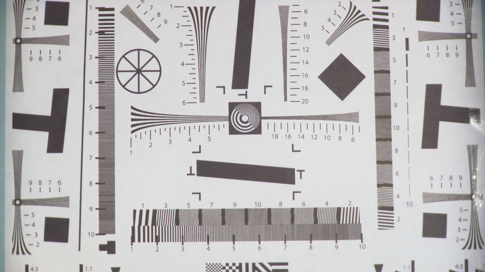

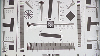

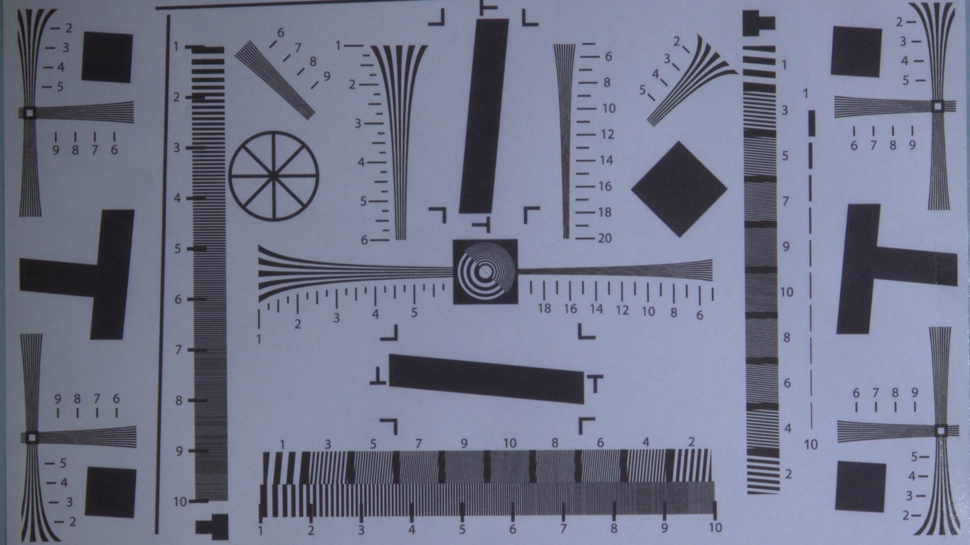

This is a resolution test for my EX1 with the Letus adapter and without. Specifically for Alister and Piotr The chart was downloaded so this is unscientific but at least you can compare the two and get an idea how much resolution is lost by using the letus. Both pics are as they came off the camera with sharpness turned off. Sorry forgot to white balance the EX1 pic
Upcoming hands-on comparison of F3, FS100 and AF100 from Philip Bloom-ex1-letus-resolution-test_00229.jpg   Upcoming hands-on comparison of F3, FS100 and AF100 from Philip Bloom-ex1-only-resolution-test_00229_00229.jpg

There seems to be a drop off in sharpness towards the edge with the Letus, plus a reduction in contrast.

You mean the left top corner? Could be a slight misalignment in how I tightened the letus on. The contrast could be down to the letus image being overexposed.
Anyway the loss of resolution is neglible.

It doesn't look over exposed, although the clean EX is darker exposure wide. I'd expect the contrast to be lower, it's part of what gives the adapters a more film look.
The resolution does looks pretty good in the centre, however, compared to the clean shot on the EX1 the edges do look softer.
