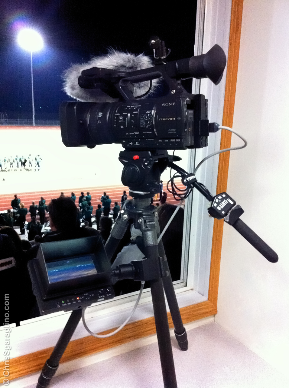

Here in Colorado we don't always get to go out on top of the Press Box to shoot the High School games.
Sometimes the weather doesn't cooperate or the PB does not have a roof to get on.
But shooting from inside the Press Box also presents its own challenges - especially space.
Being that windows are small and that there is typically some kind of shelf/table against the wall - a full size tripod just will not work!
My solution - is to use my Still Photo tripod and a smaller 701HDV Fluid head and then add my VeriZoom controller. Work pretty good - but on some location, I find that this is still too tall for me to operate properly.
So last week I added a new 5" 1080 HD-HDMI monitor and clamped it to one of the legs of the tropod - oh, man what a difference!

Chris...nice rig! I have an 'old' Gitzo G1325 Mk. II, with as luck would have it, a Manfrotto 701 HDV. What 'clamp' are you using for the monitor? The reason I ask, I plan on purchasing an Atomos Samurai, I've been told, when using 'spinning disc' (HDD) media attached to the rear 'hot shoe' mount on the 'NX5', the vibration will translate through the camera. I don't know if mounting the device on one of the legs might help mitigate the issue?
Anyway, nice solution.

It's a Manfrotto Super Clamp with a standard light stand stud that I have a mini-ballhead screwed into.
For your purpose, this might work great as the clamp does have rubber on the inside and would absorb most if not all the vibration form a HDD.
Also, look at the Manfrotto Mini-Clamp if you want something lighter.
