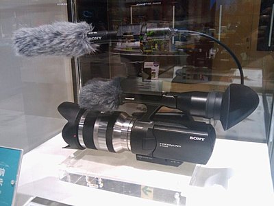

I used the camera for a short time today.
It was weird zooming it with the stiff manual zoom ring. It was front heavy and the autofocus was slow but the image was pretty and the price is right!
It is exciting to witness the start of this revolution first hand!
Bring it on Canon
