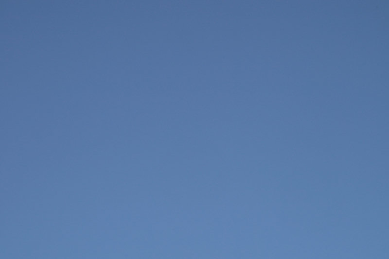

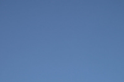

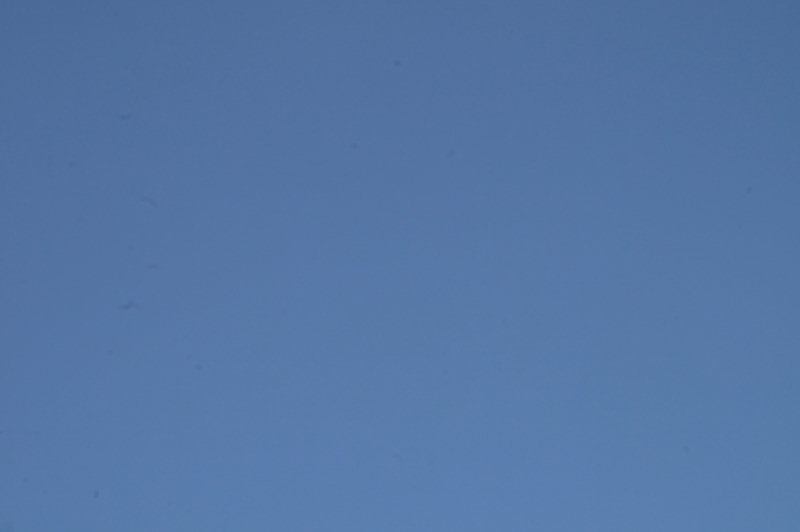

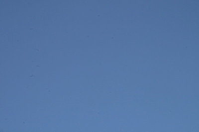

I'm not sure about focus and peaking but it certainly was not normal and it was showing me that I was 50m away and I was only 5 metres!! I guess if the camera "sees" gunk it could quite easily throw out the focus. Some feedback from Dave after his trip could also confirm what his issues were.
I have dropped in the before and after sky shots. I don't know whether this bad gunk or normal gunk ..but that was the gunk on my A-Cam ...the one I seldom do lens changes on ... weird. Bear in mind this is after 14 months so a clean camera would not display as much!! Just one dusty day could easily do that too! The peaking works perfectly now so it's quite likely that gunk was affecting it.
Chris
