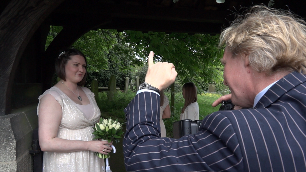

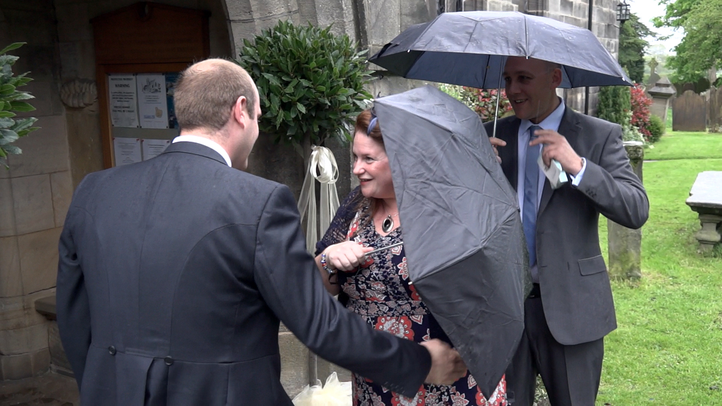

Hi All - I have mentioned in a few posts about my problem with the EA50 easily blowing highlights but here I can give a clear example - In the first shot the exposure is pretty good and balanced but as soon as the woman's face comes out from the shade of the umbrella I get what looks like (or actually is) banding or posterisation on her facial highlights!
It reminds me of them old 256 indexed colour graphics on old computers. BTW I'm using PP3 unmodified in this shot. Is it a consequence of 8bit video? When highlights popped a bit on my old Z1 it just seemed smoother somehow and more graduated.
Any thoughts or am I just pixel peeping!

you can reduce the "blown-out" effect using a better profile for smoother highlights, and you can use the exposure compensation to tweak auto-iris/auto iso, based on the scene.
as a lot of parts on the image are black/dark gray, its a correct behavior. she was on the shadow, then came to the light. the image should be set around to 1 stop less than that (easily done with the scroll control to adjust EV +/-)

If you take the 2nd pic and blow it up 400% you can see that the posterisation on her face very clearly simply because PP3 profile does lift detail from shadows and you will get a bit of overexposure on bright light. Probably something like PP4 is a better bet as PP3 works for me indoors very well as well as in not so bright conditions. What you can do with PP3 is set an EV Value (negative just a tad) and assign that to button 2 (or any other) and that will autoset exposure to under-expose when selected.
That's why her face is "blown" a bit ... If you increase saturation however it exposes quite well.
Now, the posterisation is caused according to the experts is shooting in 50P ...It is said that 50P needs a bitrate of at least 50mbps not to do this on highlights and the EA-50 shoots at 28mbps at best. However if you expose correctly it won't happen and it tends to show up mainly on cheekbones and faces that are over exposed. It doesn't happen to me at all now cos I shoot in 50i not P ... I used to get terrible artifacts on closeups that were well lit on bridal party faces when shooting in 50P .... check the guys head..it's also a bit over the top BUT no posterisation on his bald bit at all. If you zoom the pic to 800% the lady's face is badly pixelated yet the guys bald patch is fine.
If you insist in shooting in progressive then watch your highlights carefully or change the PP3 profile or expose under a bit.
Personally the bride will never see it so yes, you are pixel peeping but the above is the reason why it does that. I wouldn't worry about it .... I cannot be bothered with progressive and trying to keep my shutter at 1/100th at 50P ...shooting interlaced I can rev the shutter to 1/600th without any issues and I really don't have time to micro-adjust stuff when I have bridesmaids tumbling out the limo!!

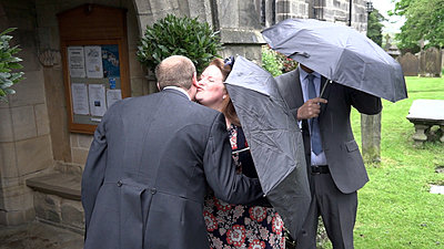

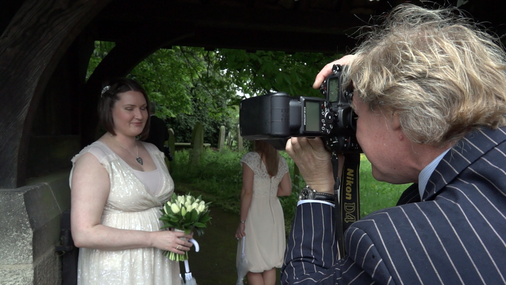

Another example from the same shoot - well exposed but as soon as the tog's hand comes out of the shade (not even into the sunlight as it was overcast) - completely blown out! It is causing me an issue i need to address!

This can be easily fixed (the blown out area) in Adobe Premiere Pro using the Shadow/highlight filter.

For purely the exposure issue I would copy the settings of PP3 into PP2 so you have two identical profiles (PP2 is for stills so I don't use it) ... Then lift the colour level on your new PP2 up two points. Finally set Knee to manual and set at 100% and leave the ramp at default. What this will do is compress any highlights in the image. You would have to try this before doing a wedding though as manual knee can be set from 75% to 105% and you have to decide where in the range suits you. If you push the knee level too much the image might look "plastic" ... which it will at 105% ... You might need to drop below 100% to avoid the artificial look so try shots at maybe 100%, 95% and 90% knee and see which looks best.
Set up a scene with something very bright white in the picture around duller objects ...maybe a white football in the garden so the camera will tend to over expose the light image and then shoot a bit on PP3 (as a reference) and then PP2 with the knee at 100, 95 and 90
