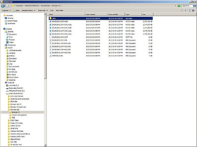

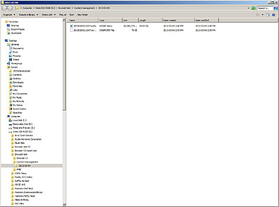

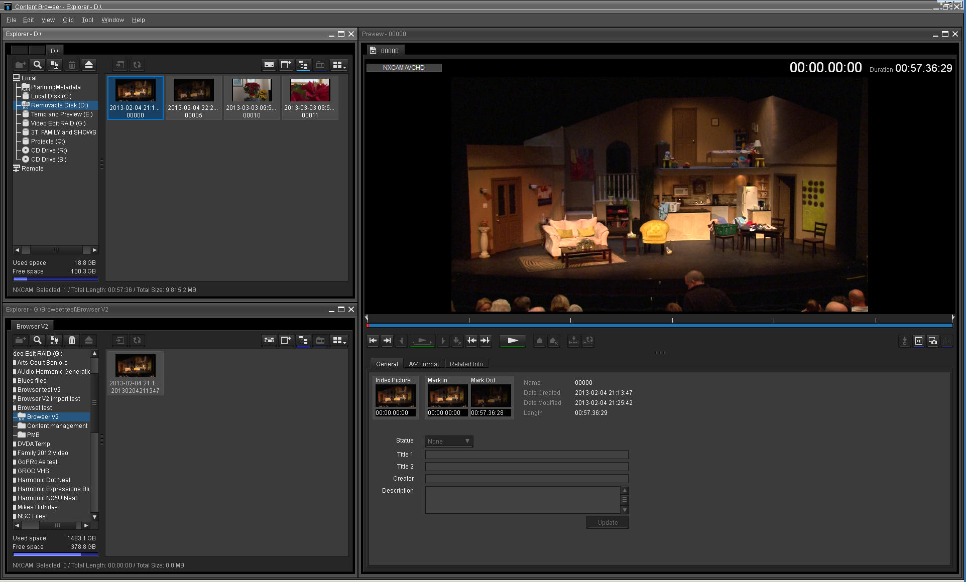

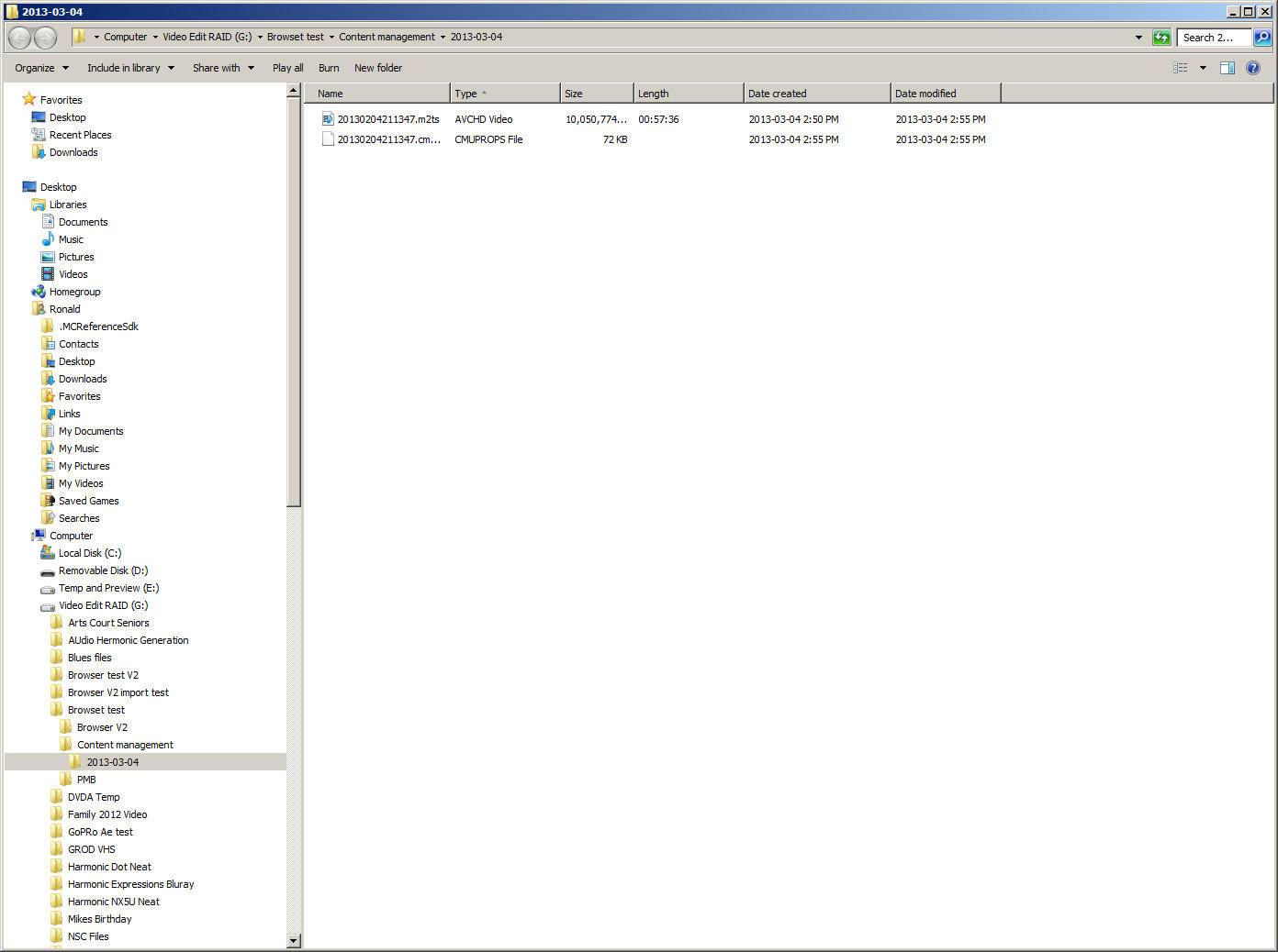

These are some images. First is of the Browser V2 showing my FMU128 connect and indicating 4 clips in the top window. I have imported the first clip into a directory shown in the bottom window. Both indicted as a single clip correctly and of 57min long ( 5 FAT 32 files). The second figure shows what is in the directory using explorer and the third fig is what is in the directory for an import from Content Management Utility. Nowhere in the Browser V2 directory is there one big file like there is in the directory for the Content Management Utility. I have sent a mail to support and will let you all know what they have to say.
Ron Evans

Chris the Content Management Utility works correctly. The Content Browser V2 does not . They are two different programs. I use the Content Management Utility version 2.1.01.11180 that works exactly like I want it to. I just tried this new Content Browser V2 ( I think you all got Content Browser version 1 or 1.1 with the EA50 ?) That is what I have shown in the fig in my previous post. Fig 1 and 2 are the content Browser and the associated registered folder and fig 3 is the registered folder for Content Management Utility that works correctly.
