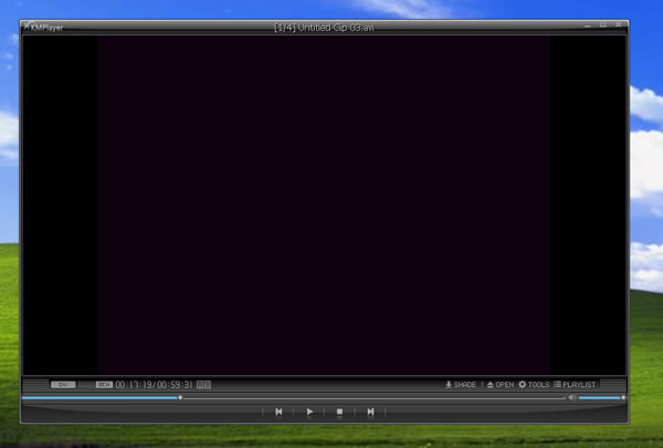

Adam here is a picture off the footage loaded up in KM player and not resized. you can see the pixelation and it this 4:3?
Now it seems when i screen capture the video wont show up on the km player for illustration purposes. Well but looking at the photo you canget the idea that it looks like 4:3?

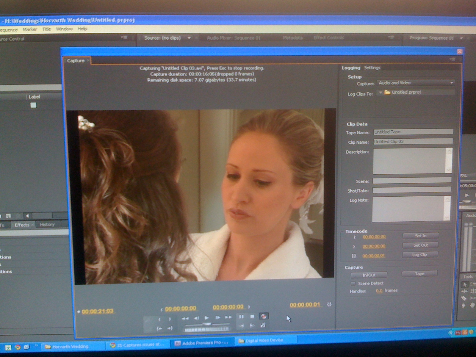

ok here is a better look at the capture screen... to me it looks like 4:3. Even when I down convert my footage to DV from HDV its still looke like 4:3...
My project is PAL DV 25 fps 16:9. Once the DV footage is captured it looks pretty ordinary when viewing through my player!!!
any hints on what to do?

Yeah, it looks like 4:3 to me too, but from that angle and without having your tapes in my hands, I can't really tell. Looks like you're using Premiere, so just select a clip in the Project Panel and look up; it'll say what the pixel dimensions and Pixel Aspect Ratio are.
Of course it looks bad on a PC screen; PC screens aren't meant to display interlaced footage. The horizontal lines are interlacing and your PC Monitor can't display this properly. Look at it on an HDTV.
Both DV and HDV are about 13 Gigs per hour.

I just hooked it up to my HD TV... the footage isnt to bad pretty good actually. I changed my video out settings to squeeze, edge crop, and letterbox..... all looked pretty good. Letterbox did have a little flickering at the top and bottom where it meets the letterbox.
So if my camera can video out to my HDTV then how do i capture the 16:9. Yes i am using premiere pro cs4.
hmmmm
maybe a test burn to dvd to check the footage might be needed.....

I would just capture normally with no downconverting. Set up a DV 16:9 project and import the HDV stuff into it and use the "Interpret Footage" (not sure about this, might work) or just scale the HDV stuff to fit.
