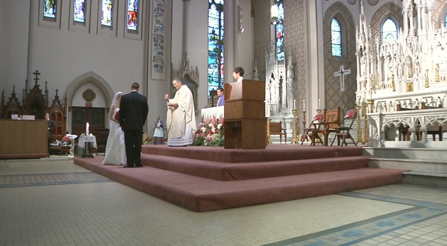

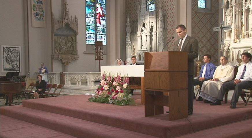

Here are a couple of screen grabs taken from Vegas preview window. The most telling thing is to look at the tile in front of the altar, huge difference.
The FX1000 tends to have a more washed out look and weaker black, though these images don't show that well because of the subject matter. I loved the sharper contrast and truer black of the Panasonic. This is the last project I have with Panasonic footage. While it looked great, I wasn't willing to jump through the hoops necessary to deal with it.
In the below instances both images looked fine, but the FX1000 has more of an artificial warmth to it, which I have gotten used to now.

Jeff, just out of curiosity, have you messed with the picture profiles on the camera? There are a lot of different looks you can come up with.
Rob Morse is offline   Reply With Quote
Old November 9th, 2009, 08:42 PM   #6
Location: Cincinnati, OH
Posts: 8,425
Actually Rob I haven't messed with the picture profiles. I have limited the auto gain which has resulted in better images in low light though.

I find these profile settings will give you the best look:
gamma/color cinematone 2
Black Compress
color depth +3
wb shift 1-2
for low light you can use cinematone 1. I find the noise is acceptable up to 6db of gain with these settings.
