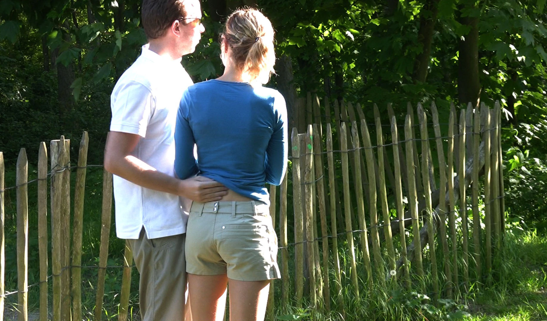

Jeff, on the HV30 framegrab posted, is the focus a little off or is that as good as it gets for the camera. Based on those framegrabs alone, the FX1000 image appears to be superior to the other two's.

Indeed, normally, the HV30 delivers a sharper image (see screengrab below). The biggest difference between the HV30 and the Z5 (or Z7, for that matter) is the washing out of bright objects, like the white shirt here. The dynamic range is not near as good as in the more expensive 3-chip camera's.
