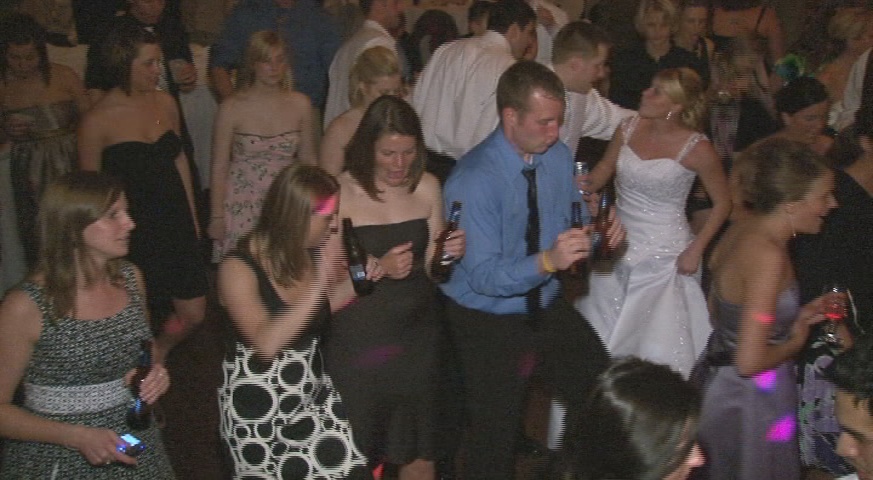

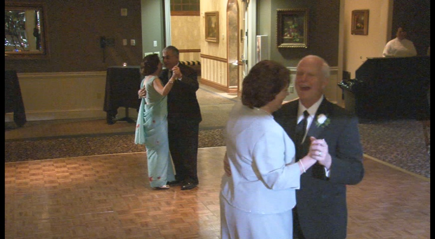

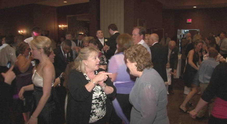

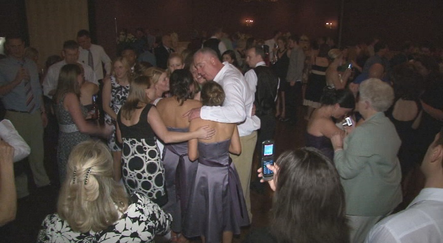

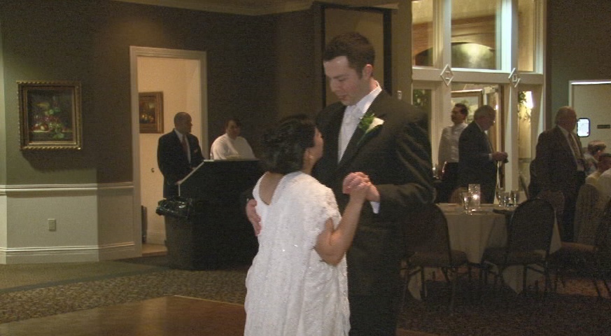

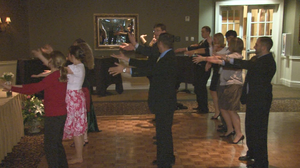

These images are from an april wedding shot in HD right off of the timeline. BTW, my exposure was not set correctly for the outdoor portion, and I am aware of that. I was in auto, but should have been running at ae-6 or so. Even if I had turned on the Zebra I could have set things to be more pleasing and not so overexposed. I was running two cameras by myself though so it was a bit hectic.

Jeff, I'm really surprised by the amount of noise and softness in some of those shots. I'll ask a really dumb question and don't be insulted by it. Are you sure you had the ND filter off? I ask that because with the Z5, there have been a couple of times I left it in the #1 postiion as opposed to off. It's not that hard to make that mistake.
But I don't think my HD footage has ever looked that 'mushy'.
Ken Ross is offline   Reply With Quote

No Ken, no insult taken, you ask a legitimate question, and remember I had two cameras running and both were the same result. I'm sure ND filters were off, but that is a good question. It was very dark in there.
Now those posts are really not meant to disparage the camera, that's just what I've been getting in dark rooms. But you see here in Cincinnati when I say dark I'm talking DARK. Even at these cheap weddings when they have no light show of any kind the house always wants to turn the lights way down low or off completely.
Now keep in mind there were virtually NO lights in the vicinity of the dance floor, and our cameras had tiny 40 watt lights and we were really far from the dancers.
NO camera would have produced great results under these cirucumstances. Let me dig up some footage from another reception where we were closer to the action, and you'll see a vast improvement.

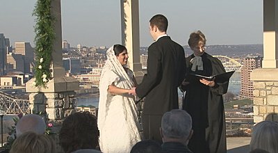

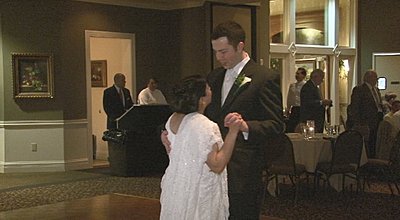

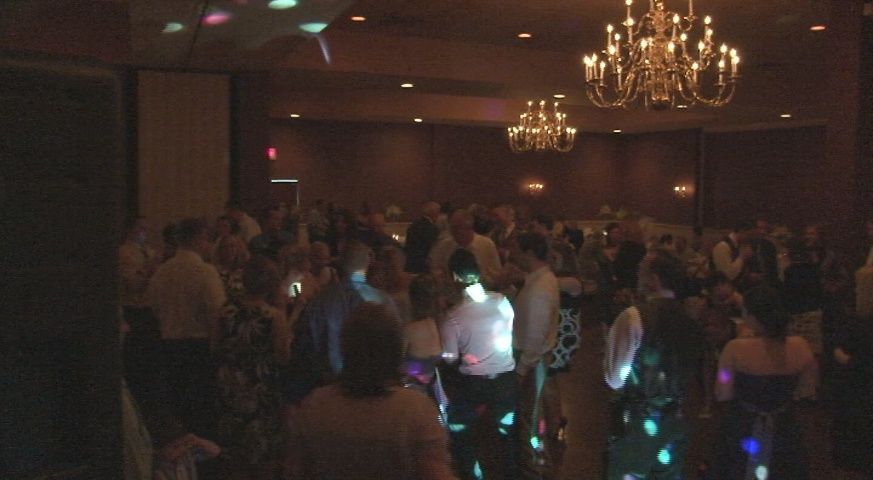

First scene no light
Second scene, about the same shot with light just turned on.
3 and 4 misc shots with lights
Is that a problem with FX1000?-image1.jpg   Is that a problem with FX1000?-image2.jpg
Is that a problem with FX1000?-image3.jpg   Is that a problem with FX1000?-image4.jpg

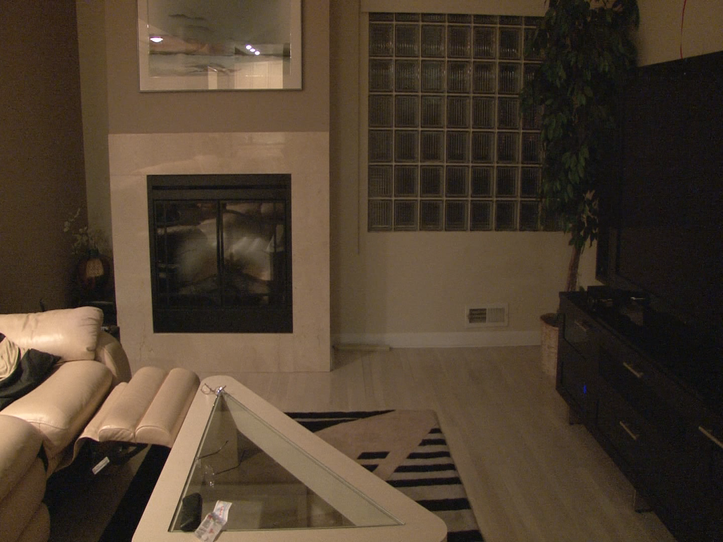

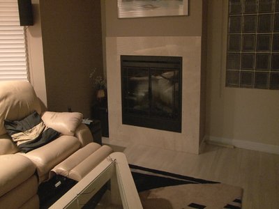

I just shot these in the house. Two high hats off to the left and dimmed. Gain ran between 15db & 18db. I usually limit it to 12-15db.
One thing I should add, the grain on a still grab usually looks worse than the moving video from which it came.

your room is pretty light in color.. the grain will really show against dark areas.

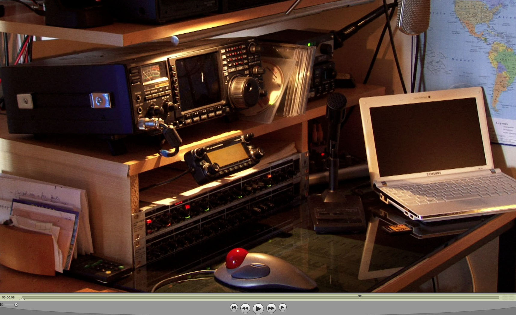

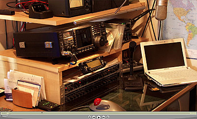

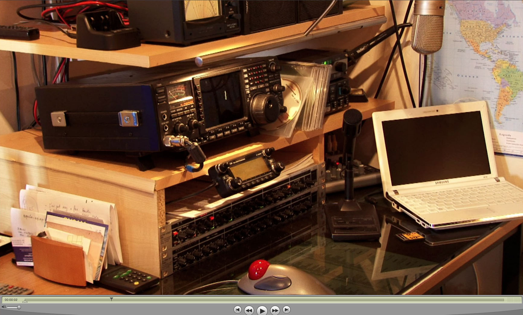

I do not get as much noise with my Z5 as in the wedding examples shown here. I quickly made a few shots in my radio shack. Number one is 6 db gain and a very poorly lit scene, number two is 0 db gain with more light. I find the noise very acceptable.
