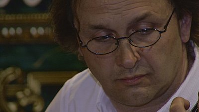

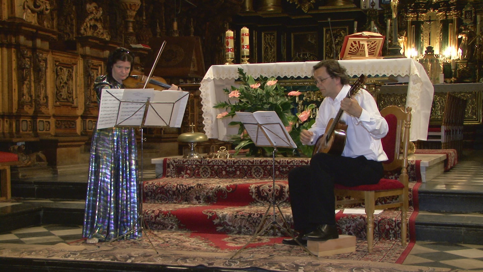

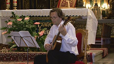

Last night I shoot a live music performance in a church. Just two musicians (violin and guitar), only natural light; the distance from camera 10-15m, Sony LED on-camera lamp (almost unnoticeable effect with this distance). I admit I wasn't sure whether the results would be satisfactory. I compressed blacks and cranked up colour gain to 3. Using histogram, I very reluctantly increased gain to 9 dB (I knew there would be no noise at 6, but the histogram showed 6 was not enough). I shot progressive, at 1/25th.
To my very nice surprise, it came out gorgeous! No distracting noise, reach colours. Great sound from the Edirol C-50 stereo shotgun. The only problem I had from time to time when changing object was the focus - it was so dark the autofocus took a while, and focusing manually on a face in shadow can also be difficult. But all in all, the experience made me stop worring about in-church shooting in the future!

Great images Piotr. Thanks for sharing them with us. On the focus issue have you tried using the Viewfinder Peaking function? I set mine to red, although it does become less effective as available light decreases and focal length increases. The guitarist's glasses would be an effective target for peaking.

Yes Lee, I always use the peaking function - and you're right about the glasses. There was a lot of edges brighter than the musicians' faces directly behind them, which didn't help, though.
Anyway, I''m quite satisified with the low-light capabilities of my V1E - I am going to use the parameters used last night as a preset for future similar situations. No cinegamma that I use a lot in bright conditions, but compressing blacks and adding a little colour gain is the key to increase contrast and mask those shadowy places where noise would strike first.

I could be wrong here, it's kind of hard to judge but it looks like the camera is focussed on the alter rather than the performers. The printing on the music looks out of focus.
Apart from that the camera has held up very well. I think crushing the blacks a bit helps in several ways.

You might be right with the focus thing Bob. This is a grab from the very beginning of the shooting, before I realized I need to focus permanently and stay at manual...Later on, the focus is perfect.
Still learning!
PS. A note on crushing the blacks vs using cinegamma: the results are similar in that overall picture "Colour contrast" is enhanced. However, cinegamma1 (not to mention cinegamma2) tends to steal a lot of light from the picture (like 1-2 stops), so it's no good in already dark environment. Compressing blacks, while leaving highlights and midtones unchanged, only deepens the shadows - thus improving the contrast and preventing noise to some extent... Just my theory, but it worked well in the church!

Crushing the blacks by adjusting master pedestal is different to changing gamma, the former puts a flat section at the bottom of the gamma curve but leaves the rest the same except for maybe a change in slope. Cinegamma would be changing the curve, it'll still tend to push the blacks down but as you noticed alters everything else as well.
And yes I think you're right, crunching the bottom end to get rid of as much noise as possible before the encoder has to cope with it is a good move.

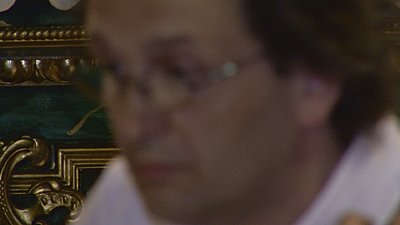

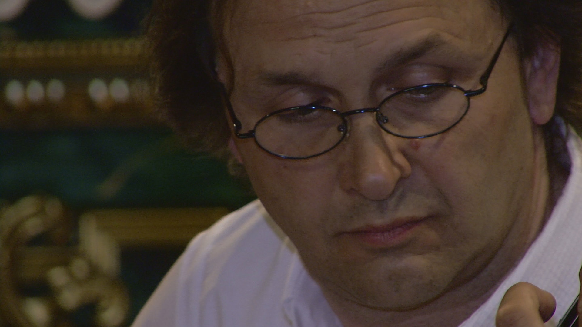

Thanks Greg for your encouraging comment. Just to illustrate how "dangerous" it can be to leave the focus on auto (or even use PAF when on manual, as I did here) when the main subject is not outstandingly bright, I'm posting two grabs: on the left one, you can see how the camera preferred the golden frames in the background, over the performer's face (dark because of closing the iris with increased focus); the right one shows the result of my manual adjustment, using the peaking on his glasses...
Speaking of peaking, a word of warning to the V1/FX7 users: depending on the scene brightness and the quality of detail you want to focus on, always use the right peaking level; set it to HIGH and everything seems to be in focus; set it to LOW and you will not be able to get a dim edge peak at all (jut two extreme examples).
