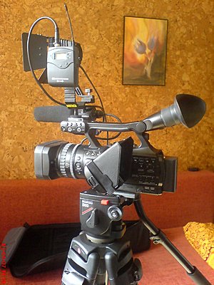

With the HVL-LBP heavy lamp with 970 battery on the coldshoe, and the HVR-DR60 disk on the rear bracket, I'm lacking a place for my Sennheiser receiver; where do you think it could be put (velcro'ed?) on the V1?
Another solution would be a "shoe doubler" bracket; I have one but it'd raise the gravity center and not be stable enough with the lamp and/or disk (see attachment; shown with just a lighweight halogen lamp)...
Yet another solution can be the J-Rode with double shoes (one for a mic shock mount, the other for the wireless receiver). I actually bought one from Jeff, but unfortunately the Azden shock mount that came with it is too long for either of my short-gun microphones (the V1's own or the Edirol). Does anyone know what is the rubbers distance in the Rode SM-3/4 shock mounts? I'd appreciate giving me this info indeed. TIA!
