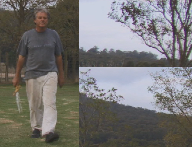

I have created a 1080i25 project with 25p footage from my V1 in Premiere Pro.
I output the file as a 1080i25 AVI without selecting the 'de-interlace' option.
For the first time I can view the footage on my new High Definition monitor, and I can now see interlaced lines in this apparent 25p footage.
I've attached some screenshots. They're not re-sized, I've just cropped the edges. What you see here is the exact pixels from my footage with clear interlaced lines. If you look closely at the edges they are obvious.
Can someoene tell me what I've done wrong in the workflow?
I record 25p, I capture into a 25i project and create a 25i AVI, right? This is what I have been told repeatedly to do. Because the 25p footage is imbedded in an interlaced stream, right?
Do I need to de-interlace afterall?

John,
1. The 25PsF from the V1 is embedded within a 1080/50i stream, with 2 fields per each frame, but without any temporal difference between them (while interlaced video also has 2 fields, but taken 1/50 sec aprat).
2. With Premiere, you can use the 1080/25 (50i) template (not 25i), but when exporting, you need to choose field order "none" (progressive). However, you do not switch deintelacing on.
3. Why would you want an uncompressed HD avi, anyway? It's best to use MPG-2!
Hope this helps.
PS. I can't see any screenshots attached:)

MPG-2?
Really? Gees, I'm behind with my knowedge. How can MPEG be better than uncompressed? What are the optimal settings for that?
I've added the screenshots but you were right with your solution. The lines are gone. However, the file is almost 100Mb smaller than the original and I reckon that I can see a quality degradation in all the footage. Is that possible or am I imagining it?

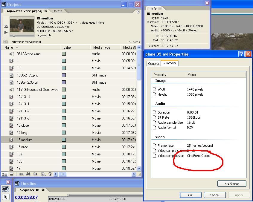

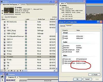

John, are you 100% sure you're capturing HDV? Can you check it in the properties after importing a captured clip into the timeline?
If it is HD avi indeed, and you're capturing without any "special treatment" (like Cineform intermadiates) - than it beats me.
Old April 22nd, 2007, 05:25 AM   #15
Location: Melbourne, AUSTRALIA
Posts: 735
I've attached a screenshot from Premiere and also the properties window from a right click in Windows Explorer that show it is HDV.
That said, it also lists the compression codec as Cineform, though I am under the impression PPro 1.5.1 uses Cineform natively, I certainly don't have anything like Aspect HD installed.
