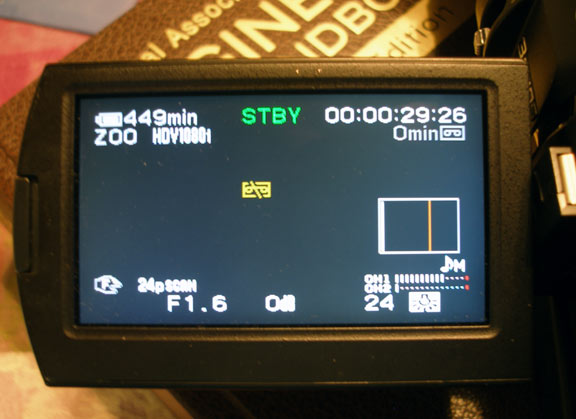

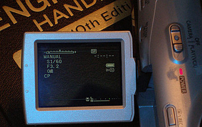

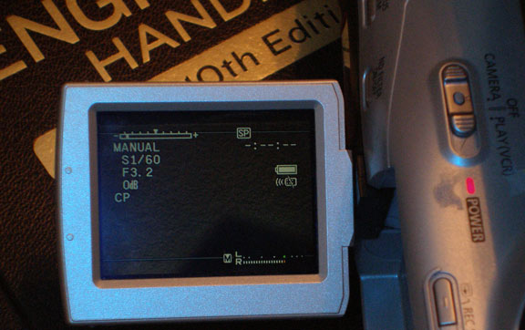

All three images here are being fed a 700Hz tone from a Shure A15TG tone generator. The A15TG is a fixed level output, fixed frequency output.
Which camcorder is set to -20dB? Which one is set to -12dB? Which cam is DV and which is HDV? Or are any of them at a reference level? Should the HDV meters change when recording DV/DVCAM?
There are several informative discussions on this subject in the "Now Hear This" forum here on DVInfo.net. I'd like to invite you to join in over there.
