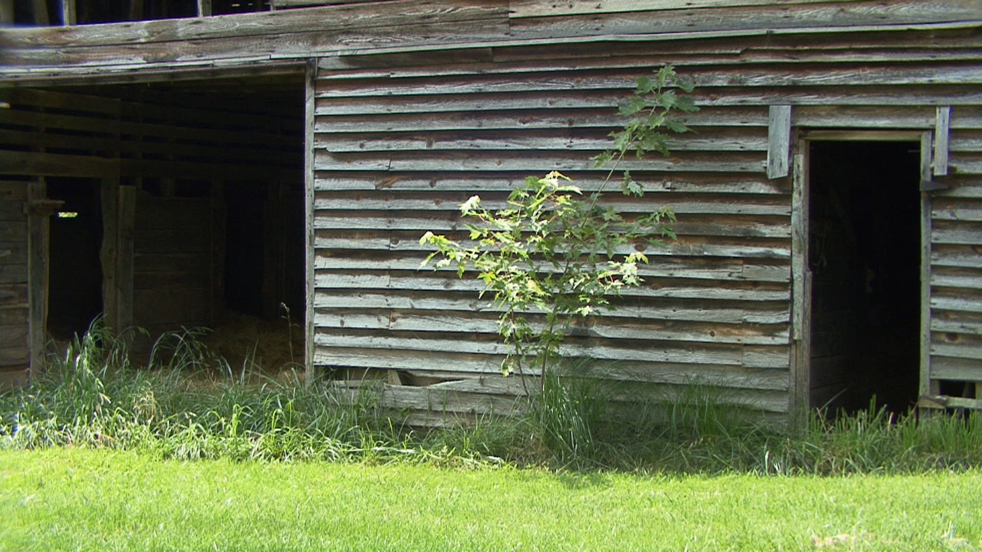

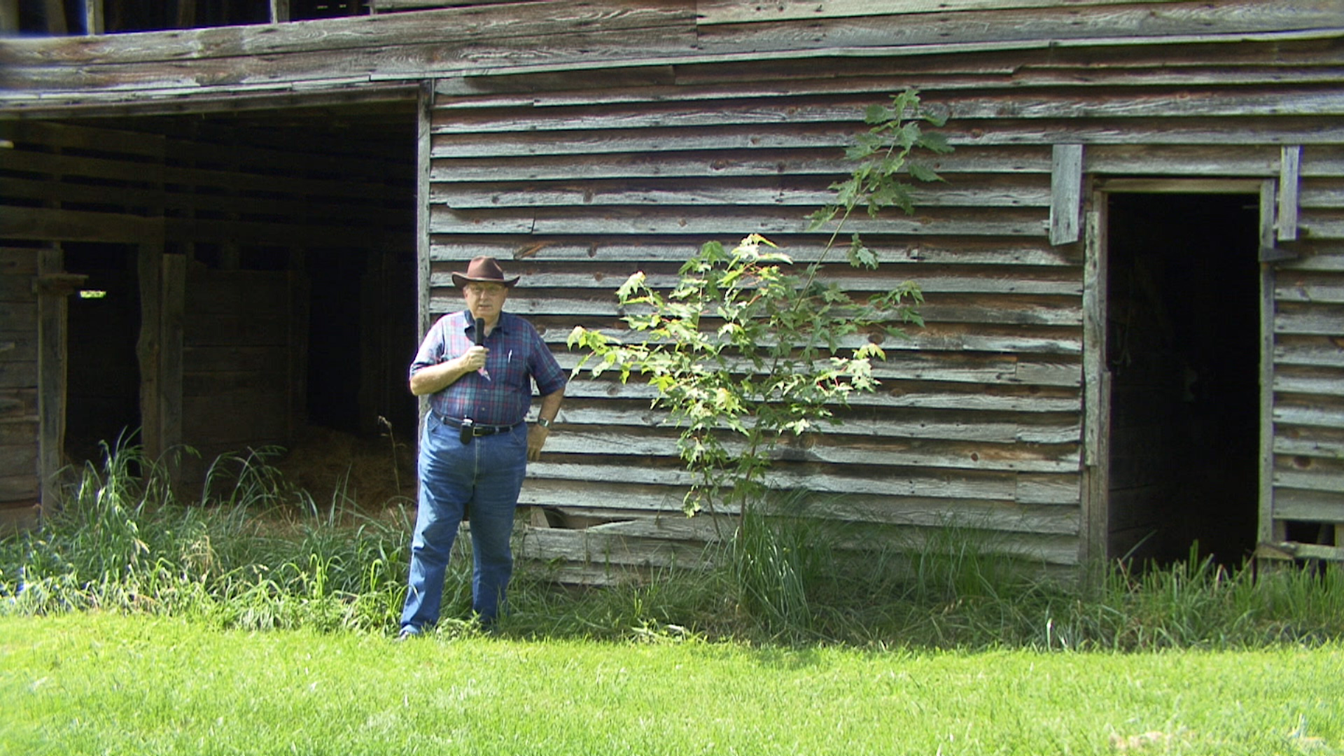

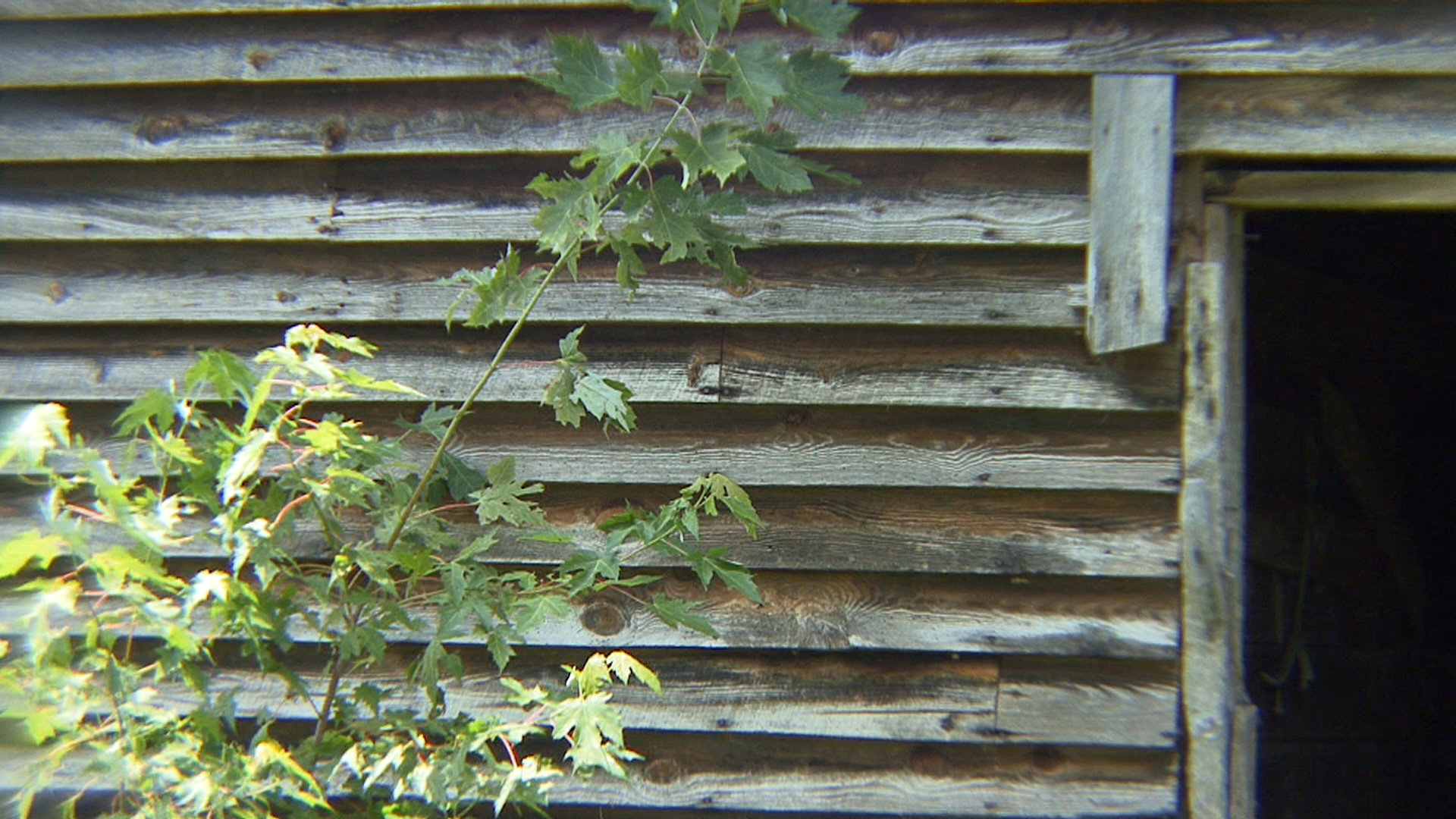

Piotr, here are three stills... most frames in this test are perfectly acceptable... the third one (extreme telephoto) has some problems... I not sure at this point whether it was me or the lens... the cam was on autofocus which might have affected this.
In general, still very happy with performance.

But that last close-up of the barn still.. shows significant softening and smearing at the edges. The center is fine, but the edges, particulalrly top right and bottom-left are really quite smeared.
- Look at the leaves of the green plant at bottom-left (on the enlarged 3rd pic). :-/
Also some chromatic aberration visible on the vertical plank on bottom right.
I'd really like to see 3 or 4 of these 0.65 to 0.8 WA lenses for the V1 compared on sam cam, fixed-tripod, same subject. I am starting to think that for all it's "mildness", the Sony VCL-HG0862K might perhaps be the best solution. It gives 29.9mm widest on V1, and everyone just needs to work out if that's wide enough for them. I think, for my purposes, it would be wide enough to be honest.

Stu, yes I agree with your assessment but it only seems to occur at full out telephoto ... in other words, I find the Raynox usable over most of the zoom range... just have to remember don't go out all the way. ;-)

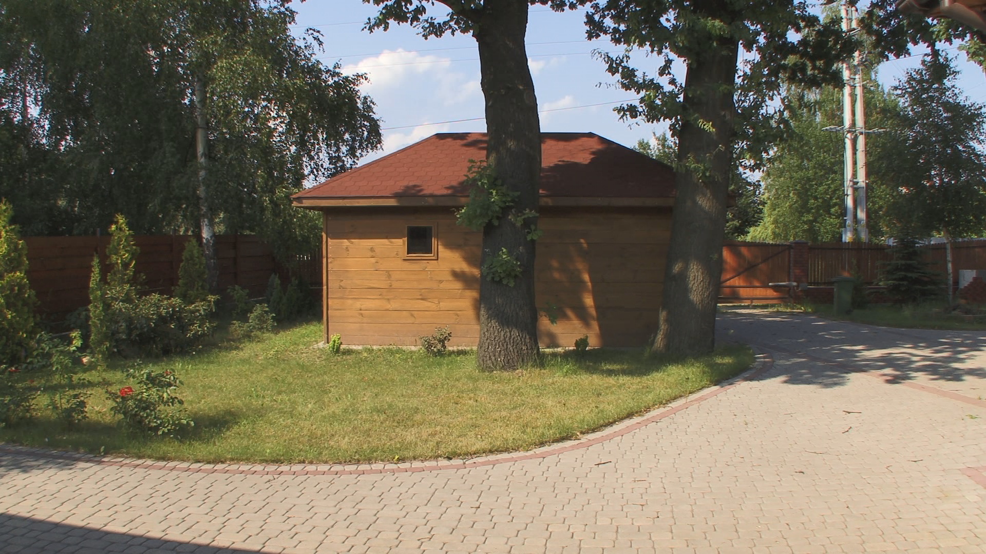

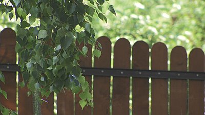

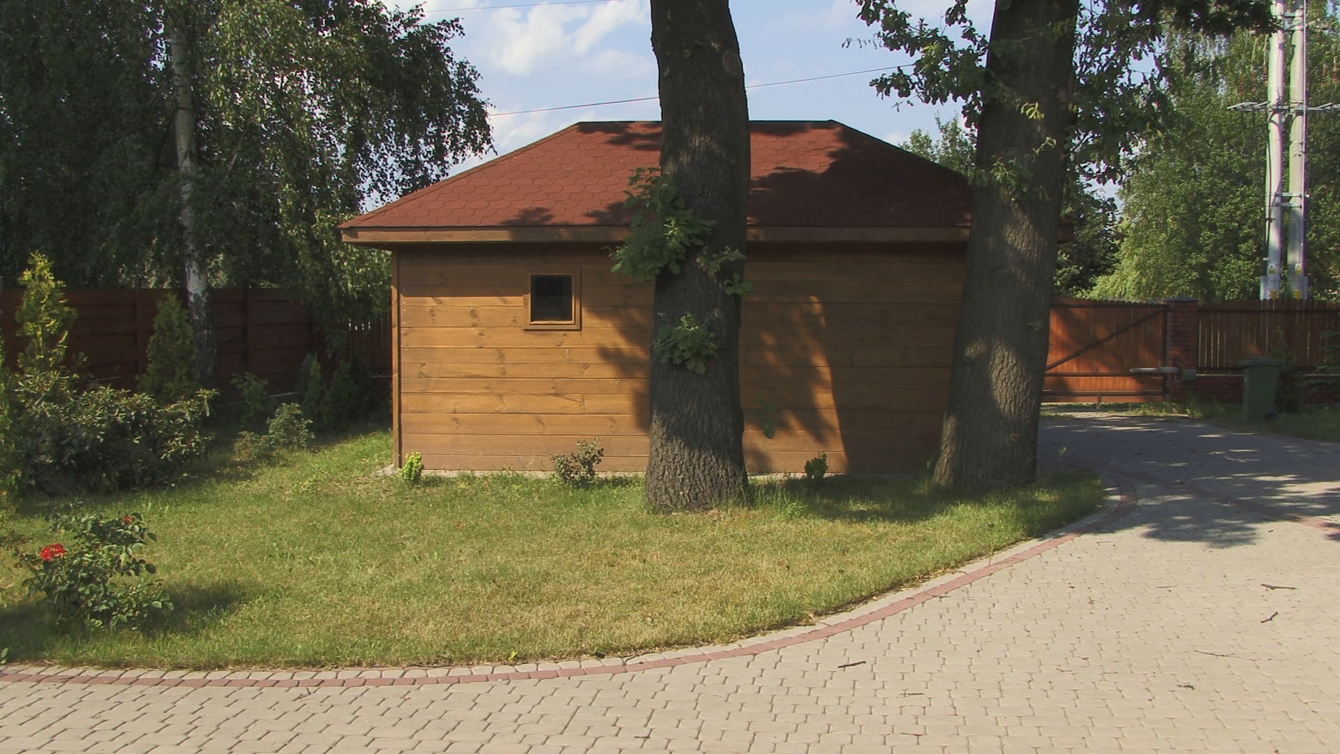

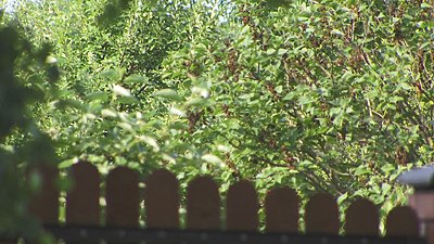

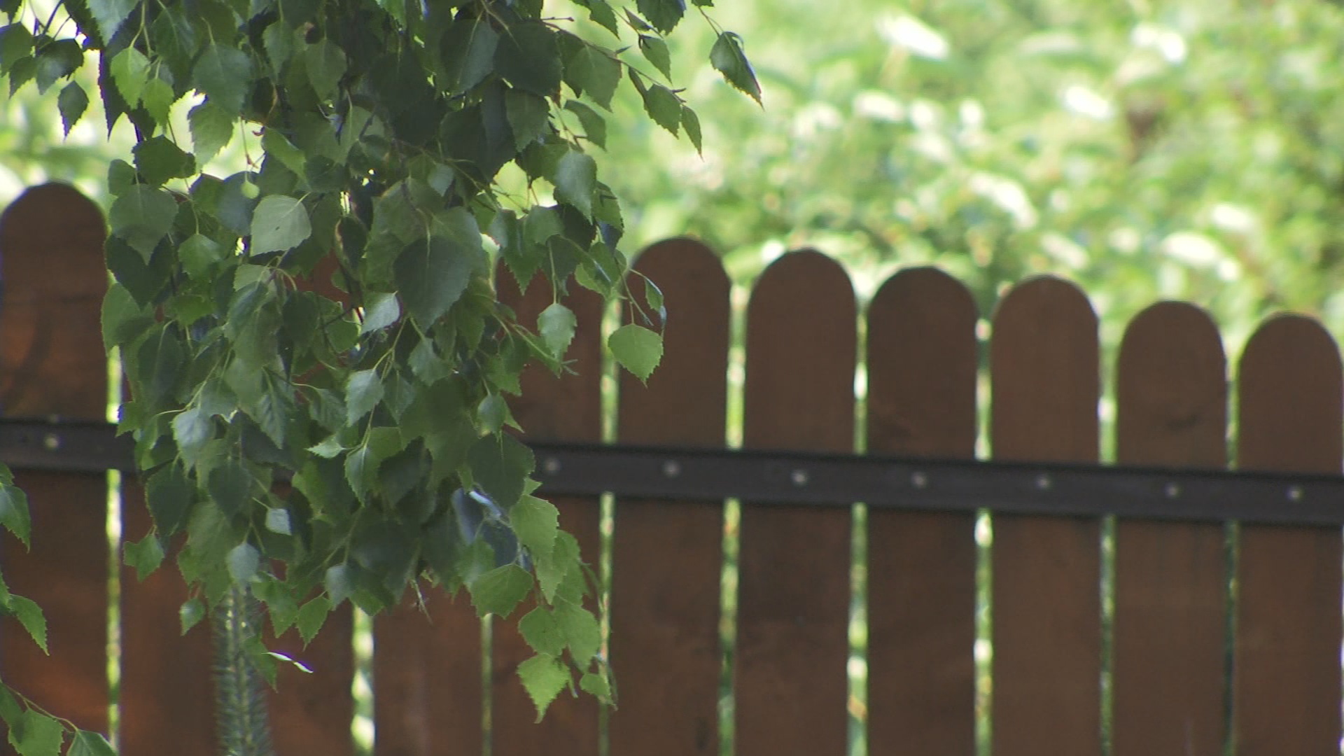

OK, so here are 4 grabs from my V1E: the first is widest without any adapter, the second - widest with the Sony's own 'K' 0.8x, and the bottom two - fully zoomed with the Sony wa. The latter might not be focussed properly, but some of the leaves are sharp here and there around the whole picture area, without fringing - so there is no degradation. Like I said, the Sony VCL-HG0862K might no be wide enough sometimes, but at least it's not spoiling the picture. On close-ups like this, the Century 0.65x I tested couldn't produce really sharp pictures even in the frame centre, and the leaves' edges against the sky were outlined with ugly magenta halo.

Thanks for posting those shots Piotr.
They are very useful to see.
My pleasure Stu. The VCL-HG0862K is really mild, but sufficient for most situations.
