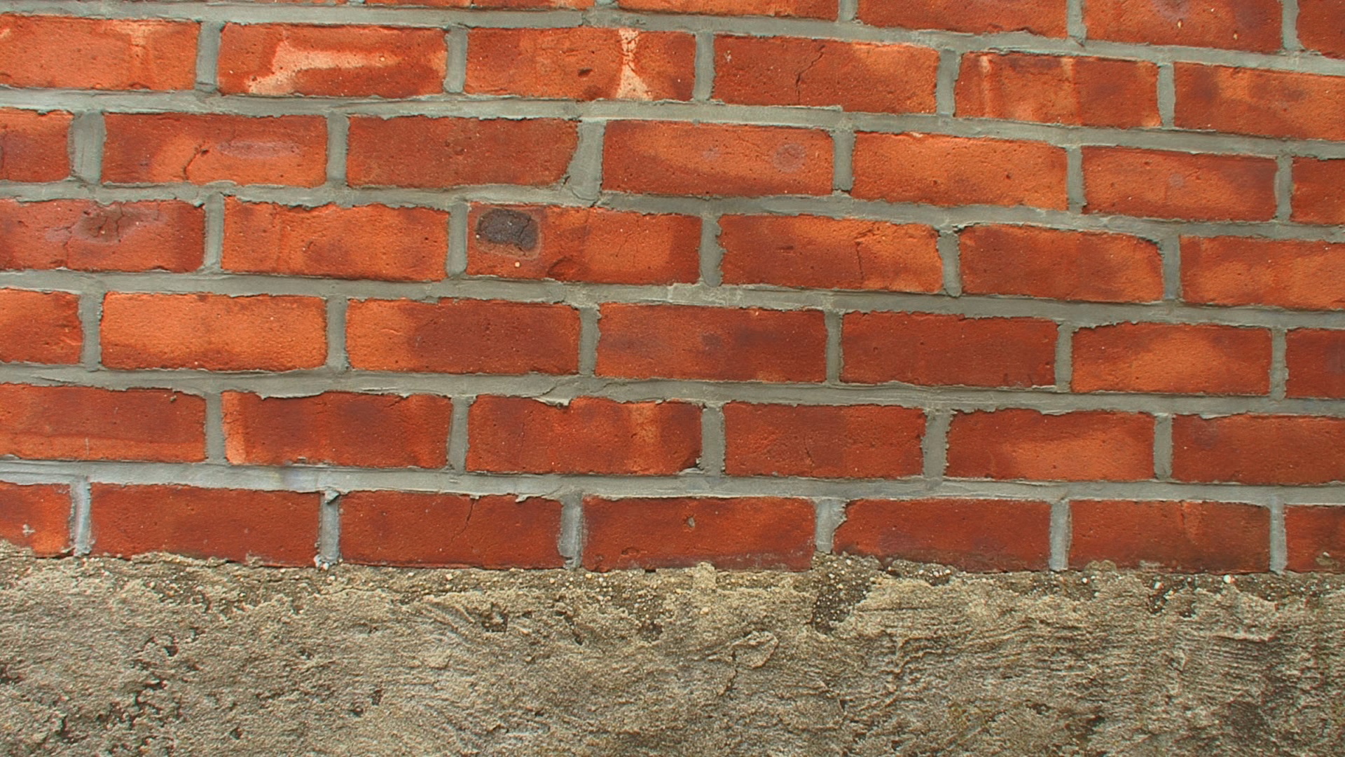

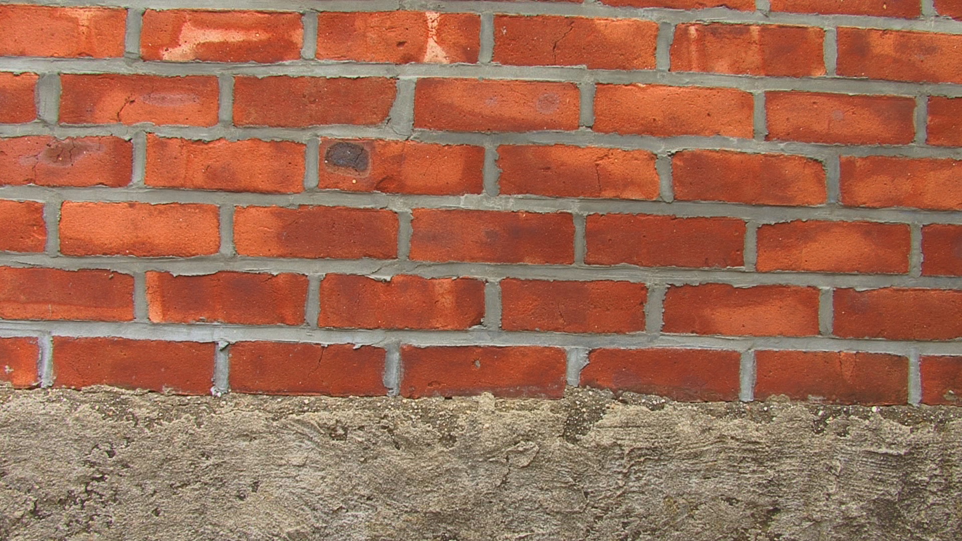

I took Tom's advice and used a brick wall for testing.

Raynox or Redeye, Ron? I'm guessing Raynox, but leaving us to guess doesn't help much.

Uh, I guess you didn't notice the file names.
"Standard.jpg" is just the camcorder lens.
"raynox.jpg" is with the raynox lens attached.

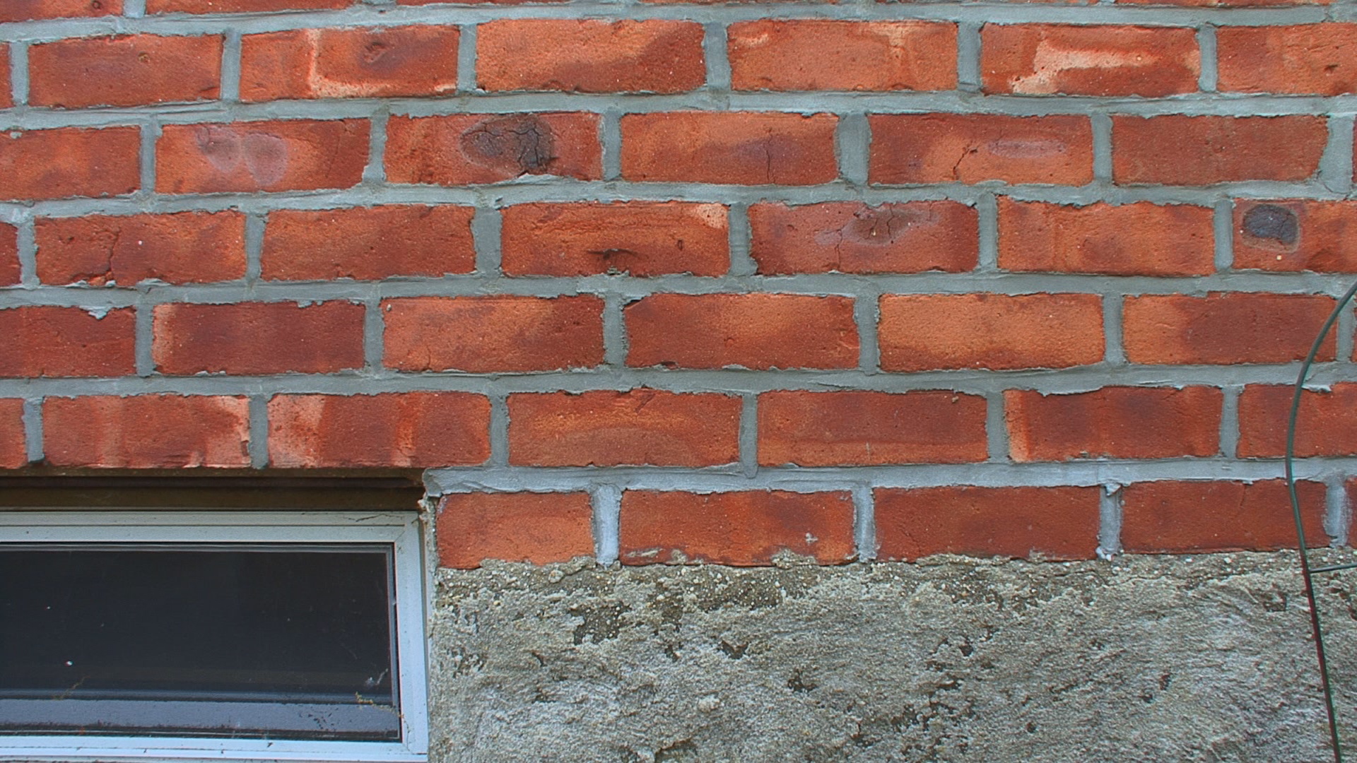

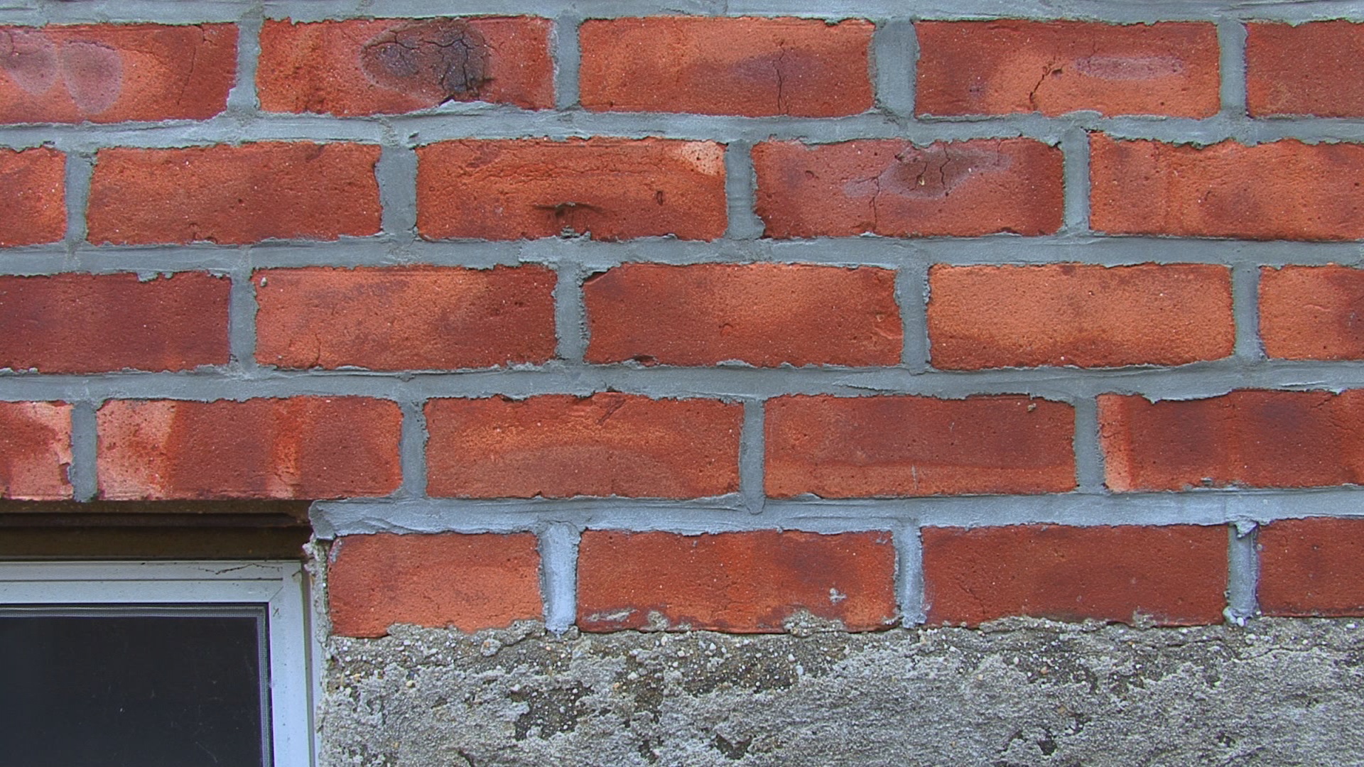

Did another brick test.
Raynox vs standard lens. But with the standard lens on, I positioned the camcorder further back to match the area covered.
I think this is a better test to compare resolution and I am now even more impressed with my $150 Raynox.

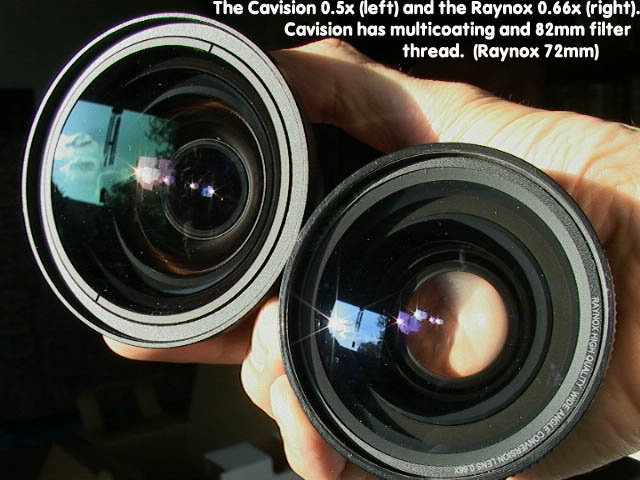

I agree - you certainly have hit on a good combination there and when viewed big the Raynox looks sharp right into the corners. Do you know what aperture this was taken at? The 6600PRO I had seemed to have a single layer coating (a light blue) with nowhere near the 'depth' of the multicoating on competitor's lenses, so I was careful to hood it as best I could. But for a lens at this price with so little distortion that still left you with 60% of your zoom useable it is indeed a bargain.
My slight quibble is that I was never quite sure where this 60% point was, and because of it I never zoomed more than a few mill away from max wide. With my single element aspheric on the other hand the change from sharp to wildly blurry is distinct and very obvious indeed, so I'm much happier to use any focal length in that 60% range, knowing it's sharp.
tom.
