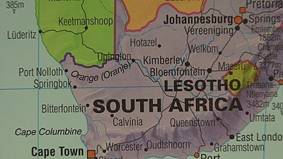

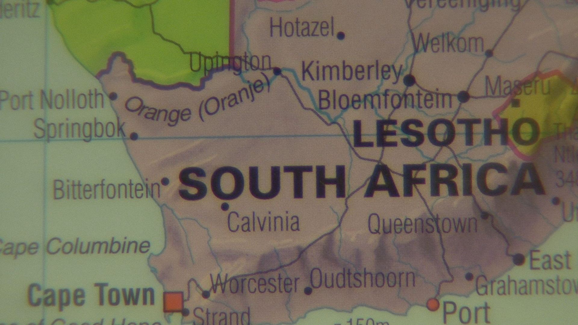

1st impressions.
My only experience with W/A lenses is on my old SD TRV900.
Well got my Raynox 7062 lens last night. Only had time to do a non moving fixed image indoor test. My 1st impressions are minimal barrel distortions, but a very noticeable drop in resolution. Image with camcorder looked tack sharp. With the Raynox attached, everything looked like it had a slight haze. The lens did have full zoom through, with an increase in haze with more zoom, especially around the edges.
I did the test 2x. Once 10" away and once 20" away. I think this was a tough test as most of the time I will not be that close to the subject and the detail/resolution loss will not be as noticeable. I think a moving image will also help hide the lens weakneses. I'll have to do some more testing closer to how I actually intend to use the lens to see if I will buy the much more expensive Century Optics.
The resolution drop was noticed on a Sony Bravia 26" HDTV. Camcorder lcd and viewfinder could not see the res drop.

...With the Raynox attached, everything looked like it had a slight haze. The lens did have full zoom through, with an increase in haze with more zoom, especially around the edges...
Did some benchmarking last night. I don't have a large HD display, and didn't see a general haze/reduced resolution on small (17") display. On a smaller display it is very evident that when you zoom in, certain highlight areas will develop a distinct, and objectionable glow/haze around them. Seems to occur when a highlight is over a dark background, and is masked (or maybe isn't there) when a highlight is over medium to light tones. I was zoomed in pretty far.
With SD wide angle adaptors I often left them on the lens for general shooting. I don't think I'll be doing that with the 7062, only putting it on when I need the WA. Given that my immediate use will be for SD DVD, I'm going to keep on using the 7062.

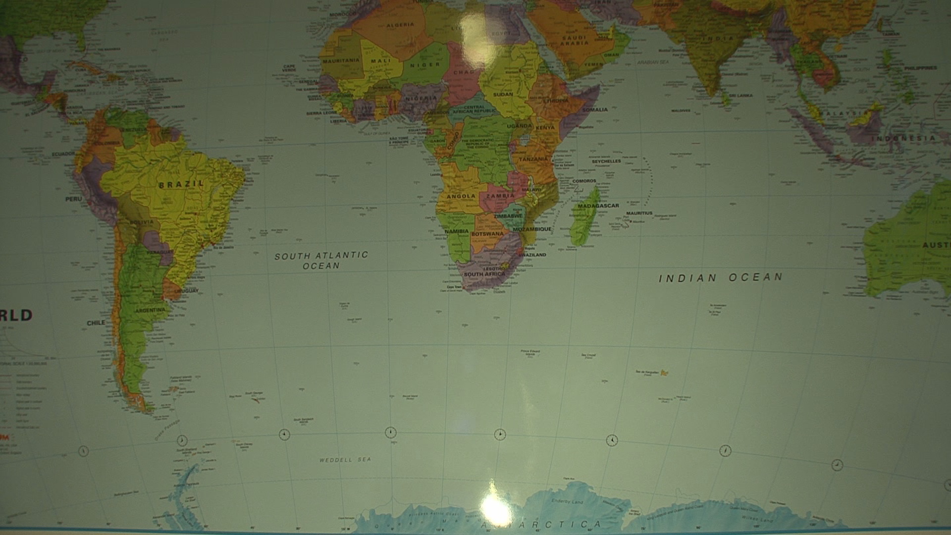

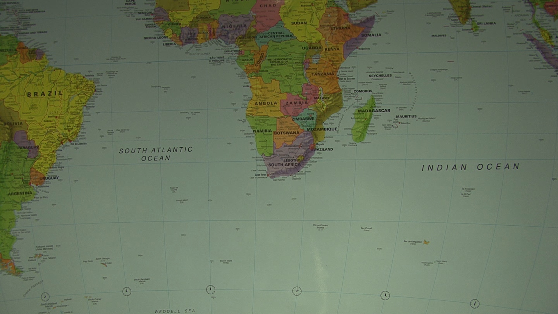

Here is link to a raw clip shot with the Raynox 7062
http://www.megaupload.com/?d=KKJV4MHI
It's a big file and I know people hate megaupload, but I can't complain about free file sharing.
I've also attached some screen captures done in vegas.
For $150, I can't complain. I will do some more testing to see if I feel a need to make the $ jump to the Century. Anyone have experience with the Redeye ?

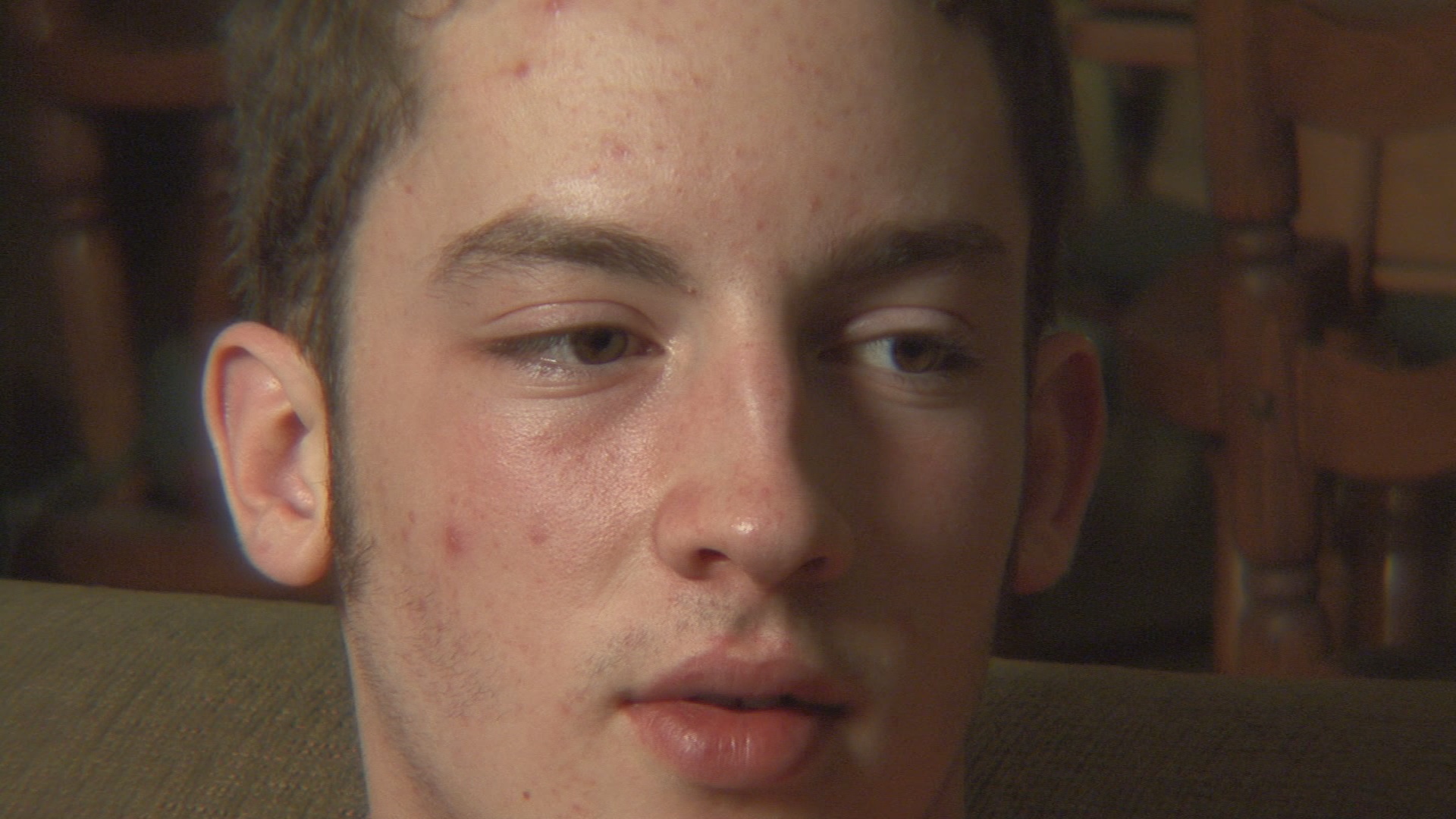

Attached is a vegas framegrab that shows the fringing around my son's right ear. Doesn't show up in other areas, just where there is a mid-to-highlight bordering a dark area.
***this is only when zoomed in***
