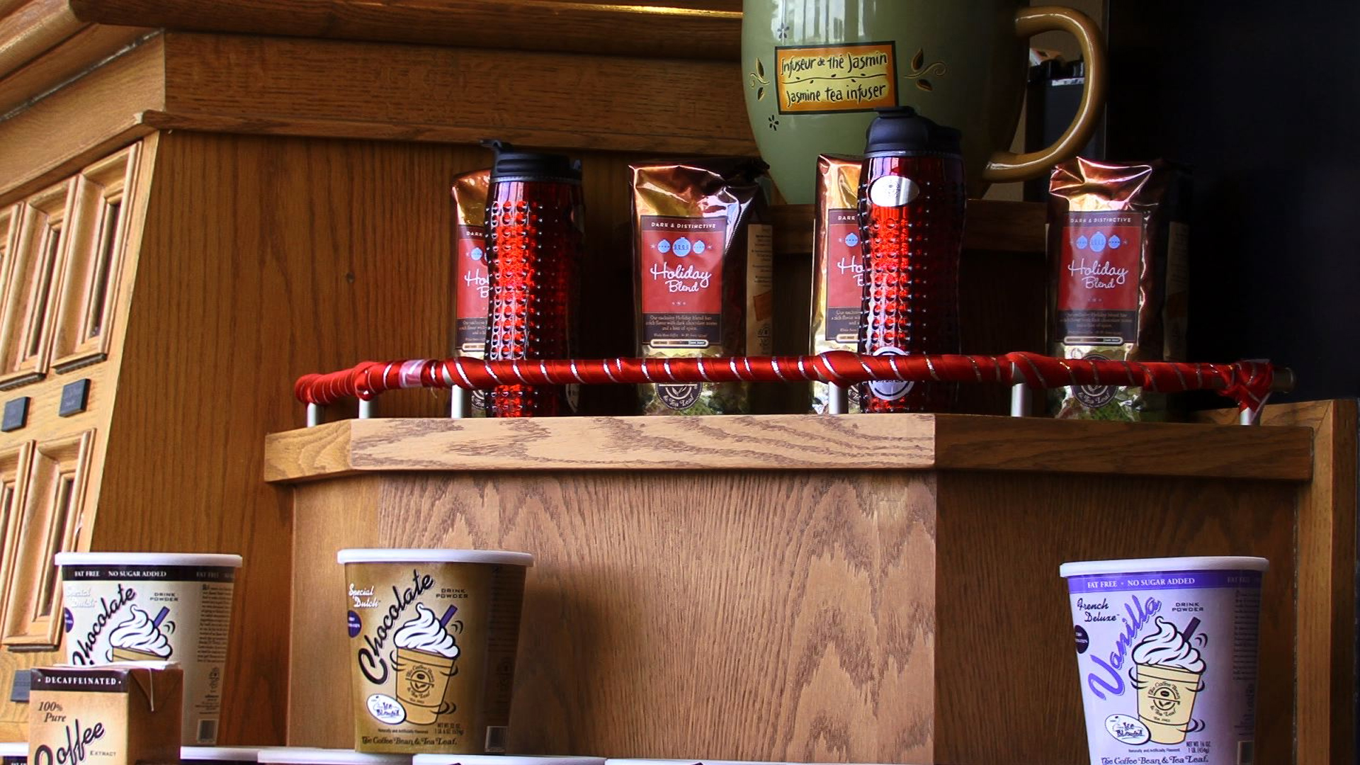

Comparison of the three clips
Hi,
I imported each clip into photoshop. I then resized each clip to 1920x1080 (this is the true format you get with HDV). I then spliced a 640x1080 image of each clip in thirds and combined them. The image I've attached is a 1920x1080, with the image 1, then image 2, then image 3. I did this to see if there was an obvious division line between the three images.
I find it difficult visually to see where the division line is (keep in mind that the three individual clips are of equal size: the first, second, and third images are all 640x1080 to combine the 1920x1080 image).
I did notice that the original image 1 is brighter than the other two, and that image 3 is slightly brighter than image 2. Also, if you look at the pitcher from the original three images, there is a change in the handle (something moved between image 1 and the other images; could be the lighting difference).
I didn't do any processing aside from resizing the image to the proper aspect ratio.

Here is the same image but with a small white line that shows where the division between the separate images are. Again, the original image 1 is the first third, the original image 2 is the second third, and the original image 3 is the last third.

The image, attachmentid=1585, is by far the best image. I think this is the image people are saying is soft. But it isn't. The other two images suffer from a bit of aliasing which gives a bit of zing to the image hence the sharper comments.
There are much more jaggies in 1586 and 1591.
I am hoping 1585 is 30P which will bode well for 25P. But it's probably 60i comparing what I am seeing in 50i.
TT
Now that YOU've had a chance to view these -- #1585 (Image 1) is 60i. At my end, this clearly has more detail on the wood grain.
The other two are progressive. They are a bit softer to my eyes. But, these could be from my capture from FCP. I'll try Vegas.
Now which is 24p and 30p?

Originally Posted by Steve Mullen
Here are three images. Is one of significantly lower quality? Which one?
These are the obvious differences I see.
Look at the left cup, the reflection behind the words "no sugar added" change between 1 and 2/3 (other reflections in other cups too).
The main difference between 2 and 3 seems to be a slightly different gamma.
Between 1 and 2/3 the details in the wood grain appear muted. However, the details in the high contrast small prints on the coffee packages or cups are similar. Therefore the high contrast resolution of the picture is not degraded in the progressive pictures versus the interlaced pictures, but the low contrast resolution appears to be degraded.
Maybe we are seeing noise reduction kicking in (progressive should halve the sensitivity over interlaced). What where the gain values for each picture?
All CMOS captures are at 60p and both I and P are passed through a 30% low-pass filter. So images "should" be identical as is sensitivity.
But, the question of the hour is can/should an NLE process the P video differently than I video?
If it should, and it's not, then work needs to be done on the NLEs. Which is why what Vegas is or is not doing needs to be fully explained. We really shouldn't have to guessing at all this.
