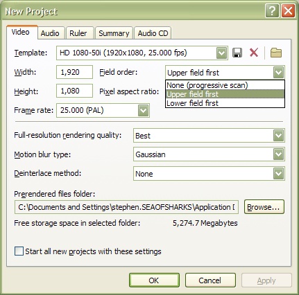

There's no preset for 25p, but all you have to do is select progressive scan in a 1080 HDV project properties. I am rather familiar with working with 25p footage in Vegas! Just because there is no preset, it doesn't mean you can't do it. Presets are only what the programmers thought you would need. There is no "None" setting for field order in Vegas. Only Upper Field, Lower Field, or Progressive.
Vegas does not need any updates for the V1. Not for 25p anyway. Unlike 24p (and this is something I really need to emphasise) 25p does NOT need any special handling other than telling Vegas that the footage is progressive. There are NO special requirements for 25p. None. Nada. Zilch. In fact you could edit it as interlaced footage and it would still render out correctly because each alternate field is part of the same frame. No pulldown or other such clumsey muck is required.

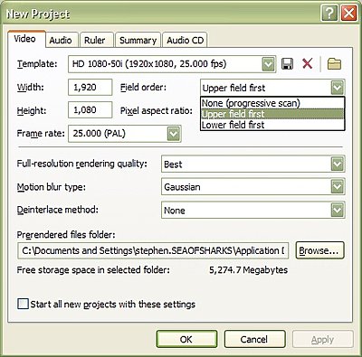

It just the wording we are both right (see attached) field order settings in Vegas 6 and 7 is "none(progressive)" or "Upper Field or Lower Field". I'm also aware you can change the presets - I do all the time. Since you have 25p version of camera, it may well be that Vegas fully supports the camera right now.

Vegas does fully support the 25p HDV format right now, very different than the 24p.
